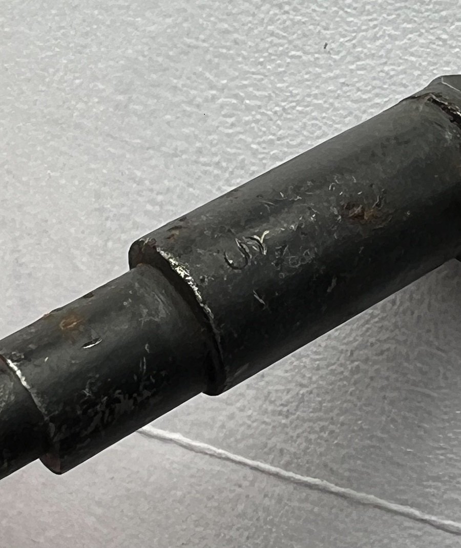

Wagner Posted June 17 Report Share Posted June 17 Hello guys. A happy turn of events brought me to your Thompson family. I will try to keep good traditions. Sincerely. I ask friends for help: found 2 different drawings in my collection. The history of their appearance is very interesting. Tell me, please its history Link to comment Share on other sites More sharing options...

TD. Posted June 17 Report Share Posted June 17 Hi Wagner, Welcome to the Thompson forum. It appears you may have both a Colt and Savage knurled rocker pivots. Using the close-up picture, the Savage rocker pivot (diamonds in) is on the right. Inspect this rocker pivot carefully for an "S" mark. What appears to be a Colt rocker pivot is on the left (diamonds out - like checkering). There should not be any letter markings on this pivot. Where did these comes from? Link to comment Share on other sites More sharing options...

Wagner Posted June 17 Author Report Share Posted June 17 46 minutes ago, TD. said: Hi Wagner, Welcome to the Thompson forum. It appears you may have both a Colt and Savage knurled rocker pivots. Using the close-up picture, the Savage rocker pivot (diamonds in) is on the right. Inspect this rocker pivot carefully for an "S" mark. What appears to be a Colt rocker pivot is on the left (diamonds out - like checkering). There should not be any letter markings on this pivot. Where did these comes from? Thanks TD . my sir, carefully examined - there is not a single letter markings .. these parts -are the remnants of lend-lease Link to comment Share on other sites More sharing options...

Wagner Posted June 26 Author Report Share Posted June 26 On 17.06.2023 at 23:18, Wagner said: Спасибо ТД. сударь,внимательно осмотрели-нет ни одной буквенной маркировки..эти детали-остатки ленд-лиза Guys, I apologize for my inattention. S found Link to comment Share on other sites More sharing options...
rpbcps Posted June 26 Report Share Posted June 26 Which rocker pivot is it on? Link to comment Share on other sites More sharing options...
