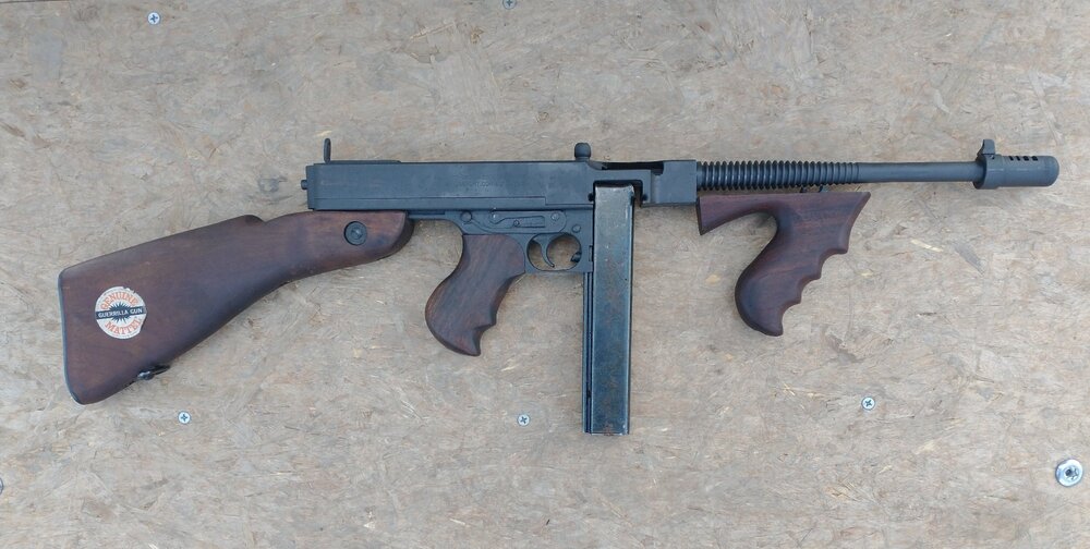

Michael Z. Williamson Posted July 4, 2023 Report Share Posted July 4, 2023 Cadmus Industries re-import. Fire damaged. They did the minimum DEWAT possible--welded breech, pinned barrel. However, all the springs were shot, and I'm going to need to replace the aftermarket barrel--it's too tight, and looks weird inside, as if it were bulged. 1 Link to comment Share on other sites More sharing options...
reconbob Posted July 5, 2023 Report Share Posted July 5, 2023 (edited) When you say “fire damaged” what does that mean? If the springs were all “shot” as a result of a fire, then the receiver must also have been damaged and could be brittle or soft either one of which could make the gun unsafe to fire. Since the gun in the picture has un-burnt wood I assume some restoration has already been done? Wood replaced? Gun reblued? What’s up with the Genuine Mattel” sticker? Is this a joke? Bob Edited July 5, 2023 by reconbob Link to comment Share on other sites More sharing options...
Michael Z. Williamson Posted July 5, 2023 Author Report Share Posted July 5, 2023 Yes, my friend put the Mattel sticker on as a joke. I intend to leave it. Cadmus parkerized everything and added new furniture in 1966, and sold it for $99.50. My friend Amnestied it in 1968, along with 13 other weapons. The receiver tests sound, just pitted. I hand polished as much as feasible without damaging markings. An SOT smith friend and I have been flogging it over. It fires, but not consistently, and the aftermarket but semi spec barrel seems to be the weak point. Link to comment Share on other sites More sharing options...
reconbob Posted July 5, 2023 Report Share Posted July 5, 2023 When you try the next barrel remove the grip mount. Now you can screw in the new barrel hand-tight and test fire and you are not committed to having to deal with the grip mount until you know the new barrel works. If the barrel is no good you just unscrew it and try the next one. If the next barrel is not G.I. make sure it has the correct Thompson chamber and not a standard .45 ACP chamber or you will have feeding problems. Bob Link to comment Share on other sites More sharing options...
TD. Posted July 5, 2023 Report Share Posted July 5, 2023 Hi Michael Z. Williamson, Welcome to the Thompson forum. Congratulations on your Cadmus Industries Thompson submachine gun. If this Thompson was acquired in 1966 as a deactivated machine gun, it was sold to your friend on an IRS Form 5. The Amnesty Registration in 1968 would be insurance this Thompson is on the National Firearms Registration and Transfer Record (NFRTR), commonly referred to as the NFA Registry. A Freedom of Information Act (FOIA) would be interesting. The barrel on this Thompson has only 24 fins with the grip mount under the 20th fin. I suspect this is a Numrich Arms commercial barrel. I am curious if the serial number prefix begins with an "S" or "A.O." and if the frame has a matching serial number. Do you have any of the original sale paperwork from Cadmus Industries? All good stuff!!! Link to comment Share on other sites More sharing options...

Michael Z. Williamson Posted July 6, 2023 Author Report Share Posted July 6, 2023 On 7/4/2023 at 11:47 PM, TD. said: Hi Michael Z. Williamson, Welcome to the Thompson forum. Congratulations on your Cadmus Industries Thompson submachine gun. If this Thompson was acquired in 1966 as a deactivated machine gun, it was sold to your friend on an IRS Form 5. The Amnesty Registration in 1968 would be insurance this Thompson is on the National Firearms Registration and Transfer Record (NFRTR), commonly referred to as the NFA Registry. A Freedom of Information Act (FOIA) would be interesting. The barrel on this Thompson has only 24 fins with the grip mount under the 20th fin. I suspect this is a Numrich Arms commercial barrel. I am curious if the serial number prefix begins with an "S" or "A.O." and if the frame has a matching serial number. Do you have any of the original sale paperwork from Cadmus Industries? All good stuff!!! I have the original amnesty registration and the invoice from Cadmus. It was sold as deactivated. He registered it. It transfered to my trust on Form 5, was Form 1ed to reactivate. SN is AO85XXX He had a massive collection of Class III and hundreds of standard firearms he loaned to the Fort Benjamin Harrison Museum until it closed in 1976. Quoting my post from another forum: Finally shipped the last NFA weapon from Gary's estate. It took two years, me, Jess managing paperwork, two firearm attorneys, the estate attorney, an SOT who handles really oddball stuff, the executor, and a very nice, very knowledgeable, very efficient Examiner at NFA Branch. It started when I was helping him sell sabers, bayonets, etc, and he said he wanted to sell some of the firearms, so I assisted with photos, a Gunbroker account, research, listing. And he said, "I also have the deactivated machine guns I loaned to the Fort Harrison Museum. In 1968 I sent papers to the ATF and they sent papers back." I twitch. "So, those are DEWATs." "?" "DEactivated WAr Trophies." "I guess." "Well, with a Form 1 and $200, those can be reactivated. They're sellable." Pulls out his pipe. "Oh, well, I've got a Maxim, a Madsen, a Hotchkiss, a DP28, an MG42, an MP44, a Lewis Gun, a Japanese Type 99, a Thompson, an MP18, a Soviet mortar..." "Holy S#!T, Gary, that's $100,000 worth of hardware!" "I only paid a few hundred." "Yeah, in 1962 when they couldn't give them away." Then he passed away, and we had to find the paperwork buried in his house. A friend, my son and I are up in the attic pulling out guns. "That's a mortar...is that a firing pin? This is a live mortar." "Holy crap, that's a complete Sturmgewehr." "Is that a Boys Rifle?" "Wait...that's not a bazooka....that's...holy crap, it's a Panzerschreck." This is in addition to Lugers, Broomhandles, Carcanos, Mausers, SMLEs, Webleys, Arisakas, a Sharps buffalo rifle, Trapdoors, more sabers, Mosin Nagants, Walthers, a Gewehr 41 and a Gewehr 43, an original 1800s musket, a percussion cape gun, an FN49, a No4 Mk1(T) sniper rifle in transit chest with matching scope, a Japanese Type 97 sniper rifle, an M1D, a Soviet Mosin sniper, pre-import markings, a P14 sniper, a Reichsrevolver, a Radom P35, a stocked Inglis, a Dutch Hembrug carbine, a Bayard .32, a Steyr M95 8mm, a No 5 Jungle Carbine ... some of them still with the museum tags and receipts. Not counting sabers, Japanese swords, bayonets, uniforms, scarce helmets, a mine detector new in box, radios, a drop tank, and all the mundane autographed SF books, comics, anime, the woodblock prints, jewelry... Then the executor, and estate attorney, had to file a bunch of paperwork that my attorney assisted with. Then the first buyer was also a firearm attorney, and knew someone at NFA branch who helped find the missing records. Then we had to fix all the Amnesty forms, including a WRONG SERIAL NUMBER and wrong IDs. Maxim 08/15 Madsen 1908 Hotchkiss 1914 with tripod DP28 MG42 (not papered, now converted to semi) StG44 Lewis Gun, in transit chest, with tools and accessories, Irish surplused after being British surplused. Japanese Type 99 LMG, being converted to take either 7.7 Jap, .308, or 7.62X39, because original mags don't exist (drop in conversion, no structural changes). 1928A1 Thompson (mine now, with new barrel, all new springs, bolt, and some other tuning) MP18A1 50mm Soviet RM38 mortar Finnish 81mm M42 Savunheiten mortar Panzerschreck Boys Rifle (.55 Boys British anti-armor rifle) His family thought he died broke. We were able to fix that, and find caring homes for some amazing, historically important hardware. The Finns literally don't have a Savunheiten in their military museum. I've been getting detailed photos and measurements with the assistance of Oleg Volk so their few photos can be upgraded with better visuals and specs. Link to comment Share on other sites More sharing options...

TD. Posted July 6, 2023 Report Share Posted July 6, 2023 Very cool. Thank you for sharing. Regarding your 1928 Thompson, the barrel is most likely the problem. Or at least one of the problems. Numrich Arm barrels, especially on the West Hurley Thompson submachine guns, are one of the main issues for functioning problems. From what I have read, the chambers were not cut properly for the Thompson gun - but this can be remedied by a qualified gunsmith that understands what is needed for a Thompson submachine gun. Many owners simply change out the barrels with a USGI barrel or a commercial product like from Green Mountain Rifle Barrel Company. Others on the Board have much more experience in this area and my chime in. I do like the MATTEL sticker! Link to comment Share on other sites More sharing options...
