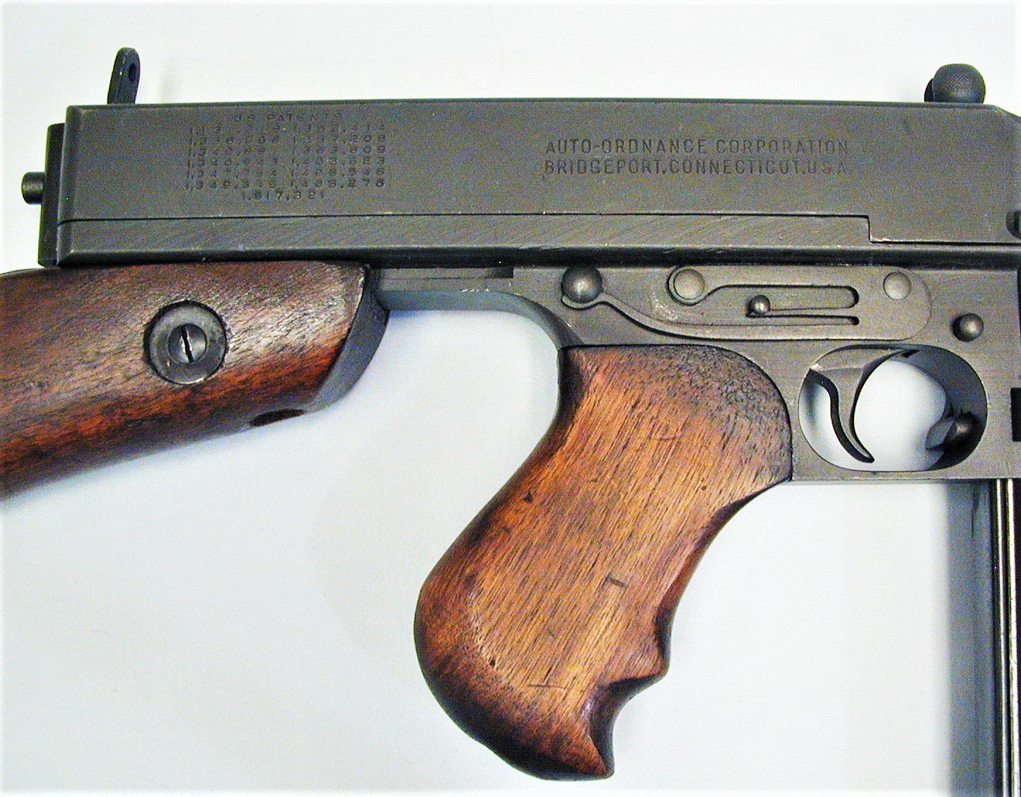

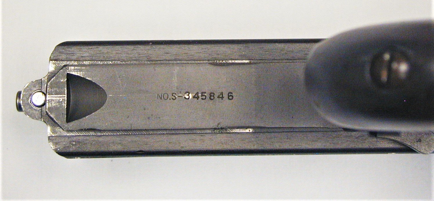

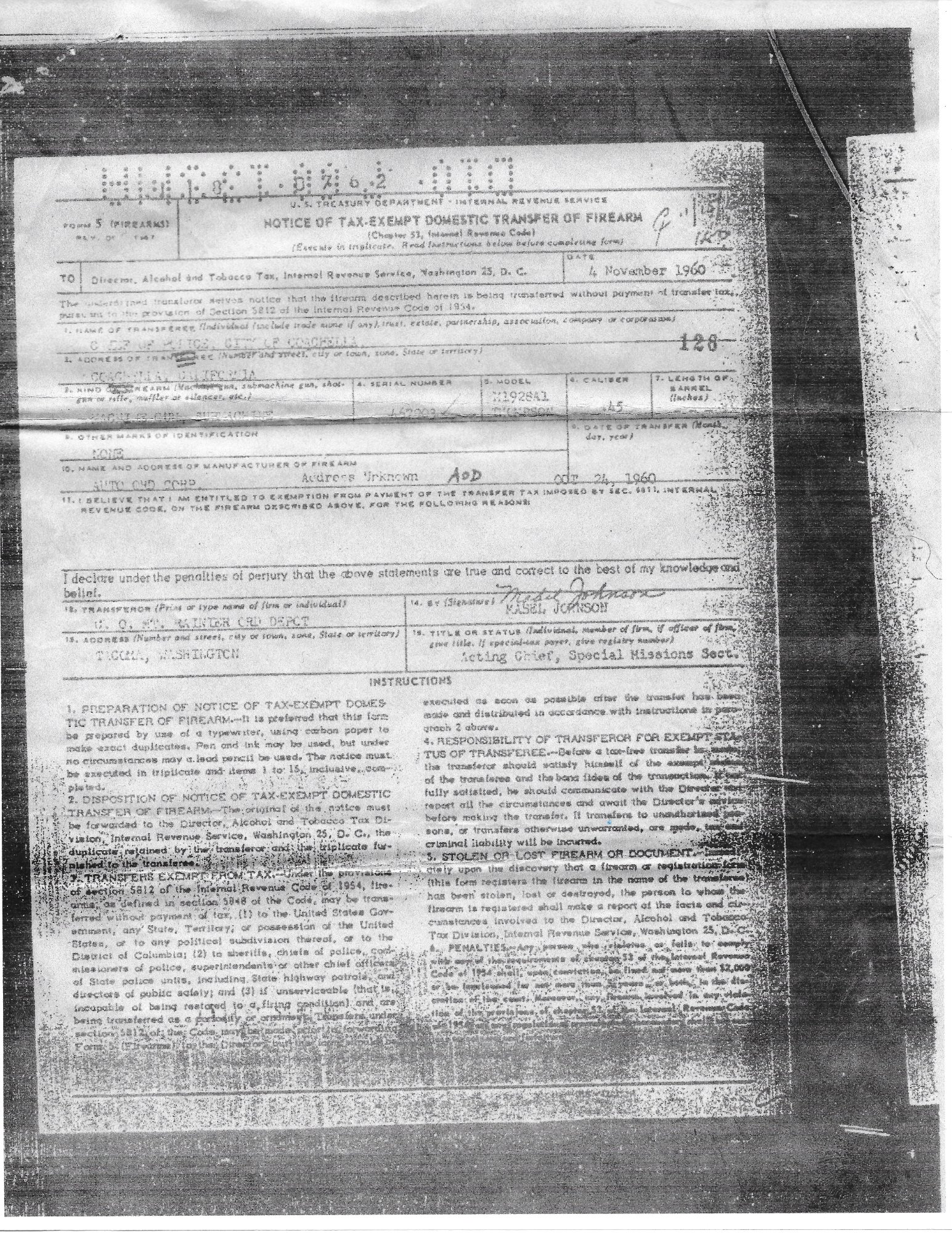

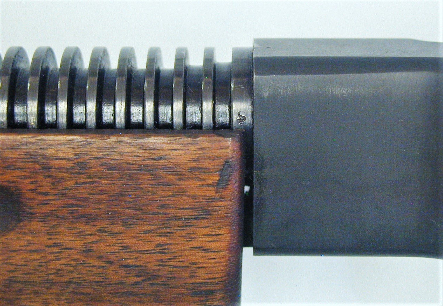

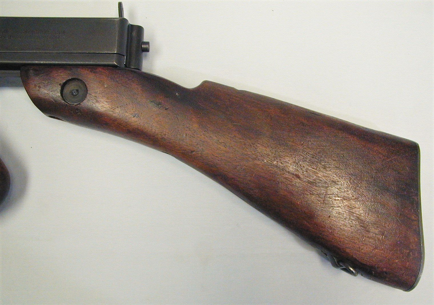

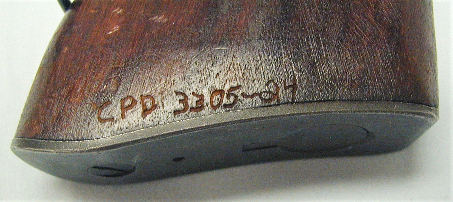

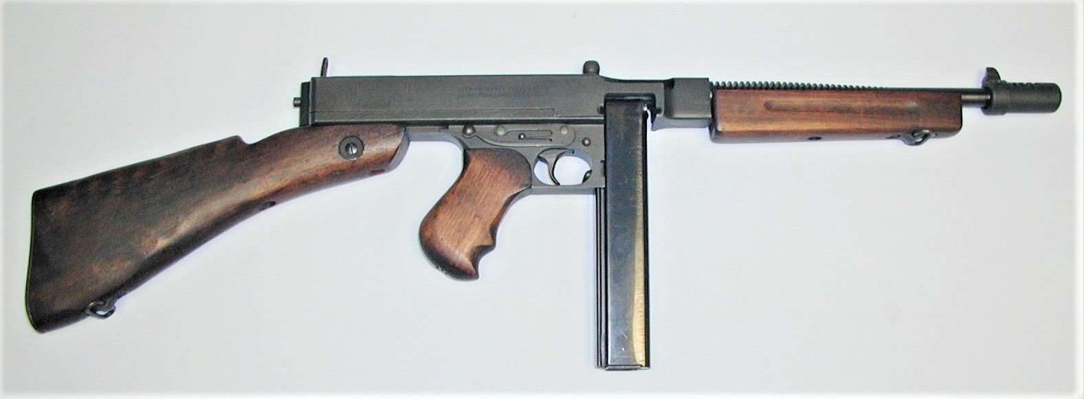

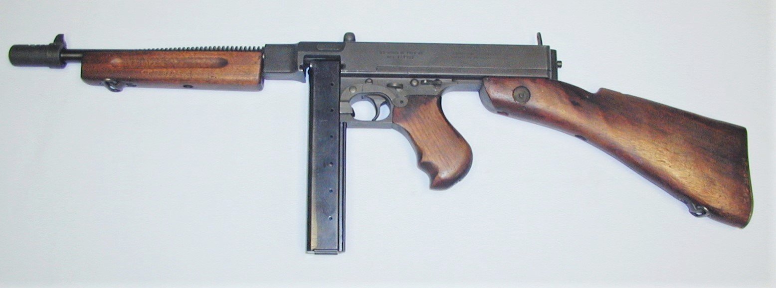

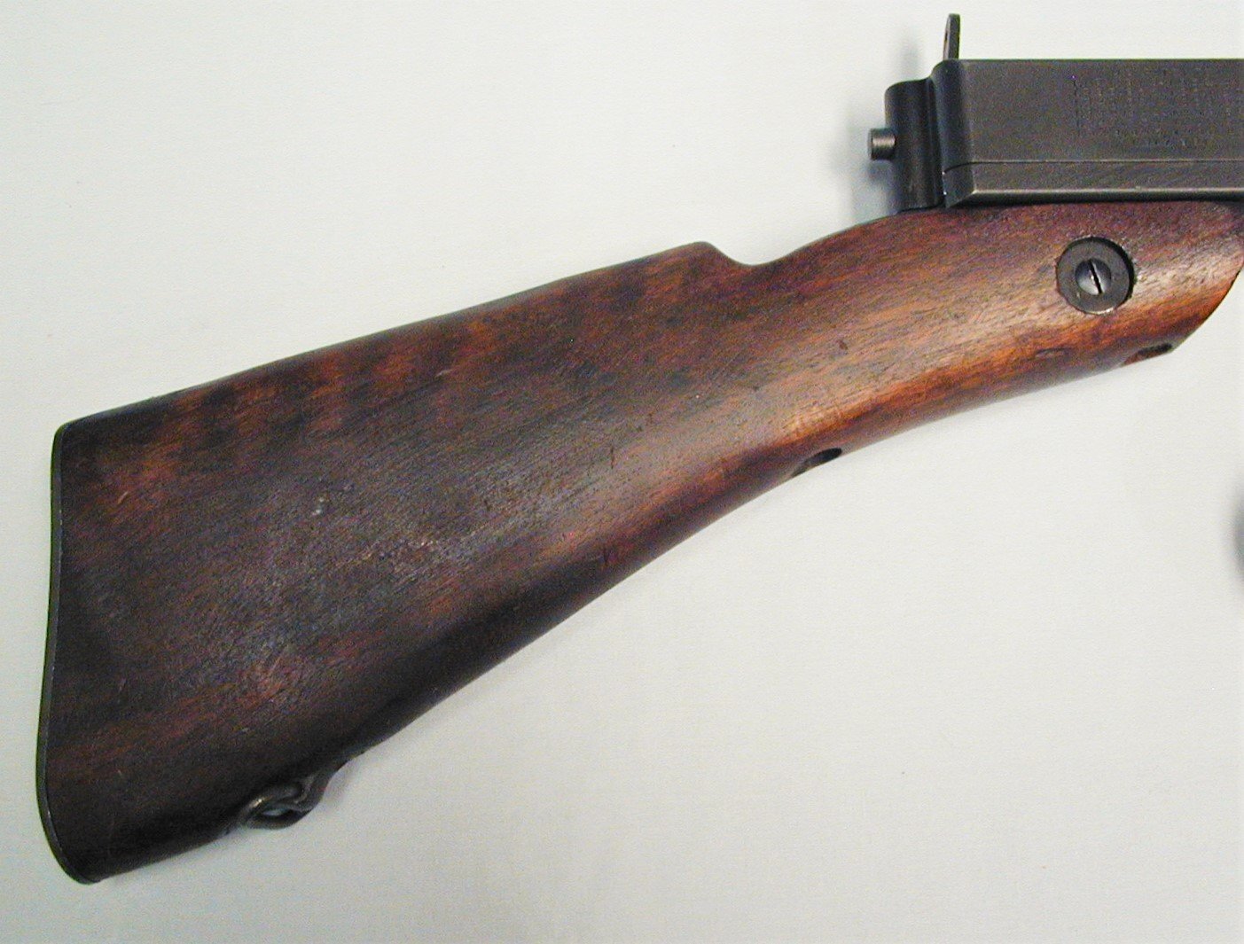

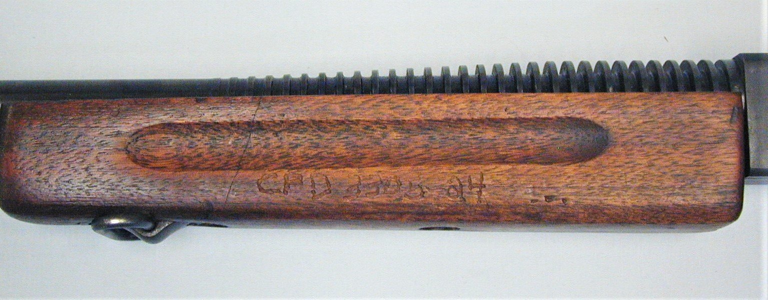

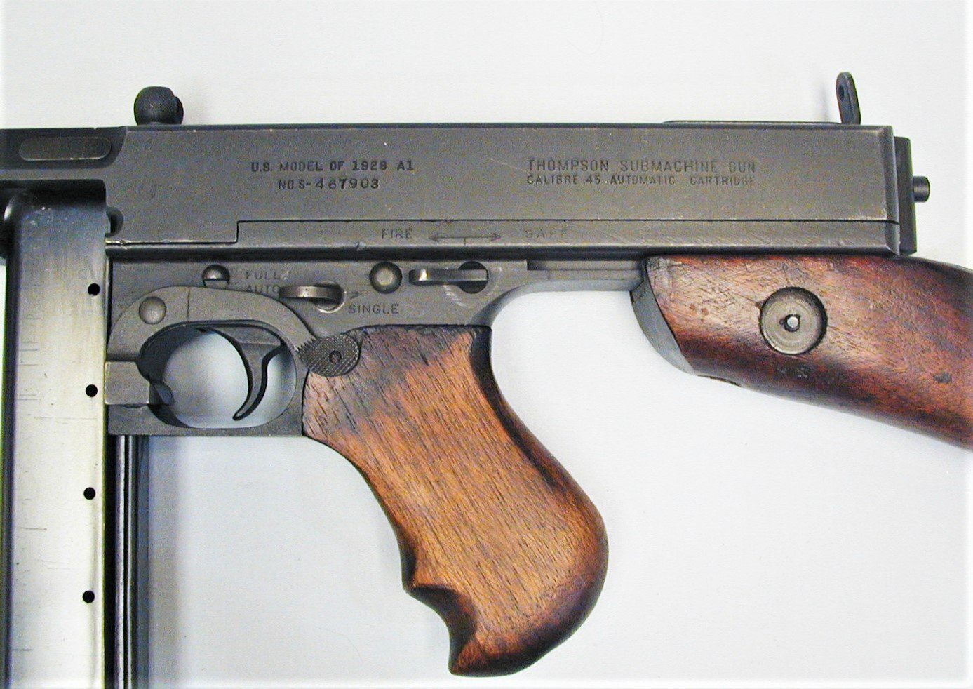

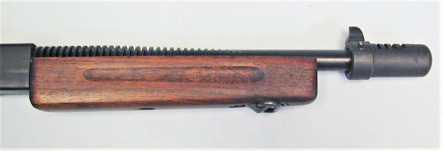

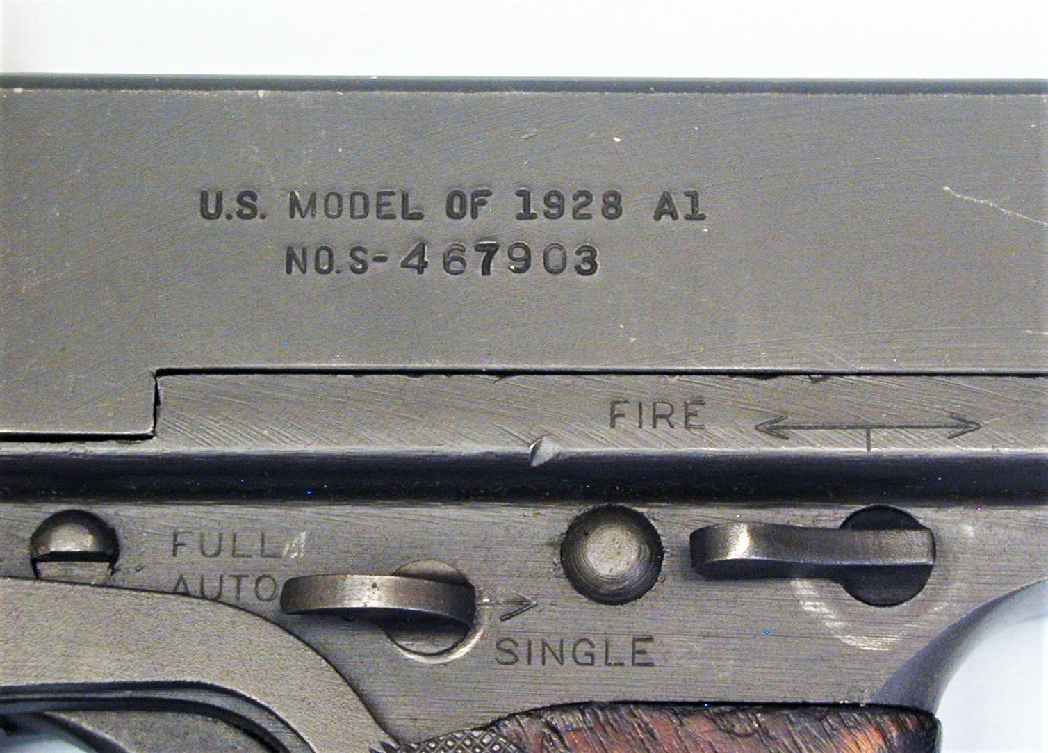

firearm Posted September 1, 2023 Report Share Posted September 1, 2023 Let's see if this is what you are looking for. I bought this 1928A1 from the Coachella Police Department, Coachella CA. back in 1996. The attached document is what they sent me to show proof of ownership, so I could type up the form 5. It is a Form 5, "Notice of Tax-Exempt Domestic Transfer of Firearm. Is difficult to read as it a copy of the original old-time fax sheet that they had in their files. Just in case you can't make out the info: CHIEF OF POLICE, CITY OF COCHELLA COACHELLA, CALIFORNIA MACHINE GUN, SUBMACHINE 467903 .45 NONE AUTO ORD CORP., Address Unknown "AOD" Oct 24, 1960 C.O. MT. RAINIER ORD DEPOT TACOMA, WASHINGTON MASEL JOHNSON Acting Chief, Special Missions Sect. Will follow this post with some pics Link to comment Share on other sites More sharing options...

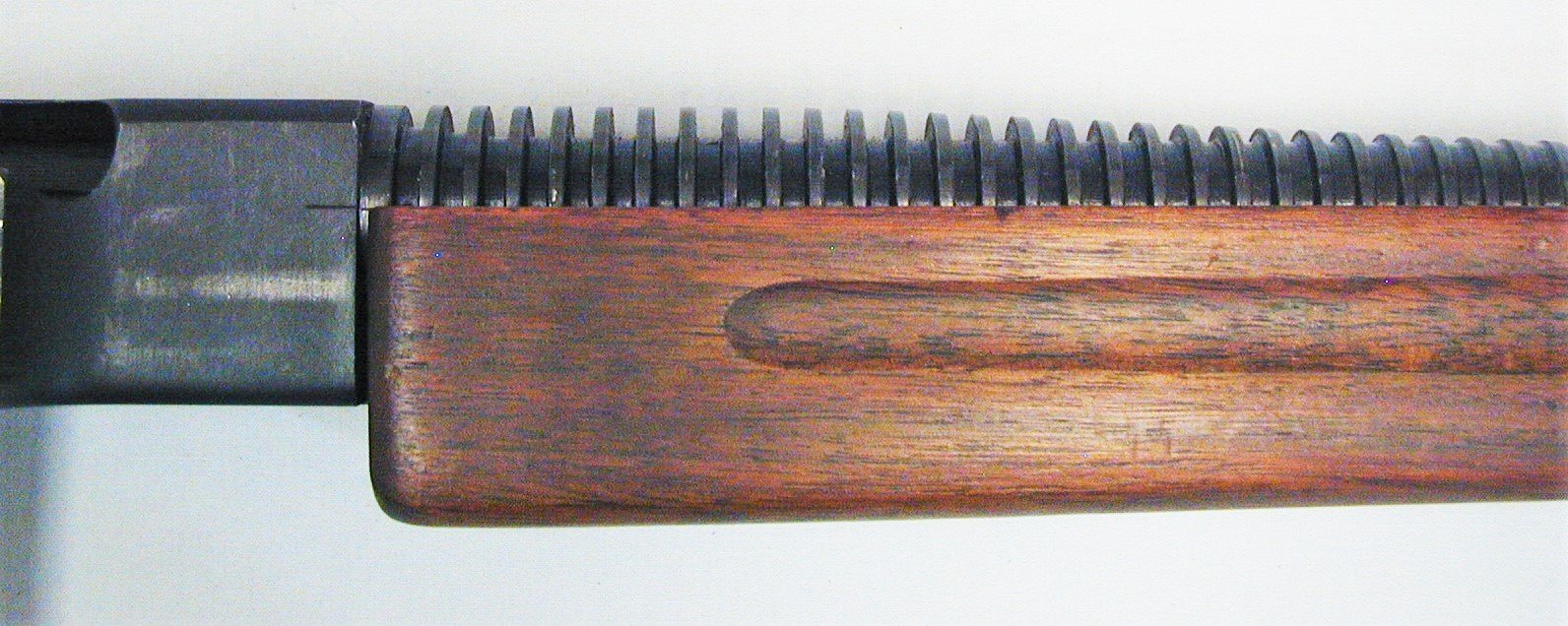

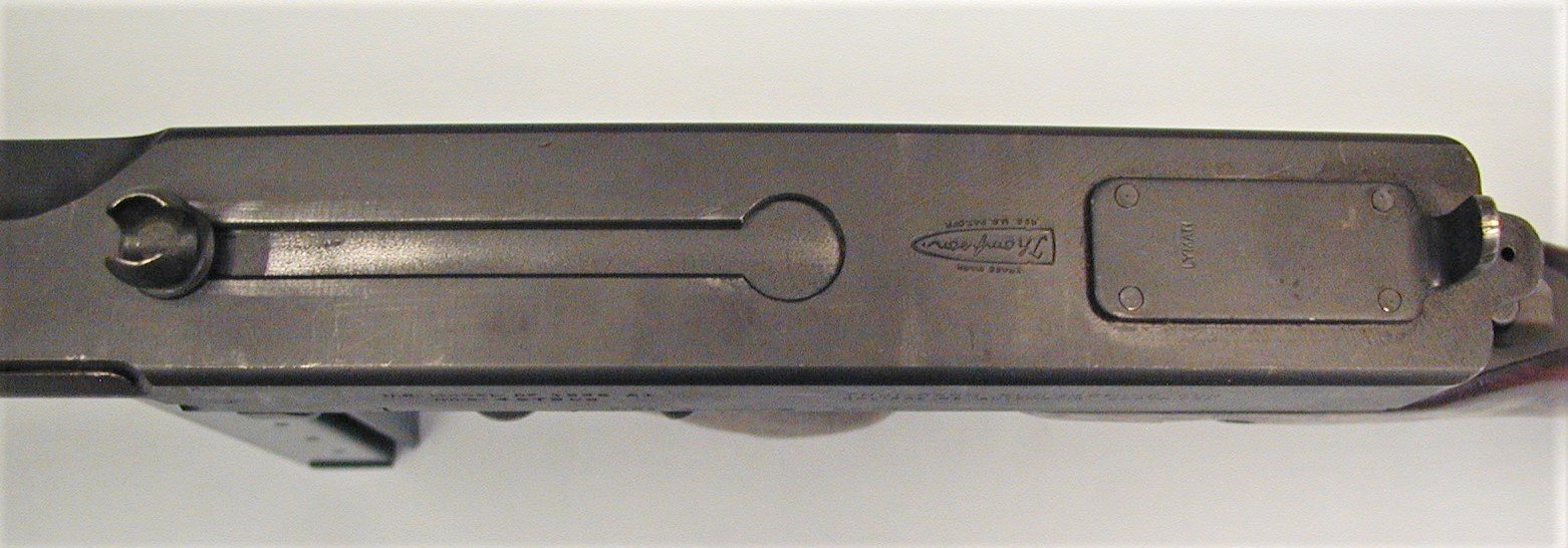

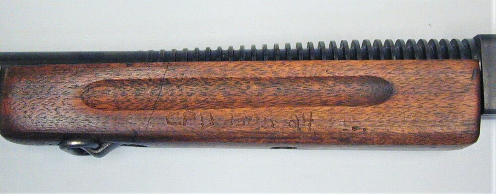

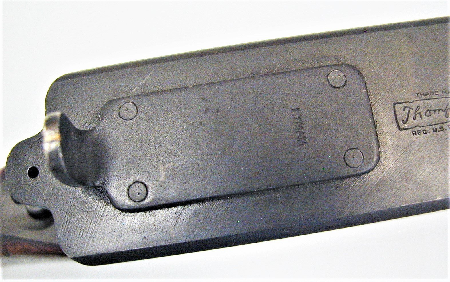

firearm Posted September 1, 2023 Report Share Posted September 1, 2023 Still have that 28A1 Link to comment Share on other sites More sharing options...
Bridgeport28A1 Posted September 2, 2023 Report Share Posted September 2, 2023 1 hour ago, firearm said: Let's see if this is what you are looking for. I bought this 1928A1 from the Coachella Police Department, Coachella CA. back in 1996. The attached document is what they sent me to show proof of ownership, so I could type up the form 5. It is a Form 5, "Notice of Tax-Exempt Domestic Transfer of Firearm. Is difficult to read as it a copy of the original old-time fax sheet that they had in their files. Just in case you can't make out the info: CHIEF OF POLICE, CITY OF COCHELLA COACHELLA, CALIFORNIA MACHINE GUN, SUBMACHINE 467903 .45 NONE AUTO ORD CORP., Address Unknown "AOD" Oct 24, 1960 C.O. MT. RAINIER ORD DEPOT TACOMA, WASHINGTON MASEL JOHNSON Acting Chief, Special Missions Sect. Will follow this post with some pics Thank you for posting this. Link to comment Share on other sites More sharing options...
TD. Posted September 2, 2023 Author Report Share Posted September 2, 2023 Nick, As we discussed, this is exactly the type of documentation I am looking for. It is excellent provenance for Savage Thompson S-467903. No, it does not say Accountable Property Officer, but nonetheless it is documentation of a US Army transfer (Mt. Ranier Ordnance Depot) of a Thompson submachine gun to a police department in 1960 on an IRS Form 5. This is one nice Savage Thompson. Unfortunately, it is a mismatch but that is common on World War II Thompson submachine guns. It was probably rebuilt after the war at the Mt. Ranier Ordnance Depot and put in storage. Anyone looking for a nice Savage should be ringing your number! Again, thank you for posting. Link to comment Share on other sites More sharing options...
