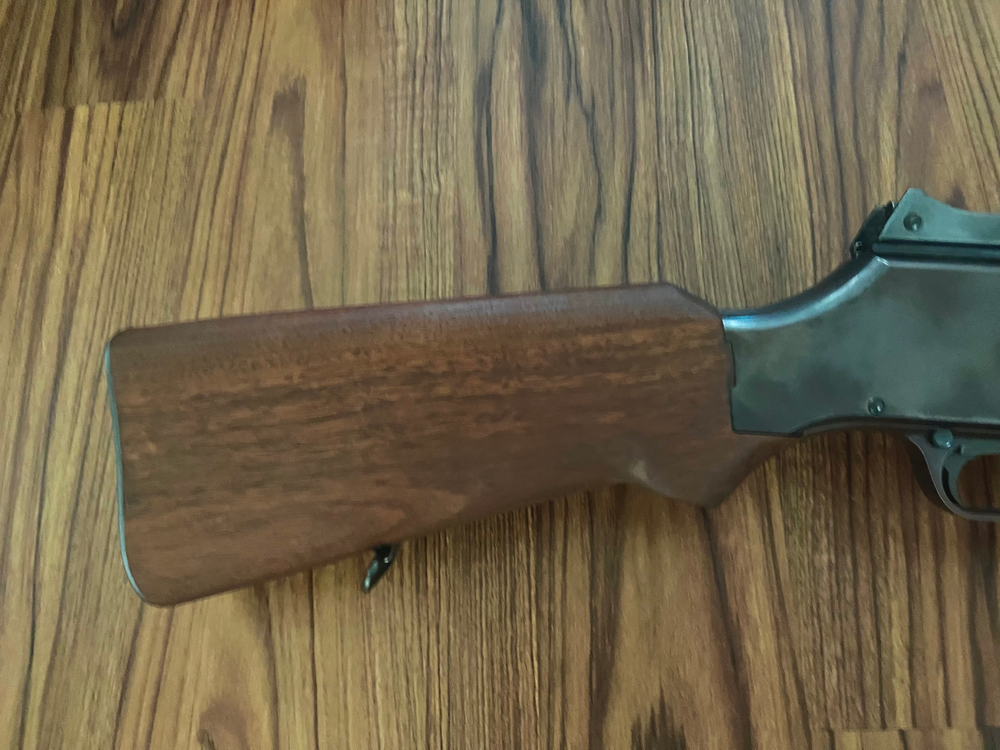

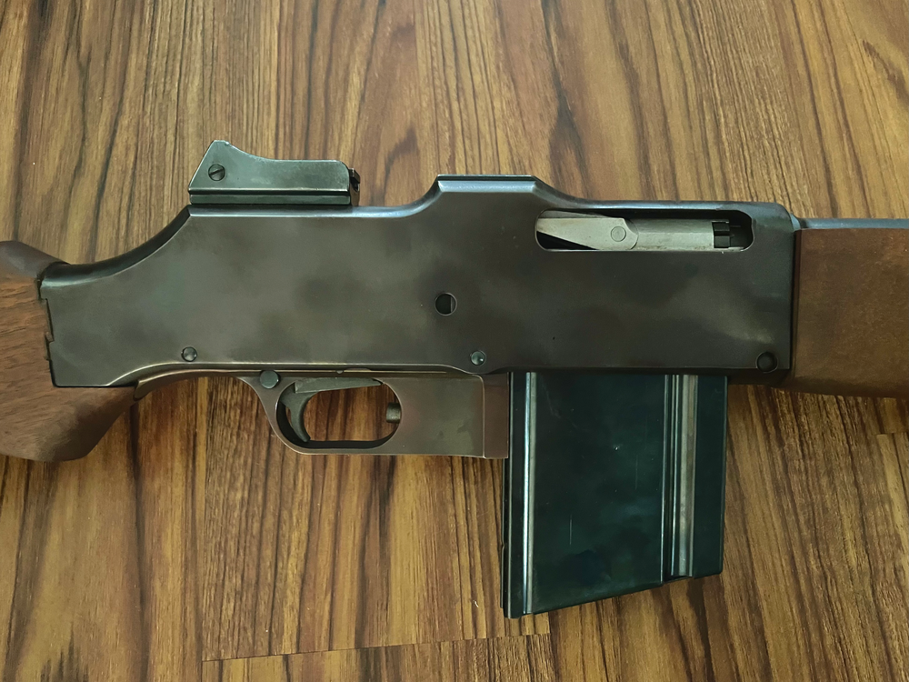

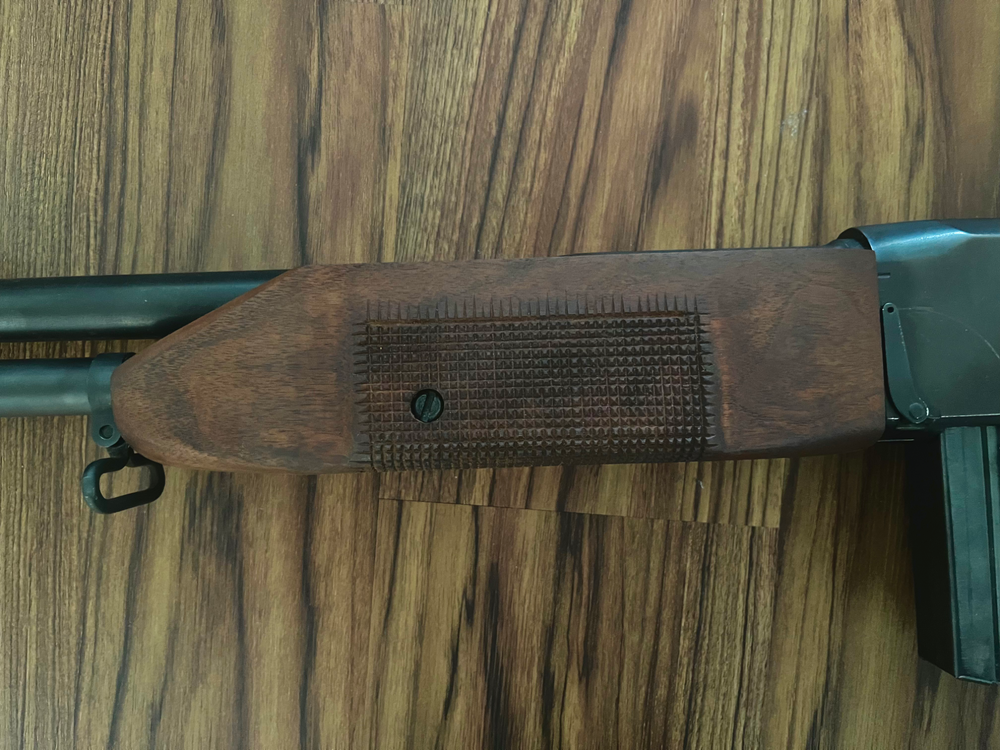

velken Posted September 27, 2024 Author Report Share Posted September 27, 2024 And finally got it back from deerslayer. He really outdid himself this time. And so presto, the Browning automatic rifle, caliber .30, M1918 (modified), as the Marine Corps referred to it as. As far as I know, it's the only firing reproduction of the USMC Jungle BAR anywhere. Still retains its bulk, but significantly handier, that's for sure. I can see why the Marines thought it was something worthy of further testing. 2 Link to comment Share on other sites More sharing options...
