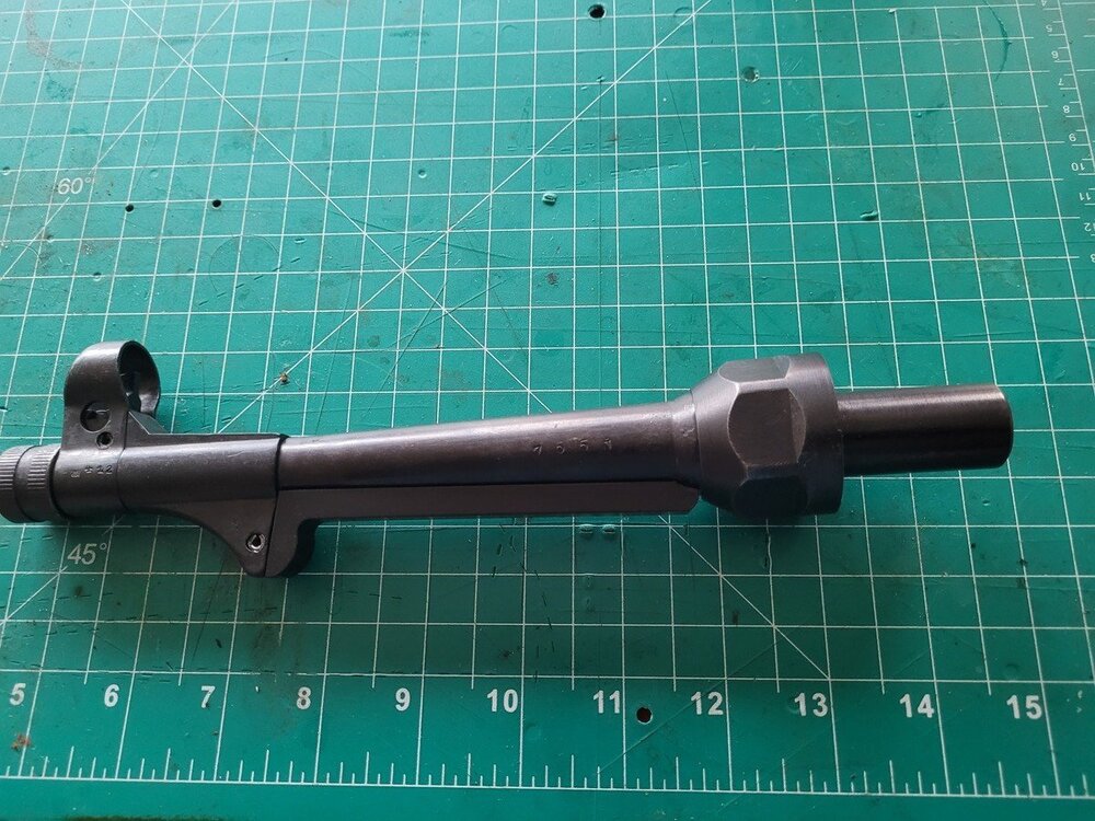

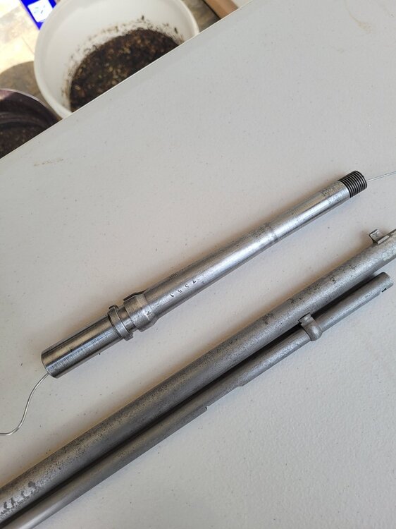

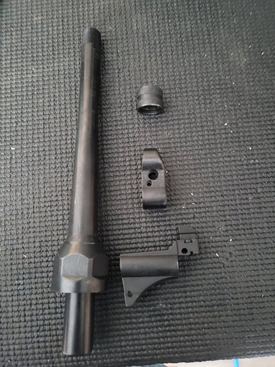

Wiking44 Posted December 17, 2024 Author Report Share Posted December 17, 2024 (edited) Well men, I've retired and had some time to try to do the bluing on my own. I took my #4 MP40 barrel which is what I would refer to as a 'shooter barrel' because it's pretty badly pitted but retains rifling and gave it a go. I think it came out ok. I did hot caustic bluing using Sodium Hydroxide and Sodium Nitrate. This method isn't for the faint of heart as the caustic burn on my big toe will attest to!!! First pic is barrel after I sand-blasted and polished it. Second pic in lower right is the site assembly, barrel nut, and a spare extractor 'in the white'. (I blued a few things that day) Third pic is after bluing. Fourth is assembled. The barrel rest is a repro and it needed to be grinded to fit. I had a devil of a time getting the roll pins cut to the right size. They're still too short but good enough for now. The threaded cap at end was not re-blued and I don't have the retention clip on it. I think it turned out ok. What do you think? Edited December 17, 2024 by Wiking44 Link to comment Share on other sites More sharing options...

Wiking44 Posted December 18, 2024 Author Report Share Posted December 18, 2024 ? Any comment on the job? Link to comment Share on other sites More sharing options...
NFA amnesty Posted December 19, 2024 Report Share Posted December 19, 2024 I think you did a good job and have great skills. However, your finish appears a bit flat to me unless that is just the lighting and does not have that german bluing hue you find on a MP40. I have talked with John Andrewski (JA) regarding bluing on a German MP40 and he gets close to the look of an original MP40. I love how mine turned out after John did the refinished it. If it was me, would talk with JA and have him do the refinish so you get close to the original look as possible. However it is your MP40 and if you like it, then please ignore my above comment. Link to comment Share on other sites More sharing options...
reichstall Posted December 19, 2024 Report Share Posted December 19, 2024 Ilike the job you did. as the above mentioned the buffing will increases luster but at a price. so whatever makes you happy. Link to comment Share on other sites More sharing options...
TSMGguy Posted December 19, 2024 Report Share Posted December 19, 2024 I'd call the original finish on my bnz 41 MP40 "dark, semi-gloss hot dipped blue black". Link to comment Share on other sites More sharing options...
Wiking44 Posted December 19, 2024 Author Report Share Posted December 19, 2024 Thanks for the feedback gents! I hadn’t considered trying to get an original looking appearance, because I don’t really know what that is. I did not polish or buff it afterwards, I was just glad it was black and not the really worn look it had before. I have a hard time getting correct lighting for images, but it is definitely flat black in its current condition…maybe satin. I’ll look into shining it up a bit. You guys are awesome. Thanks. Link to comment Share on other sites More sharing options...
