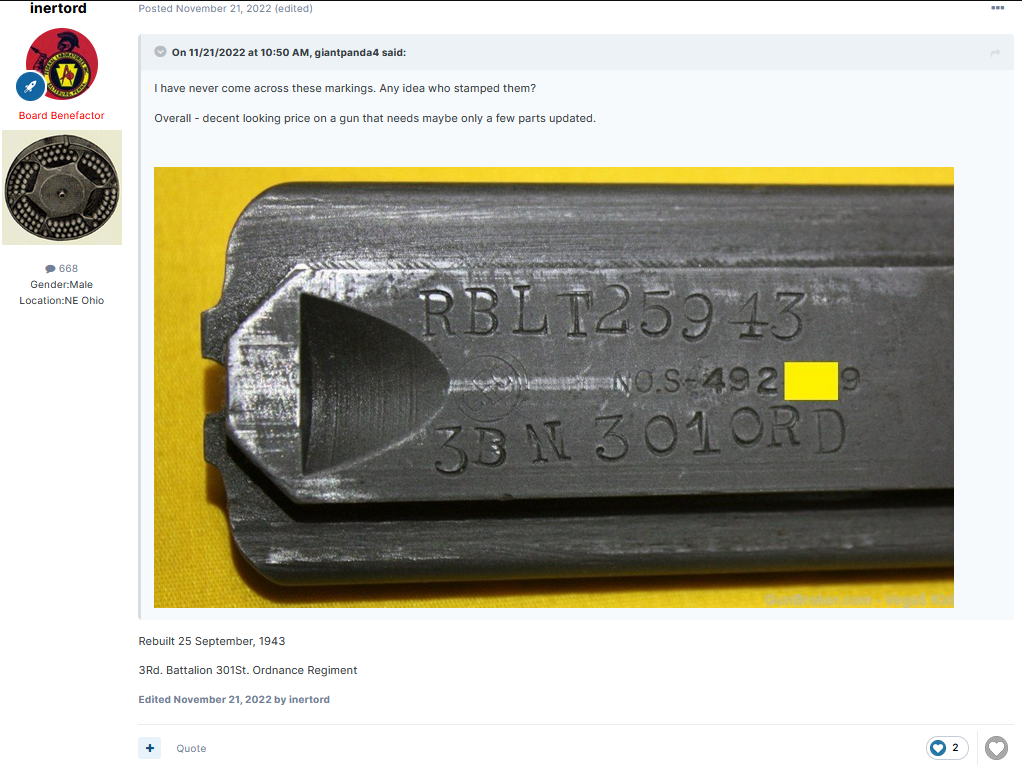

Chip Posted December 17, 2023 Report Share Posted December 17, 2023 This was from a post about a year ago. It looks like maybe some '28s may have been rebuilt, although there much discussion about this being very unusual, or someone with too much time on their hands. This was the same thread which included the square vs rounded magazine slots, which didn't have anything to do with rebuilds. If the Sept 1943 date is valid, it would be about mid-WWII and a year to year and a half after the M1s and M1A1s began production respectively. Link to comment Share on other sites More sharing options...
TSMGguy Posted December 17, 2023 Report Share Posted December 17, 2023 The Ordnance branch salvage effort during WWII was vast. It included the gathering up of discarded weapons and returning them to service after necessary work in theater. This was a different operation than the stateside rebuilding of weapons at the depot and arsenal level. Link to comment Share on other sites More sharing options...

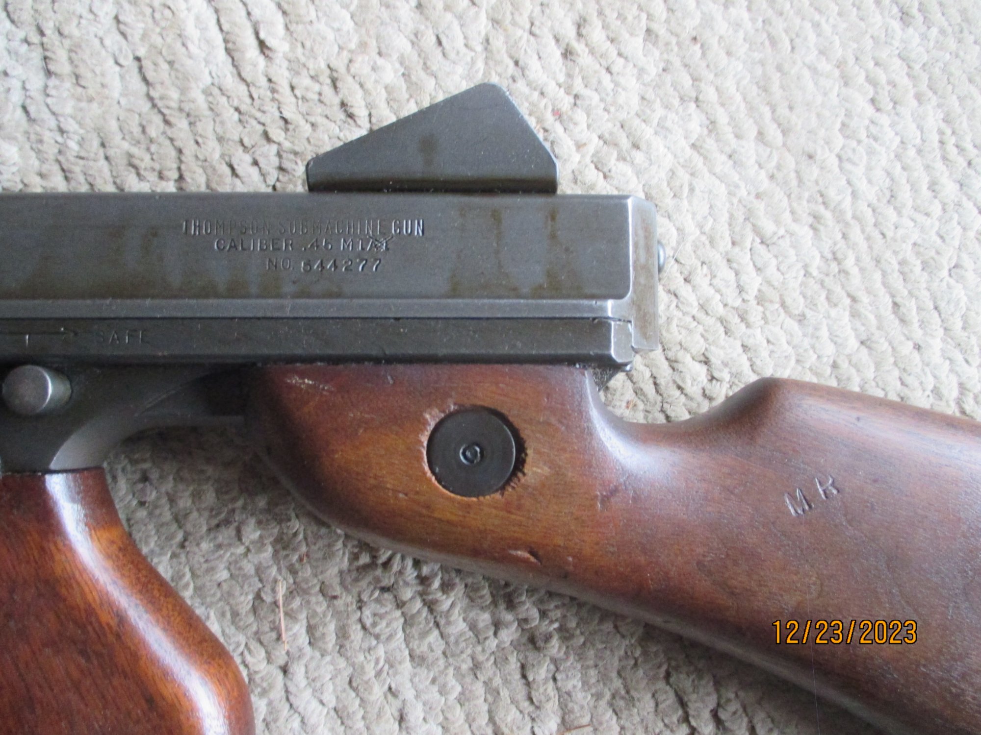

chipsaunders Posted December 23, 2023 Report Share Posted December 23, 2023 I have an M1A1 that looks like it was rebuilt as an M1 by Mt. Ranier. Link to comment Share on other sites More sharing options...
