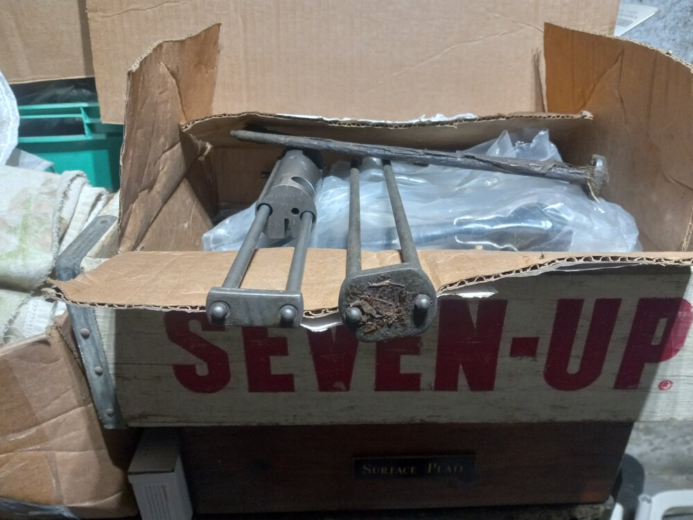

Rekraps Posted January 5, 2024 Author Report Share Posted January 5, 2024 4 hours ago, Got Uzi said: It’s well worth putting an M3 plate in the back. If you want the ease of taking it apart without taking off the lower (on an M3A1) then cut a slot in the plate for clearance so the ejector will pass through it. I'm having trouble picturing what you guys are talking about... any pics? Link to comment Share on other sites More sharing options...

Got Uzi Posted January 5, 2024 Report Share Posted January 5, 2024 M3 guide rod set or back plate was a fully round disk that had a couple holes drilled in it and a couple flats to hold it for said drilling operation. It makes contact with nearly the entire back end of the receiver. M3A1 guide rod set or back plate is only 1/2" wide (going off memory here) and makes very little contact on the back of the receiver. Less contact means all the backwards force of the bolt is being put into one small area and over time WILL stretch/crack/blow out the back of the receiever as well as egg out the guide rod locating holes. You can "buffer" all you want on an M3A1 backer plate but it wont help much....and for the person who will say "it makes taking the gun apart easier" just remember this- WE ARENT IN COMBAT so it doesn't mean a darn thing to take the extra 60-90 seconds and drop the ejector housing out of the gun to remove the bolt assembly. If that is too much of a mechanical difficulty for you and you just have to do it you own way, then cut a slot in an M3 backing plate so it'll clear the ejector when you remove the bolt assembly. For a $32.5k to $35K if you are too darn cheap to put a $20 set of spring in or a $40-$50 M3 guide rod set in....you are just kidding yourself..... Link to comment Share on other sites More sharing options...
