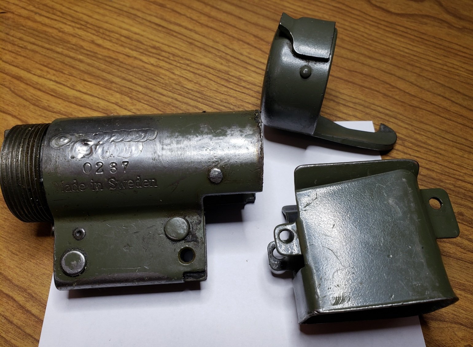

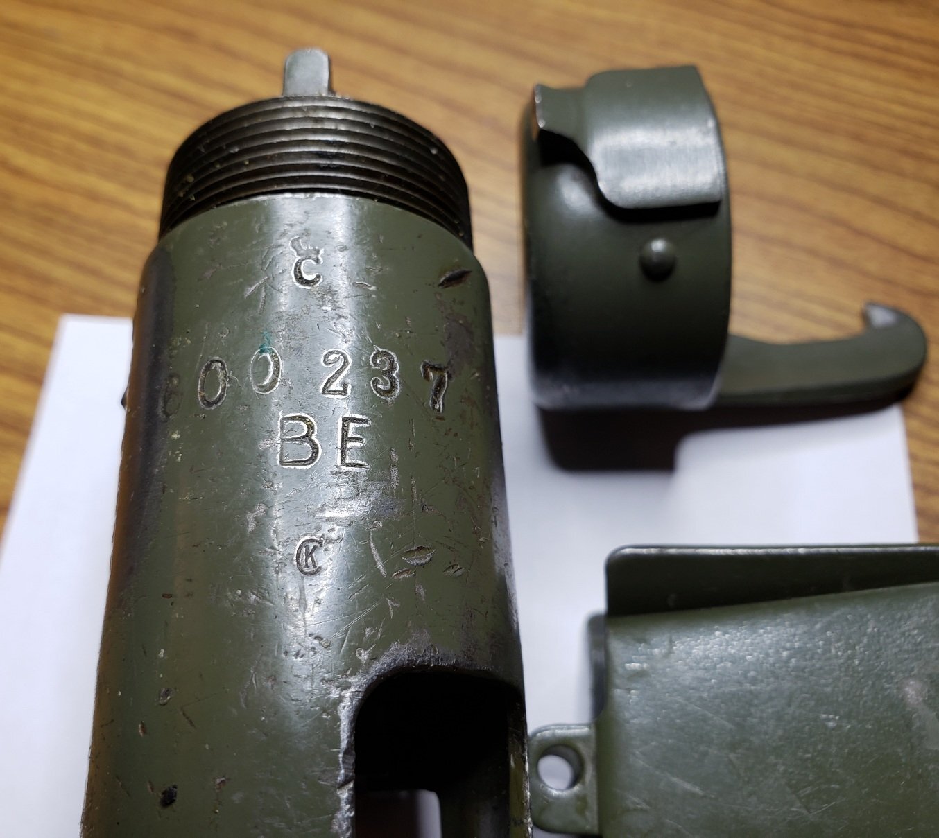

Lewisfan Posted February 14, 2024 Report Share Posted February 14, 2024 I just pulled out my copy of Frank Iannamico's "The Smith & Wesson Model 76 Submachine Gun" book. This is a great resource and "must have" for the family of guns starting with the Swedish K (nicely covered in the book). Frank has a number of great pictures of the variants showing the riveted magwell on the "fixed" magwell guns, including the "BE" designated police select-fire variant. Out of curiosity I pulled one of my spare select-fire parts kits and sure enough, the kit is drilled, and the magwell is just like the "removable magwell version". I guess that explains why most kits don't come with the clip - it never had one (was riveted). Interesting. Link to comment Share on other sites More sharing options...

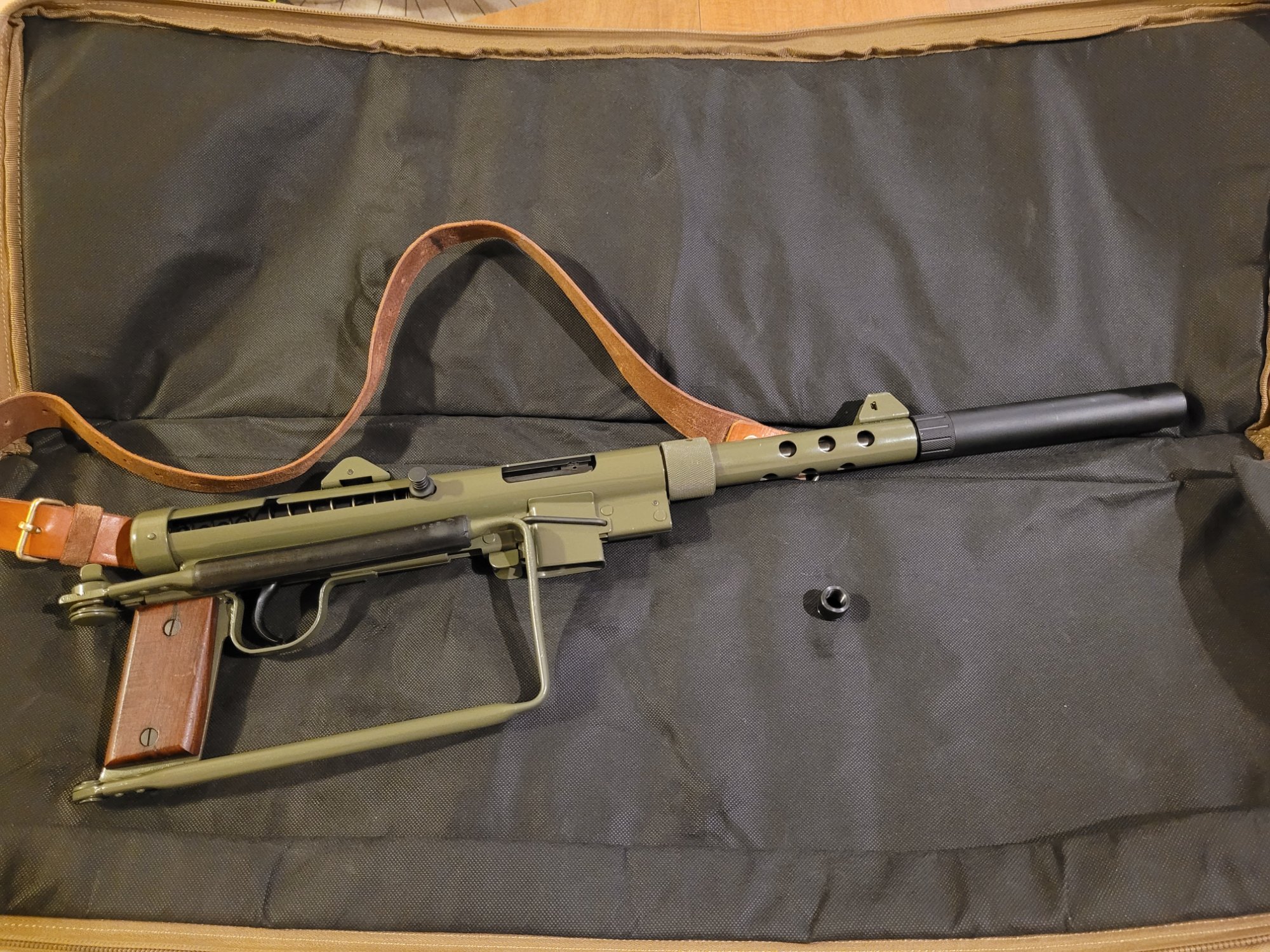

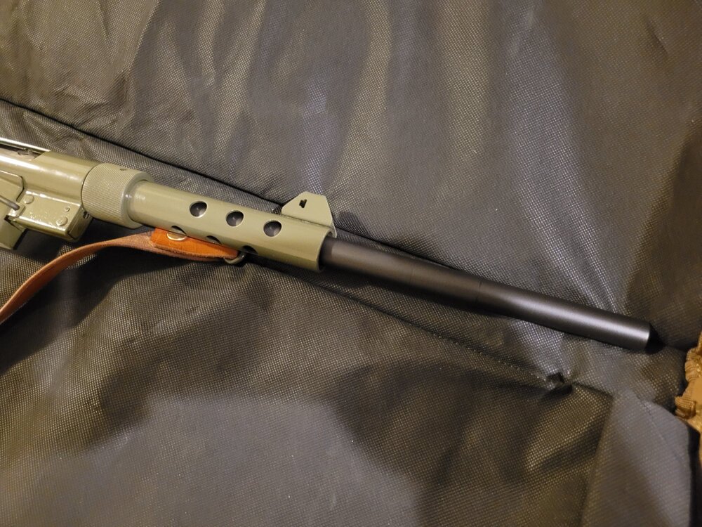

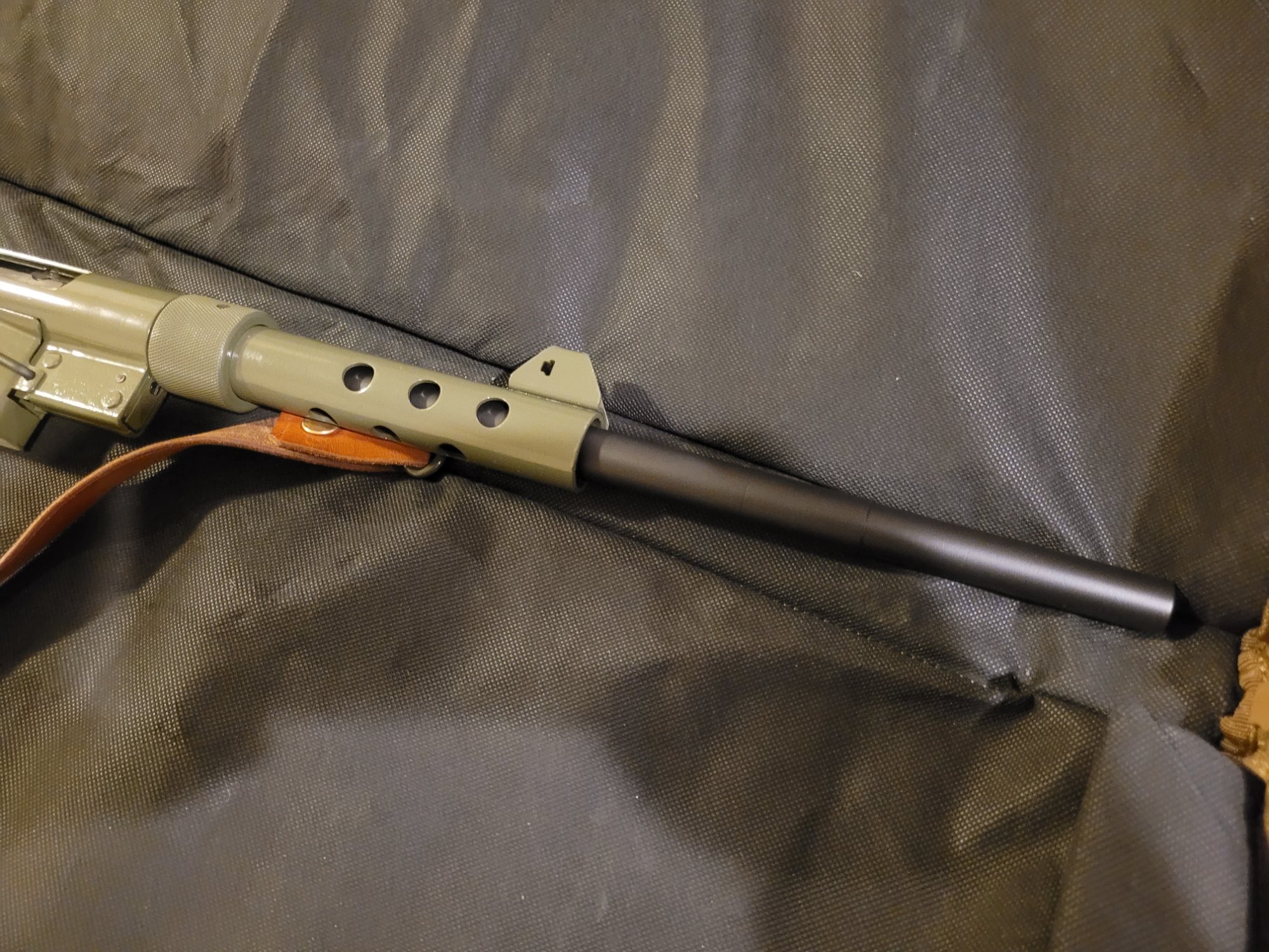

Mark5 Posted March 9, 2024 Report Share Posted March 9, 2024 So a little late to the thread after signing up. Thanks for the Pike link. Have to be oportunistic during windows of parts availability; funny how the nfa habit also turns you into parts hoarder. I used one of the KP-31 barrels from BRP for my can project. Cut it down and threaded about an 1/8" from shroud. That let me use an old Trinity can with a GSL fixed adaptor and unmodified shroud. I was pleased with the result. I also picked up one of the 16" barrels in the white from IO. Had to turn down the rib OD about 0.01" to fit the K's trunion, but then had plenty of clearance to ceracoat it. Now I can at least mail it registered usps without grief (at least until they change rules again). Link to comment Share on other sites More sharing options...
