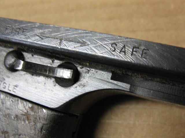

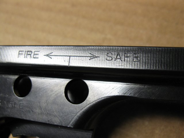

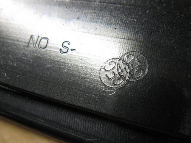

reconbob Posted February 7, 2024 Report Share Posted February 7, 2024 We have discussed a couple of times the counterfeit "Savage" Thompson trigger frames sold by Scotty57 on Gunbroker and also by Mckay Enterprises. The sample I got back in the summer had a parkerized finish which concealed the surface finish. I have encountered several of these frames recently and just got one in-the-white that the owner wanted blued. So here are photos to show the difference between Mckay and original G.I. - Mckay - Original G.I. - The frames were represented as original Savage frames which have not been serial numbered yet. This Mckay frame has an incorrect "NO. S" marking with no serial number but with fake GEG markings stamped (smaller than original) where they would be overstamped by a serial number - I think these frames may no longer be available but it seems that they will be turning up for a while as people who bought them "no returns" thinking they were original frames sell them off to get their money back. The quality of the machine work is top notch, the parts fit, etc. But these are NOT original Savage frames so be aware... Bob Link to comment Share on other sites More sharing options...
jirahice Posted February 7, 2024 Report Share Posted February 7, 2024 I almost bought one of these with the idea of hand-stamping the serial of a demilled upper to create a 'matched' pair. I almost bought one and was trying to get it direct from him, but he decided he wanted to charge more than his gunbroker listing even though he'd save the fees, so I never went through with it. Glad I didn't. The GEG stamps right in front of where the serial would go made me suspicious too. As someone in the previous thread said, Sioux ordnance wrapper he put in the background was a nice touch. Link to comment Share on other sites More sharing options...
