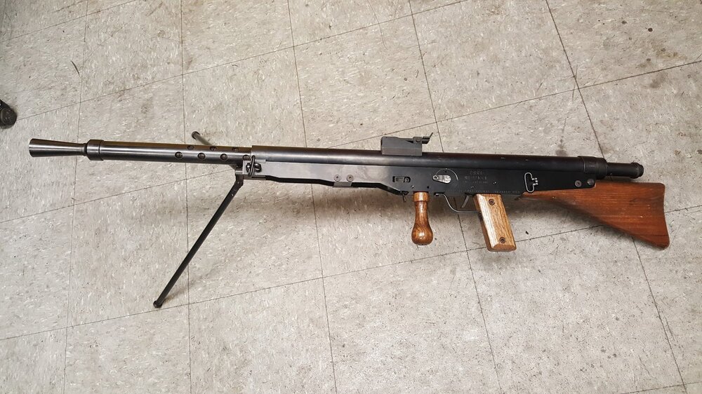

36thTom Posted February 29, 2024 Report Share Posted February 29, 2024 New to this forum so I thought I would share my project. After 5 years of work, I finally got a working prototype of the (In)Famous WWI Chauchat. Developed with the WWI reenactor in mind, this replica uses bolt, magazine and barrel trunion from a CETME squeezed into the new made shell in the shape of the original gun. The prototype was sent off to the ATF Technology Branch for approval (which has been received). The (Blank Fire Only) Non-Gun Is very close to the original dimensions in profile (based on measurements of originals), but the cross section needed considerable "Creative Engineering" to accommodate the double stack CETME Magazine into what was originally designed to take a single stack magazine. The result is something that few who haven't owned an original Chauchat can tell the difference between. Disclaimer: No original Chauchat parts were harmed (or used) in the creation of this replica. The original Chauchat was much maligned (largely due to the disastrous attempt to change to American .30-06), but considering how quickly the design was rushed into production, it is amazing that it worked as well as it did. Few without a background in production engineering can really appreciate what an accomplishment that was. Once the gun's limitation were recognized and understood, it served the French (an American Armies) through the First World War with over a quarter of a million produced. 20231017_175415.mp4 Link to comment Share on other sites More sharing options...

Blanksguy Posted March 3, 2024 Report Share Posted March 3, 2024 What Blanks are you using for your Blank-Firing Chauchat (?). Have you thought about making magazines for this yet (?).......with the possibility of using a magazine that would fit inside the Chauchat magazine (?). Will you be making copies of these to sell (?).......price (?).....and I am interested in one. Link to comment Share on other sites More sharing options...

36thTom Posted March 4, 2024 Author Report Share Posted March 4, 2024 23 hours ago, Blanksguy said: What Blanks are you using for your Blank-Firing Chauchat (?). Have you thought about making magazines for this yet (?).......with the possibility of using a magazine that would fit inside the Chauchat magazine (?). Will you be making copies of these to sell (?).......price (?).....and I am interested in one. It uses .302 Blanks. Basically a short crimped .308/7.62mm. It uses CETME Magazines with a 3d printed Faux Magazine to give it that "look". I'm not a het metal guy, so making/repro-ing the magazines is not a practical option for me (at this time). Yes I am making copes to sell @ 6.5k each. Link to comment Share on other sites More sharing options...
