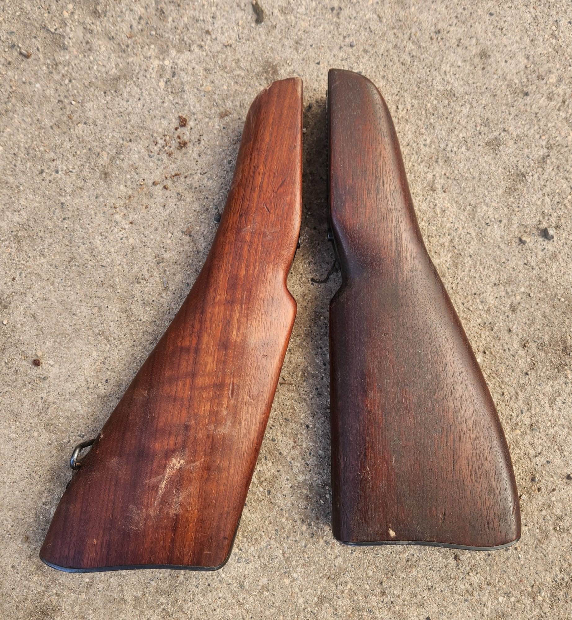

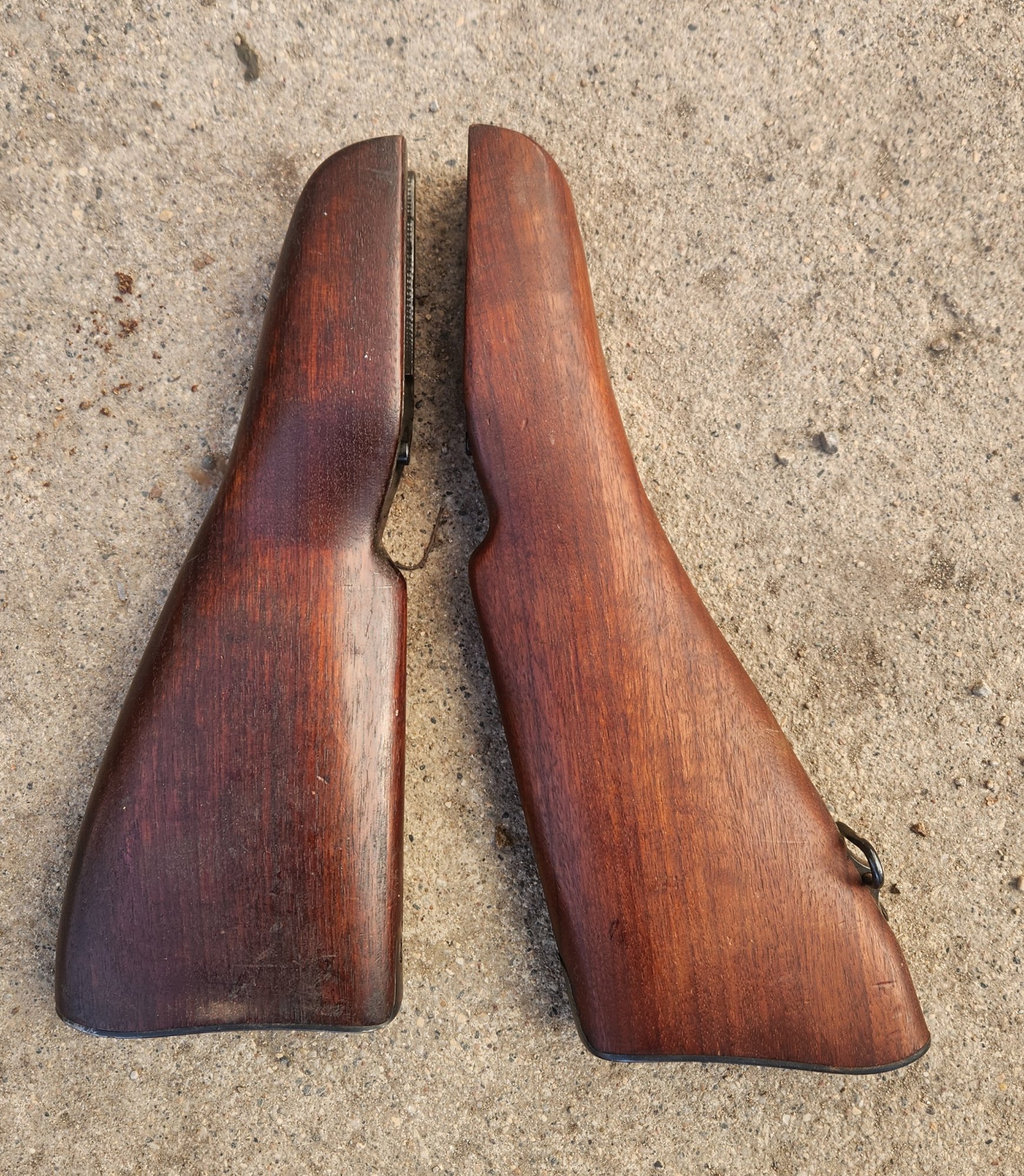

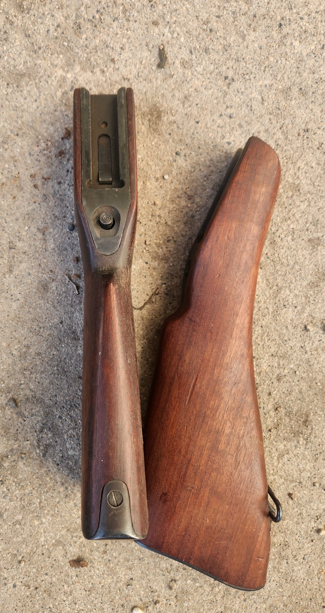

deerslayer Posted March 1, 2024 Report Share Posted March 1, 2024 This straight stock came from Merles basement. What/where do you think this originates? Its not newly made, and its not an altered gi stock. The condition of the finish seems to match gi age stocks. Link to comment Share on other sites More sharing options...
pvt81pvi Posted March 1, 2024 Report Share Posted March 1, 2024 M1923 heavy Thompson stock? Link to comment Share on other sites More sharing options...
Got Uzi Posted March 1, 2024 Report Share Posted March 1, 2024 The angle of the stock sure looks like a 1923 but it appears to be too short Link to comment Share on other sites More sharing options...
deerslayer Posted March 1, 2024 Author Report Share Posted March 1, 2024 (edited) Maybe... can it be proven? 11 3/4 length across the top. Is there a 1923 stock in a collection that can be measured/examined? Edited March 1, 2024 by deerslayer Link to comment Share on other sites More sharing options...

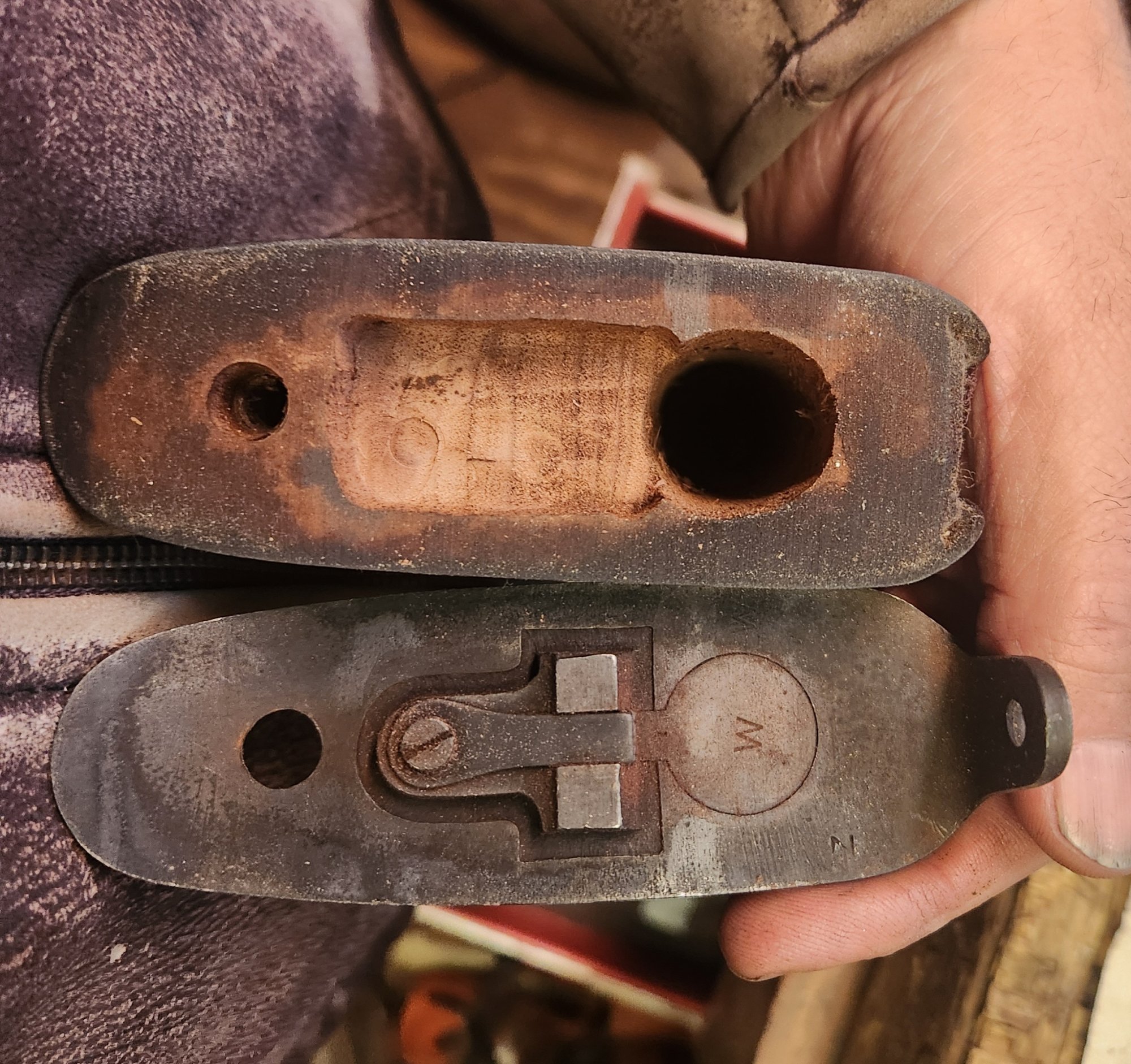

deerslayer Posted March 1, 2024 Author Report Share Posted March 1, 2024 The latch has been repaired by welding at some point in the past. Link to comment Share on other sites More sharing options...

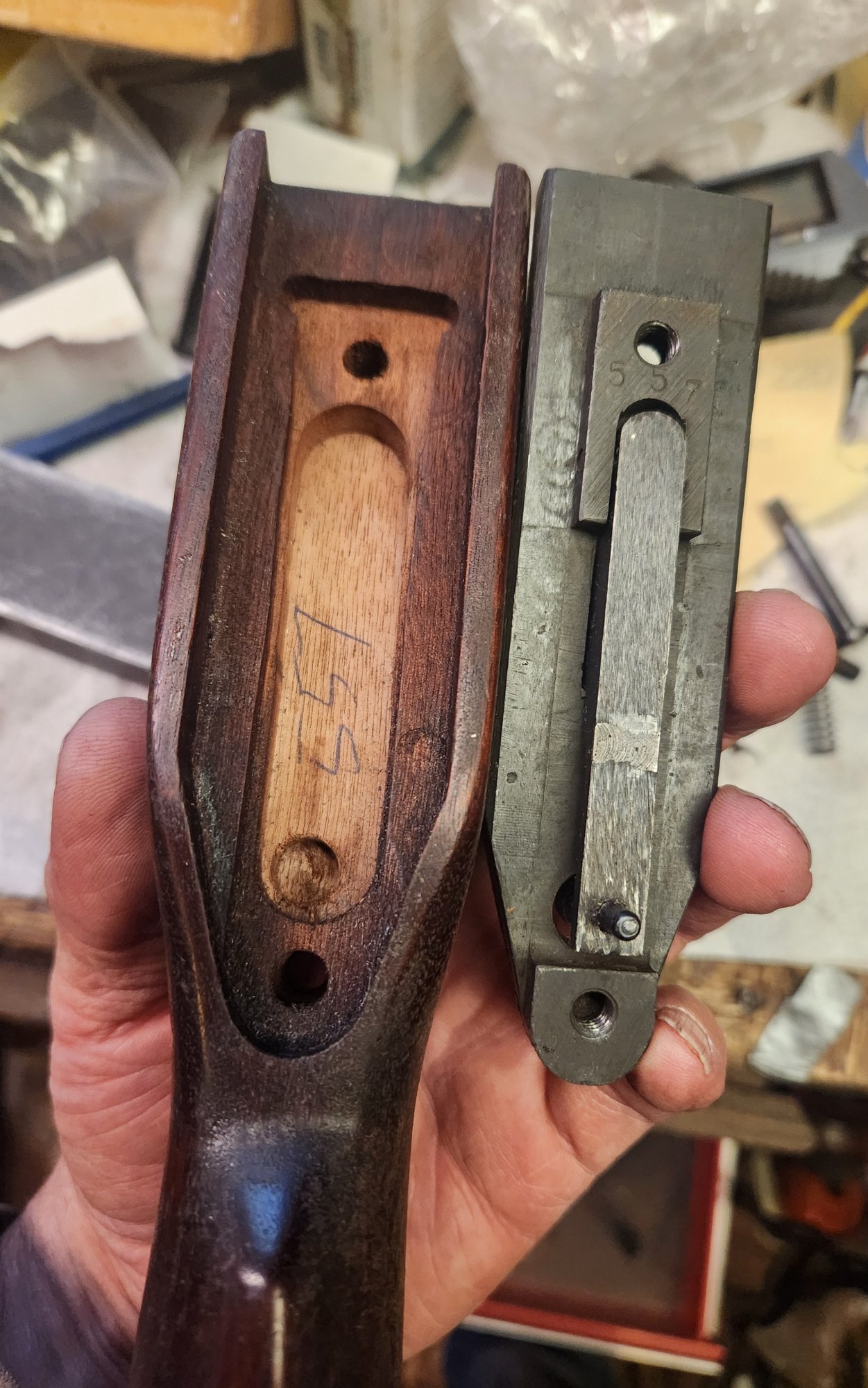

TD. Posted March 1, 2024 Report Share Posted March 1, 2024 It appears to me Merle was attempting to make a short butt stock in the Model of 1923 style. The Butt Stock Slide is early Savage - see the 557 Assembly Number. The swirl pattern on the Catch Button is interesting on the repaired Butt Stock Catch. It appears similar to a Model of 1919 Catch Button. Another Merle product? I would guess the WWII butt plate has been fitted at the toe end for the shortened butt stock. This butt stock may be perfect for a smaller male or female shooter. Perhaps an unfinish custom product for a customer. Thank you for sharing. 1 Link to comment Share on other sites More sharing options...
deerslayer Posted March 1, 2024 Author Report Share Posted March 1, 2024 But the wood is built straight. Not altered. Merle didnt do wood work. And if you cut down a gi stock the metal is oversized. Link to comment Share on other sites More sharing options...

TD. Posted March 1, 2024 Report Share Posted March 1, 2024 Not all of the known surviving Model of 1923 development project Thompson guns have this type of straight butt stock at the comb. But the few that do all have sling swivels as far as I can tell with known pictures. Perhaps this is a Doug Richardson project that went to Merle. While I cannot discount the provenance of the wood butt stock, I feel certain the stock slide assembly and butt plate were not made at Remington Arms in 1921/22 for the Colt guns. I would like to see how it works with shooters who need a shorter butt stock. Is it for sale? All good stuff!!! Link to comment Share on other sites More sharing options...

Outsider Posted March 2, 2024 Report Share Posted March 2, 2024 Neither the front end cut out or the rear should plate areas are machine jig cut. They both look to me to be cut with a hand router (not something you would find in the 20's) Also the wood is too clean under the front plate area. So it looks to me like a newer made stock that has been stained to look old. 1 Link to comment Share on other sites More sharing options...
