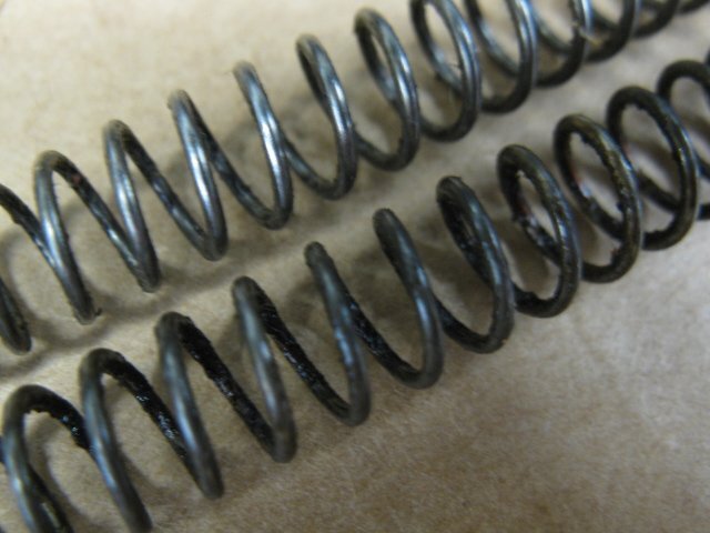

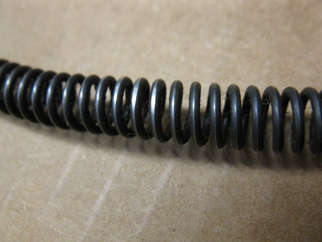

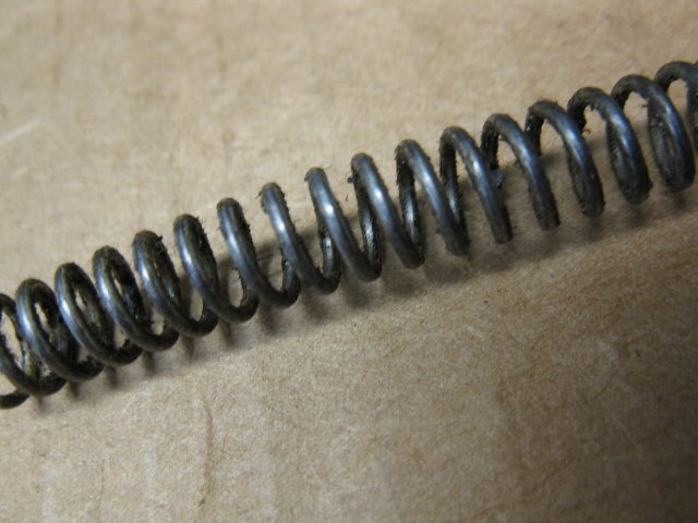

reconbob Posted March 4, 2024 Report Share Posted March 4, 2024 (edited) Had a guy in the shop looking for a recoil spring and said he was stumped because he was told that all coil springs never show wear, or something like that. So how was he to know if the spring he got was new or not? Detecting wear of coil springs is fairly obvious if you know what to look for. Coils start to get flattened and shiny. It's subtle, but it's there. The best way to check a Thompson recoil spring is to measure it. It should be 11 5/16" +/- 5/16". If it's too short or loo long it should be replaced. Here is a photo of a new and worn Thompson recoil spring. The new spring is on the bottom. You can see some of the coils on the used spring on top are starting to get flat spots and shiny. Garand - the worn coils are in the middle Browning Automatic Rifle - the worn/flattened coils are obvious A coil spring is just about always going to be harder than the parts surrounding it. such as when paired with a M1928A1 actuator which is not hardened. BUT, when paired with an M1/M1A1 bolt, the bolt is going to be very nearly as hard as the spring and you will get wear. (Well, you always get wear, it's just a matter of how long it takes.) Bob Edited March 4, 2024 by reconbob 2 1 Link to comment Share on other sites More sharing options...
