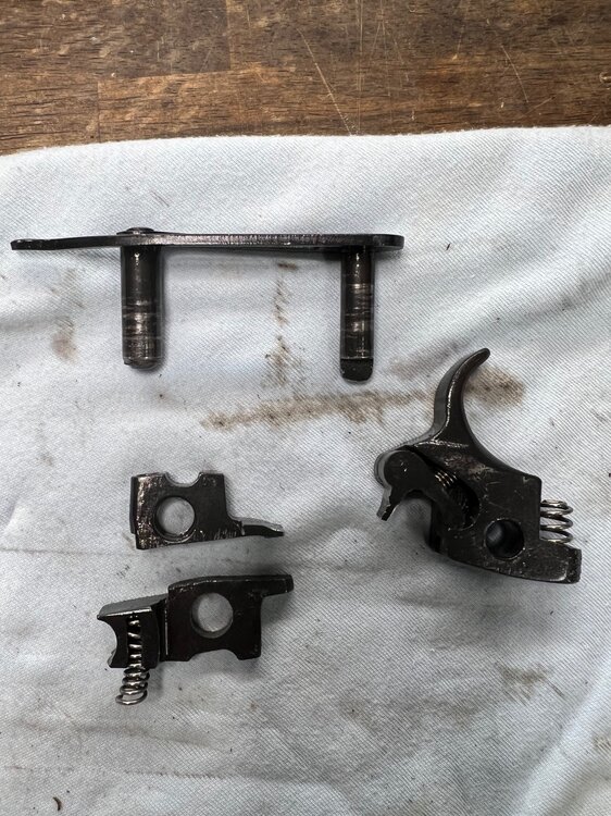

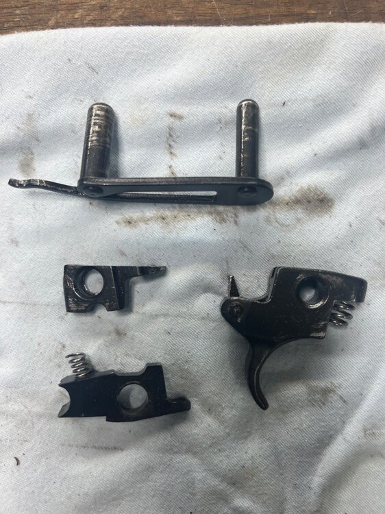

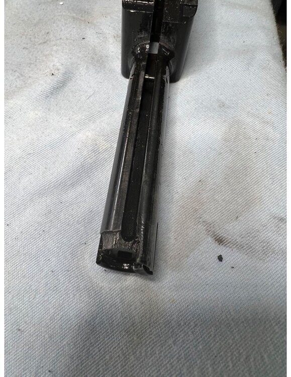

TtheD Posted October 2, 2024 Report Share Posted October 2, 2024 Hello all, Pretty new to the scene. I was "given" a 1974 4 digit Wes Hurley in pieces. I know I am missing a few pieces like the firing pin, and i think the sear is damaged. I have had a very difficult time finding reliable information. Anyone willing to look at a bunch pictures and try and point me in the right direction. my hope is to rebuild it but that might be past my skill level. Link to comment Share on other sites More sharing options...
TennesseeTimmy Posted October 2, 2024 Report Share Posted October 2, 2024 Maybe start with an exploded diagram in the manual: https://www.auto-ordnance.com/PDF/lg_manual.pdf Figure out what parts are missing or broken. Try Kahr and Numrich / Gunparts.com to see if they have them. See if anyone on here has any. Forum member jld3713 is making firing pins. Get in touch with forum member Deerslayer and get input / help from him. Keep us informed on your progress and good luck. Timmy Link to comment Share on other sites More sharing options...

TennesseeTimmy Posted October 2, 2024 Report Share Posted October 2, 2024 We need an expert to chime in / confirm, but I THINK that: 1. Many of the differences of above model #s are probably things like drum style frame vs. M1 frame vs. pistol frame, detachable stock, barrel length, etc. I don’t believe it’s related to serial #. 2. the parts you are missing appear to be from the “fire control group”, and 3. those parts may well be the same regardless of model. So, just put in a model number and then search. If you don’t get a result, put the next model number in and search again. I did not see the following items in your pictures: Disconnector, Pawl, Pawl Spring, Trip lever. Timmy. Link to comment Share on other sites More sharing options...

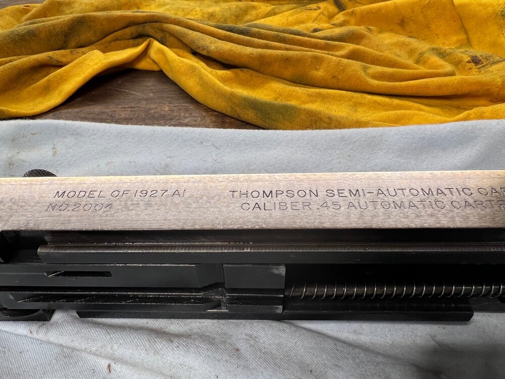

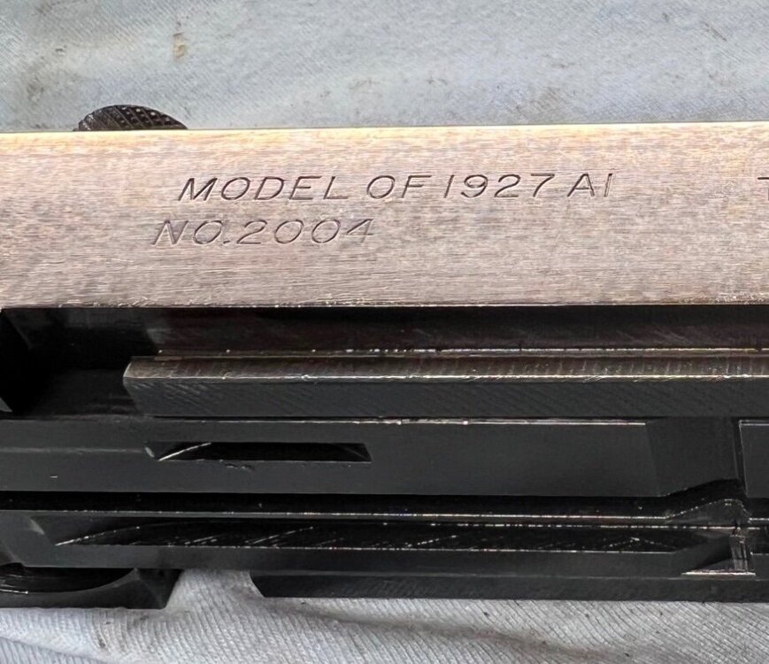

inertord Posted October 3, 2024 Report Share Posted October 3, 2024 12 hours ago, TtheD said: Thanks Tennessee Timmy, that manual helps. on Numrich part website they list models. How do I tell what model I have? and what is the differance 1927A-1 / 1927A-1C / 1927A-3 / 1927A-5 is it based on Serial number? From your receiver photo you have a 1927A1 Link to comment Share on other sites More sharing options...

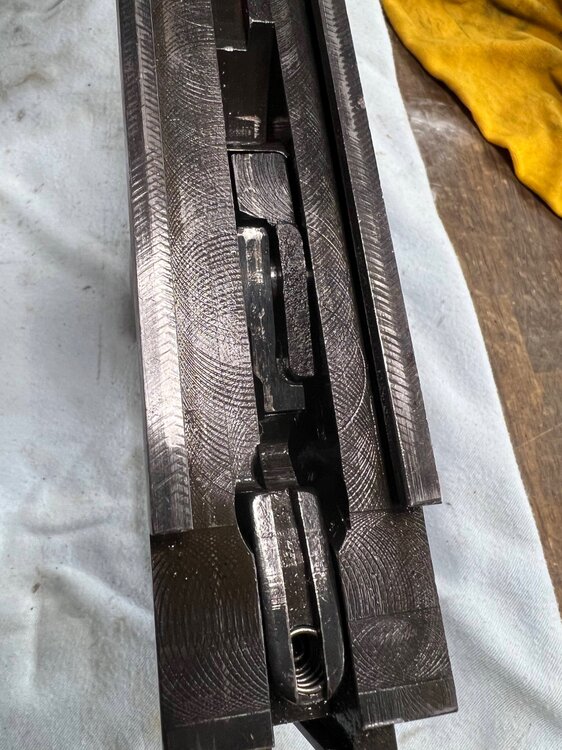

Bayrain Posted October 4, 2024 Report Share Posted October 4, 2024 On 10/2/2024 at 3:53 AM, TtheD said: Hello all, Pretty new to the scene. I was "given" a 1974 4 digit Wes Hurley in pieces. I know I am missing a few pieces like the firing pin, and i think the sear is damaged. I have had a very difficult time finding reliable information. Anyone willing to look at a bunch pictures and try and point me in the right direction. my hope is to rebuild it but that might be past my skill level. Yeah rebuilding from Semi auto parts will be difficult. That BCG looks like it had a part snap off, along with some of those other components. I had a West Hurley parts kit I bought for situations just like this and have the extra parts. But I mean I wouldn't mind getting another Tommy gun either if ya gonna get rid of it lol. But Auto Orndnance does stock some parts such as a firing pin and some trigger pieces. It's just a very complicated lego, mostly because it's a Striker fired closed bolt system. Hope the rebuild goes well. Link to comment Share on other sites More sharing options...

68coupe Posted October 4, 2024 Report Share Posted October 4, 2024 To put my earlier reply into other words that are hopefully less confusing. The bolt from a Kahr will fit into a WH, but a Kahr firing pin must be used. The other parts, such as springs and buffer/spring pilot assembly, are interchangeable. All of the parts in the lower are interchangeable, though some may require minor fitting, as is true with all firearm parts. V/R Karl, 68coupe Link to comment Share on other sites More sharing options...

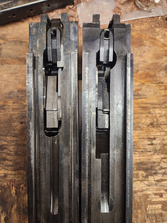

deerslayer Posted October 4, 2024 Report Share Posted October 4, 2024 You have an early gun. Compare these photos. To put in a new made trigger group it will be necessary to do some milling on the trigger frame. Link to comment Share on other sites More sharing options...

Bayrain Posted October 6, 2024 Report Share Posted October 6, 2024 On 10/4/2024 at 2:10 PM, deerslayer said: You have an early gun. Compare these photos. To put in a new made trigger group it will be necessary to do some milling on the trigger frame. I didn't have to swap parts on my West hurley M1A1 lower to put it on my Kahr arms reicever. I can see the clear differences though between the AO and WH lowers though Link to comment Share on other sites More sharing options...
