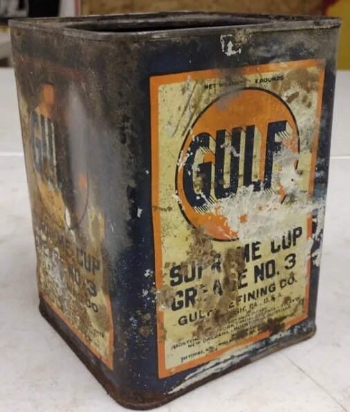

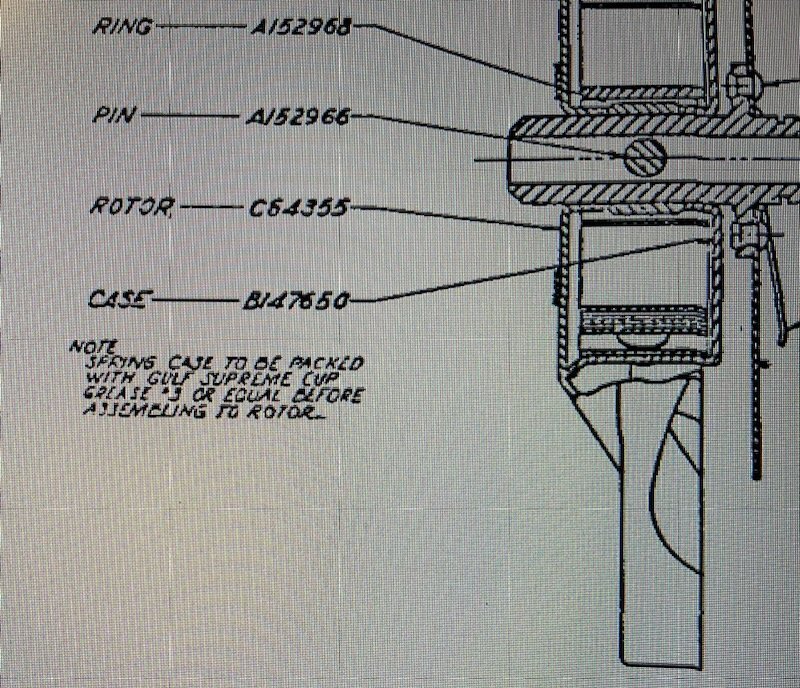

Sterling Thompson Posted March 19, 2024 Report Share Posted March 19, 2024 Hello Mr. Quaid, On the copy of machinist drawings I have number D6535504 titled "Rotor Assembly" there is a note that states in all capitol letters quote, "SPRING CASE TO BE PACKED WITH GULF SUPREME CUP GREASE #3 OR EQUAL BEFORE ASSEMBLING TO ROTOR." This was done after the rotor spring was riveted to the rotor spring case and the hub pin was staked. I hope that this will clarify your concerns as to if this was done originally. Sterling Thompson 5 Link to comment Share on other sites More sharing options...

Merry Ploughboy Posted March 20, 2024 Report Share Posted March 20, 2024 I'd guess that the rotor shafts were initially greased and at some point in time it became apparent that oiling was sufficient. In a similar vein, rotors were initially nickel plated and at some point in time it became apparent that bluing was sufficient. MHO, YMMV, etc. Link to comment Share on other sites More sharing options...
TD. Posted March 20, 2024 Report Share Posted March 20, 2024 Sterling Thompson, Welcome to the Thompson forum. Wow! That is a great first post! And answers a lot of questions. +1 from me. I do know the Thompson guns were to be coated with "sperm oil" prior to shipment to Great Britain and abroad - see pages 47 & 48 in, Great Britian - The Tommy Gun Story. Link to comment Share on other sites More sharing options...

reconbob Posted March 21, 2024 Report Share Posted March 21, 2024 Yes, great post on the grease #3. It’s interesting that this topic was beat to death years back, somebody was making and selling drum greaser fittings, etc. and nobody found or noticed that note on the ordnance drawing. Bob Link to comment Share on other sites More sharing options...
