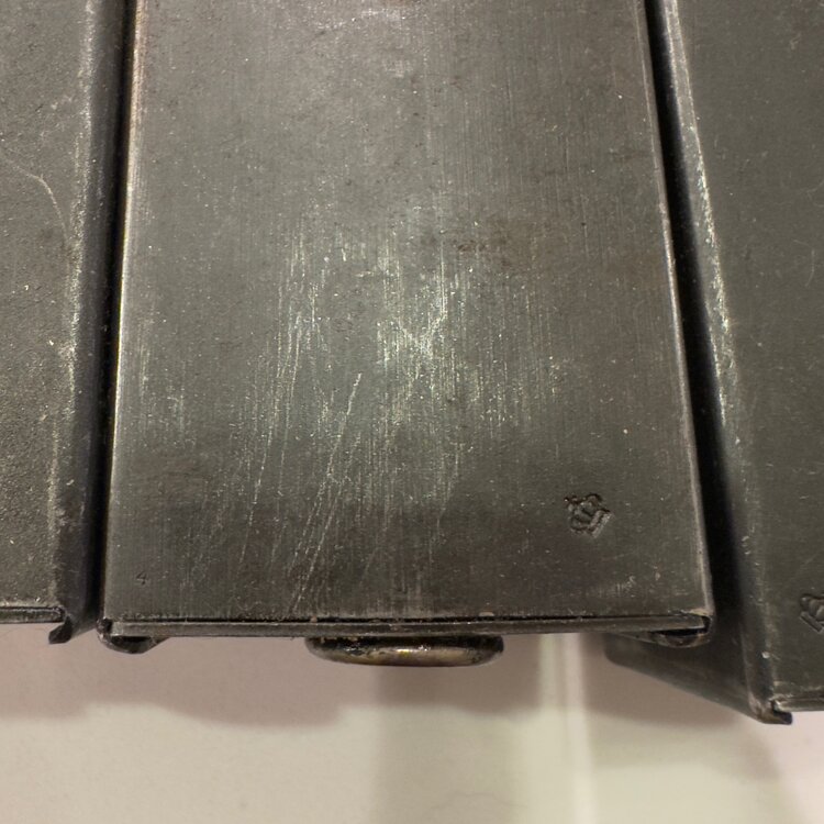

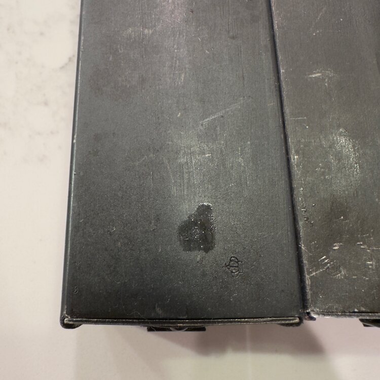

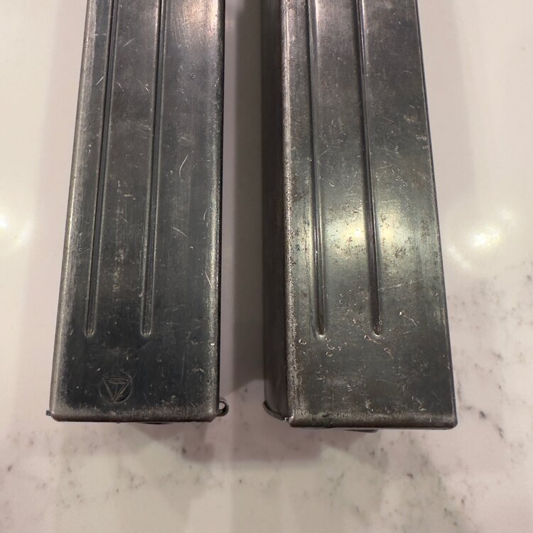

deerslayer Posted March 26, 2024 Author Report Share Posted March 26, 2024 I have some of these with the two different stampings. And ive seen pictures with like a circle "T" . Any mag experts able to give a brief rundown on how many countries might have manufactured these and the markings they used? Link to comment Share on other sites More sharing options...
RoscoeTurner Posted March 26, 2024 Report Share Posted March 26, 2024 The top one with the crown is Swedish and I am pretty sure the bottom one is as well. Been I a long time since I dealt with those. Link to comment Share on other sites More sharing options...
Rekraps Posted March 28, 2024 Report Share Posted March 28, 2024 On 3/26/2024 at 1:34 PM, deerslayer said: I have some of these with the two different stampings. And ive seen pictures with like a circle "T" . Any mag experts able to give a brief rundown on how many countries might have manufactured these and the markings they used? Agree, the crown gives it away. I bet the other stamp is the actual location of mfg or plant code. Link to comment Share on other sites More sharing options...

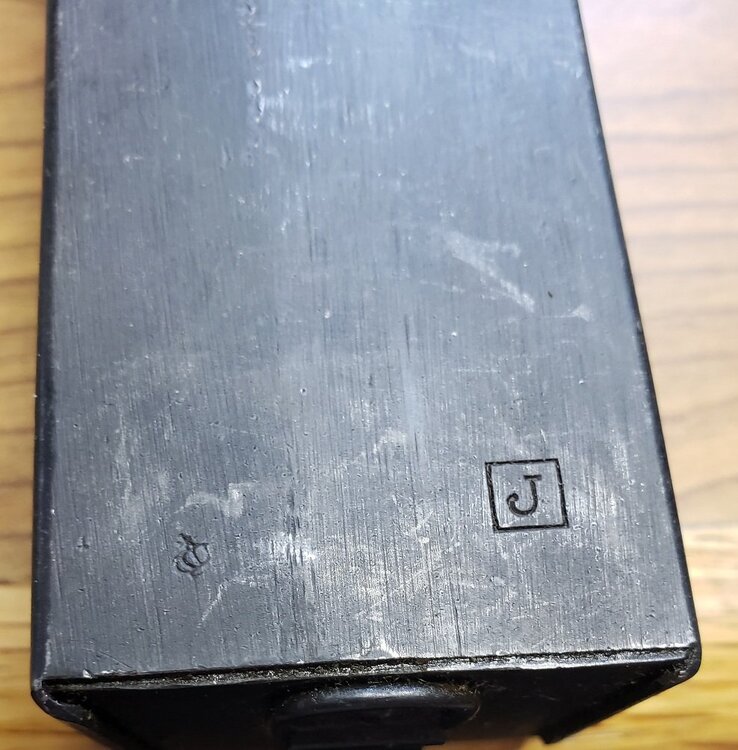

Rekraps Posted March 28, 2024 Report Share Posted March 28, 2024 I just pulled the 5 units I have, three are unmarked (Finnish) and two are Crown (Swedish) with one of the two having a "J" in a box in addition to the crown mark. thanks for bringing this topic up, I have two "K's" one Crown on Wilson and the other Port Said on Wilson, so the Crown coffin mags will match the Crown K. Link to comment Share on other sites More sharing options...

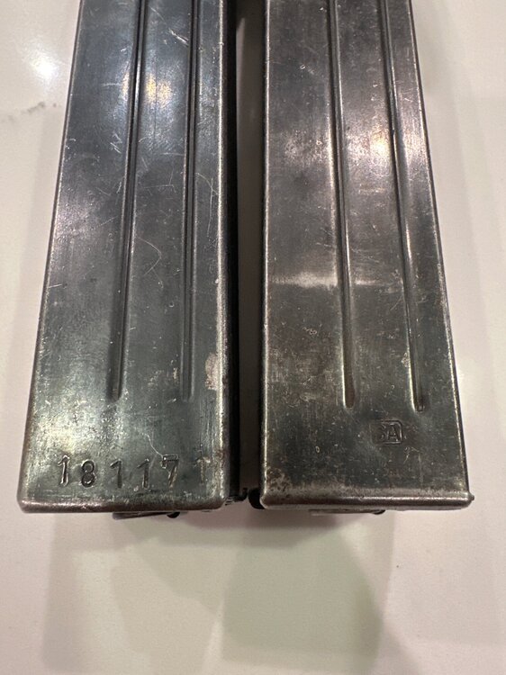

StrangeRanger Posted March 29, 2024 Report Share Posted March 29, 2024 Shouldn't the Finnish mags be marked with an SA in a square meaning Finnish Army (Suomen Armeija if Google translate can be believed) Link to comment Share on other sites More sharing options...
Rekraps Posted March 29, 2024 Report Share Posted March 29, 2024 11 hours ago, StrangeRanger said: Shouldn't the Finnish mags be marked with an SA in a square meaning Finnish Army (Suomen Armeija if Google translate can be believed) Good point, however the similarity of the mags (they are identical in finish and construction) leads me to believe they are Finnish, but..... Link to comment Share on other sites More sharing options...
JJX Posted March 29, 2024 Report Share Posted March 29, 2024 Does the crown indicate that it was made in Sweden or just owned by the Swedish gov? Link to comment Share on other sites More sharing options...
Rekraps Posted March 30, 2024 Report Share Posted March 30, 2024 21 hours ago, JJX said: Does the crown indicate that it was made in Sweden or just owned by the Swedish gov? The Crown is a production stamp... so yes, made in Sweden. Link to comment Share on other sites More sharing options...

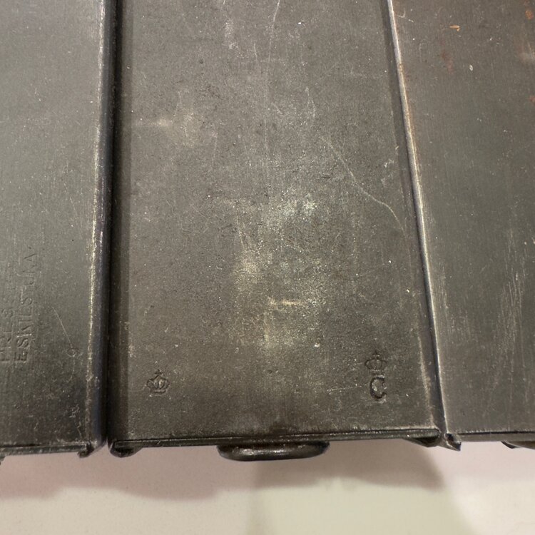

USMCsean Posted June 9, 2025 Report Share Posted June 9, 2025 Tilted crowns are Husqvarna made products. Normal looking crowns are Carl Gustafs made products. I can make a posting on some, if not all, the Swedish made variants and the Finnish made examples in a day or so. Link to comment Share on other sites More sharing options...

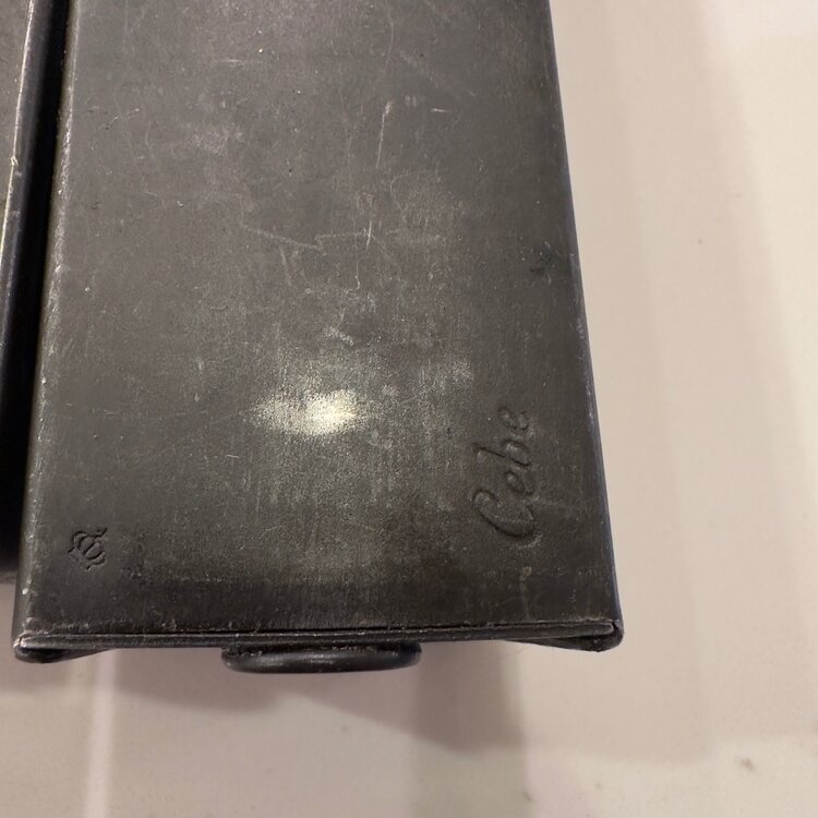

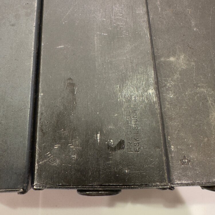

USMCsean Posted June 11, 2025 Report Share Posted June 11, 2025 Finnish Made Tikkakoski Oy, most often shortened to Tikka, is on the left. Unmarked on the right. You’ll sometimes see them with the boxed SA marking. And also marked with the serial number of the Kp31 SMG they were issued with. Swedish Made Carl Gustafs - crown laid flat Pressbol Eskilstuna - marked as such vertically along the right side. Subcontracted to produce them for Husqvarna. Husqvarna acceptance mark (tilted crown) on the left. Carl Gustafs - marked with a single, upright crown on the left and also a crown over the letter C on the right. Husqvarna - marked with the tilted crown on the right rear corner. Cebe - marked as such vertically along the right side. Subcontracted to produce them for Husqvarna. Cebe was a light fixture making company based in Sweden that started in the 1890s making lights and light fixtures. One would assume the gained a lot of experience with working with pressing sheet metal. Husqvarna acceptance mark (tilted crown) on the left. Not pictured - going from memory. There was a subcontractor, whom I haven’t been able to identify, that had a marking that was the capital letter J inside a shape. Shapes I have seen were: J in a square, J in a circle, J in a triangle Link to comment Share on other sites More sharing options...

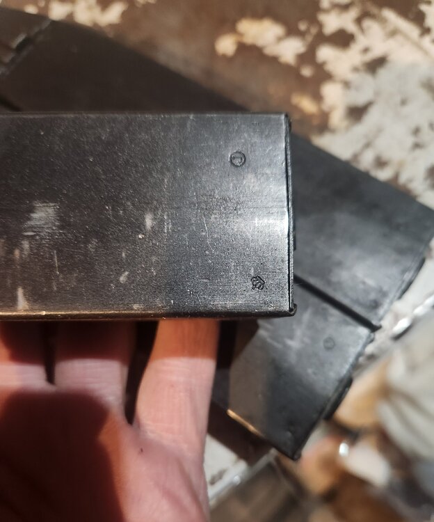

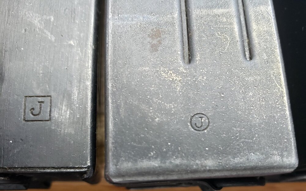

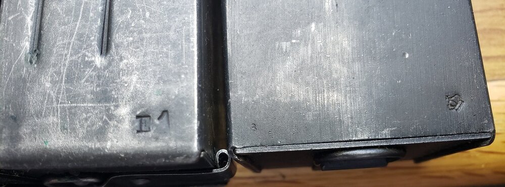

Lewisfan Posted June 11, 2025 Report Share Posted June 11, 2025 Great info. Thank you. Made me dig out my coffin mags to check. I've got 2 of the "Pressbol" variants, 2 of the square box "J" mags, 2 of the Husqvarna "tilted crown", and two "Cebe". Of possible interest one of the "Cebe" mags has "E1" stamped on the right side. The other Cebe does not. Also, the "tilted crown" Husqvarna mags both have "J" in a circle on the left side. Thanks again. Link to comment Share on other sites More sharing options...
