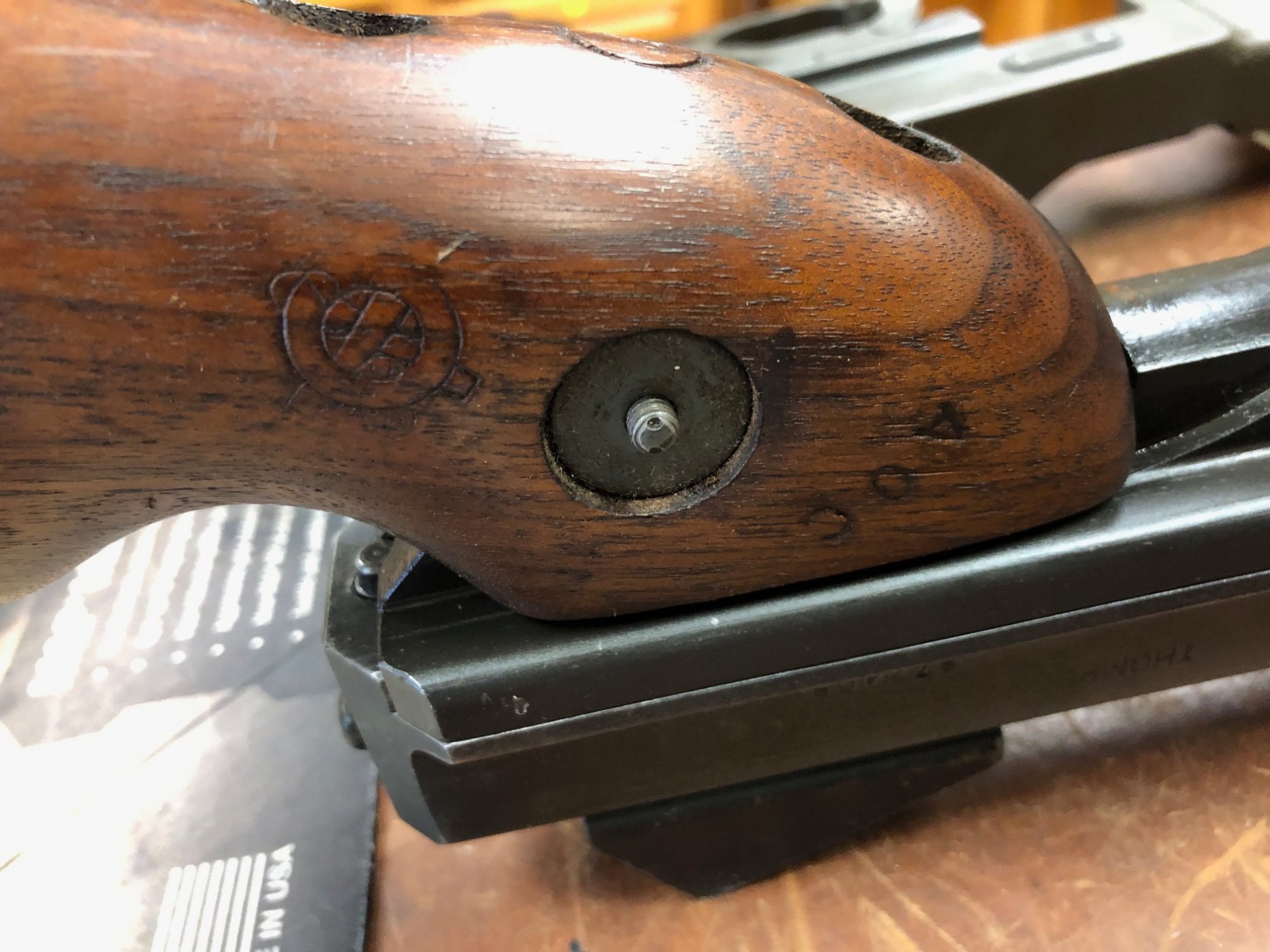

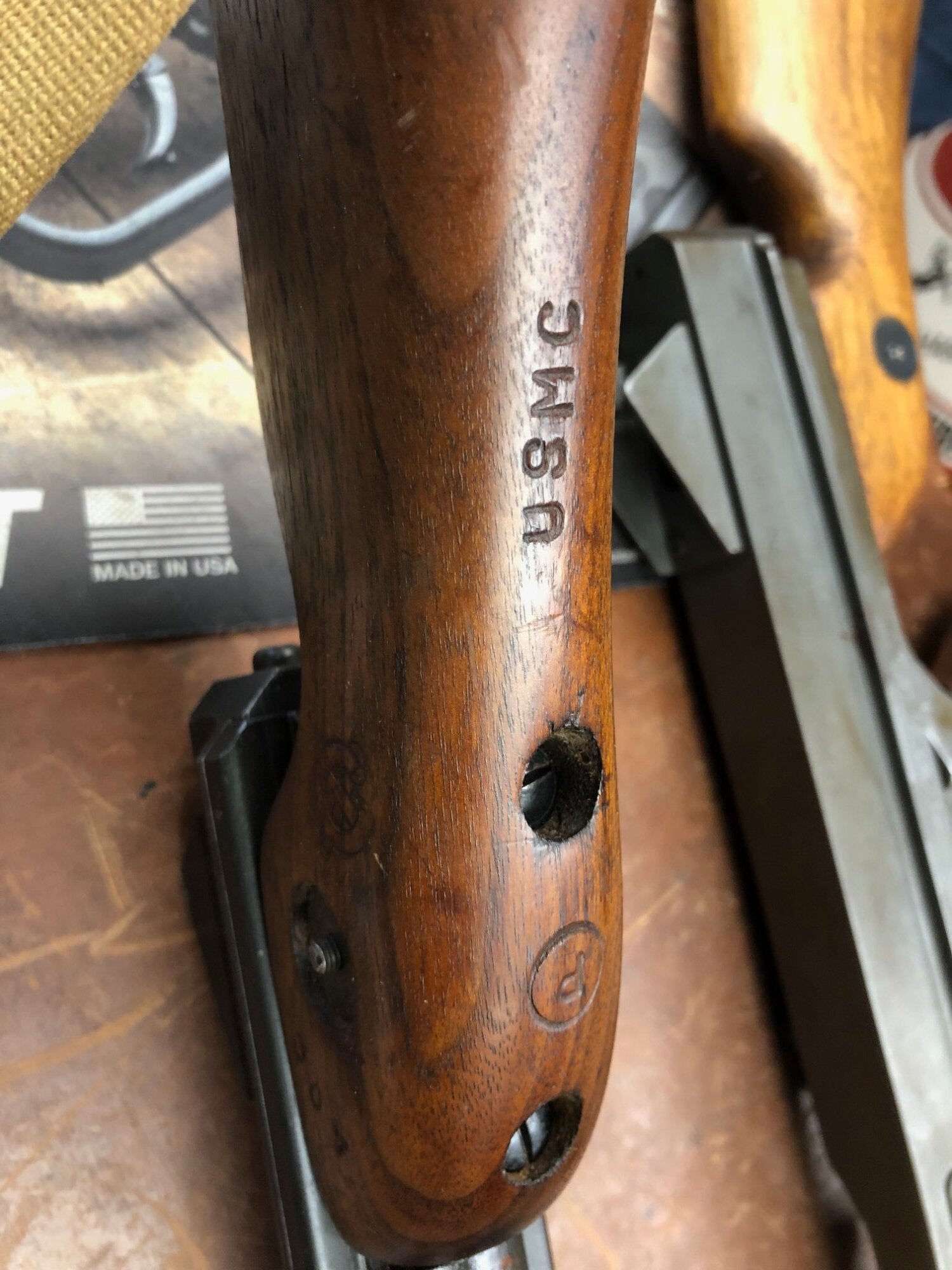

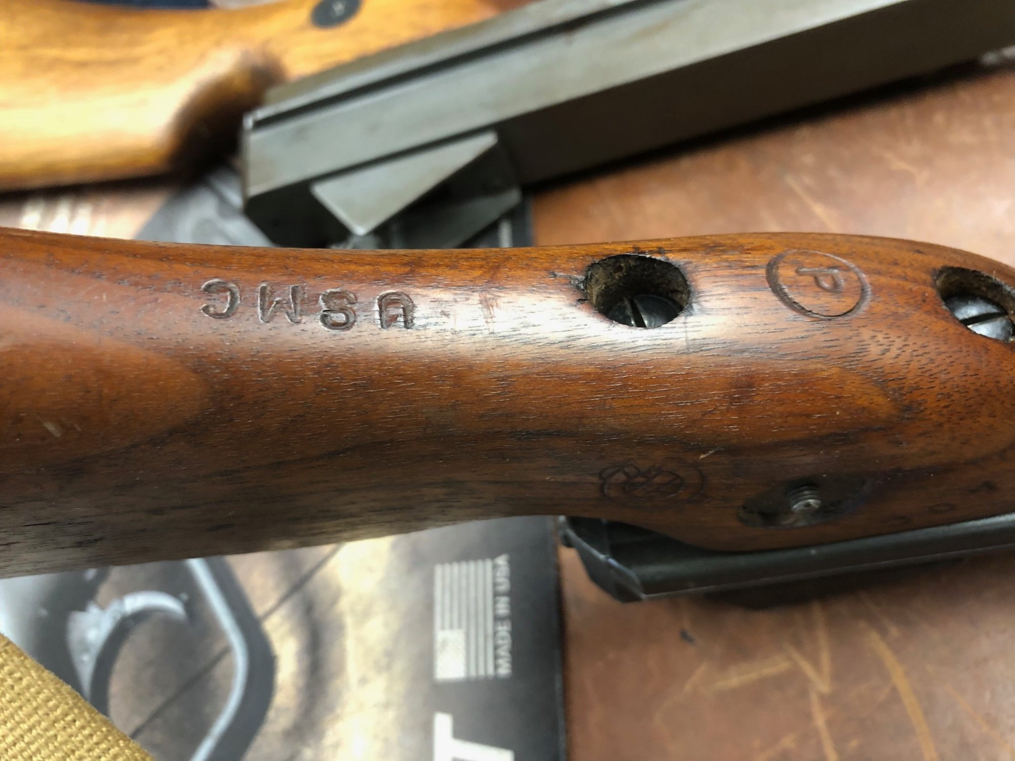

ebeeby Posted March 29, 2024 Report Share Posted March 29, 2024 Anyone ever see these cartouches on an M1A1 stock? Link to comment Share on other sites More sharing options...
Got Uzi Posted March 29, 2024 Report Share Posted March 29, 2024 “p” is proof tested “AOC” is Auto Ordnance Corp crossed cannons rebuild mark USMC wasn’t a normal mark like that (least that I’m aware of) Is there anything marked on the receiver? Is it an AOC or a Savage? Link to comment Share on other sites More sharing options...
Doug Quaid Posted March 30, 2024 Report Share Posted March 30, 2024 Those stamps look extremely fake to me. I used to be a rabid Garand collector, I had about 25 of them. And I can tell you that fake stamping is literally a cottage industry with those rifles. It has completely run amok, 75% of the stamps you see now are fake. It's really a shame because the collectors and sleazy dealers are ruining the originality of stocks by applying these new stamps. There are 20,000 sets of fake Garand inspection stamps floating around and someone "dressed up" your stock with a selection of them. See how the wood fibers are all crushed and the impression is super deep, like Hercules hit the stamp with a hammer? If those stamps were genuine, they wouldn't look anything like that. They would look 70 years old if they were real. Stamps fade out over time. I've seen real ones where all that was left on the wood is just staining. At least it wasn't fake SS stamps. https://www.sarcoinc.com/u-s-crossed-cannon-metal-hand-stamp/ Also, FYI, those are "inspectors stamps", not cartouches. A cartouche is a decoration, like when old military rifles would have the manufacturer's name or the king's name stamped in a fancy design. Link to comment Share on other sites More sharing options...
TSMGguy Posted March 30, 2024 Report Share Posted March 30, 2024 (edited) All fake. There were no original external markings on the M1A1 TSMG butt stock. Edited March 31, 2024 by TSMGguy Link to comment Share on other sites More sharing options...

reconbob Posted April 7, 2024 Report Share Posted April 7, 2024 Many years ago I was requested to put a PD marking on a Win M97 stock. Nothing nefarious - they just wanted the gun to be identified as their property. And DQ is right. When stocks are new fresh wood, the wood is soft and easily marked/impressed by the stamps. But 30+ years later the wood has dried out, seasoned, etc. And when you stamp it the stamp does not make as deep an impression and the wood fibers, now brittle, break and stick up. Once you see it you don’t forget it. And the USMC stamp is not stamped - it looks like it was done with a router. Bob Link to comment Share on other sites More sharing options...

Doug Quaid Posted April 9, 2024 Report Share Posted April 9, 2024 And the worst part is - Suppose there is a nice Winchester Garand with an original Winchester stock that some WWII GI got soaking wet and then polished and linseed oiled until the inspector's stamps were practically gone. And then some greasy weasel comes along and festoons a set of fake stamps on into it. Now it's a ruined stock. Not an improved stock, not a restored stock, not a "freshened up" stock, but a RUINED stock. Look at the OP's Thompson stock, it's ruined. Link to comment Share on other sites More sharing options...
