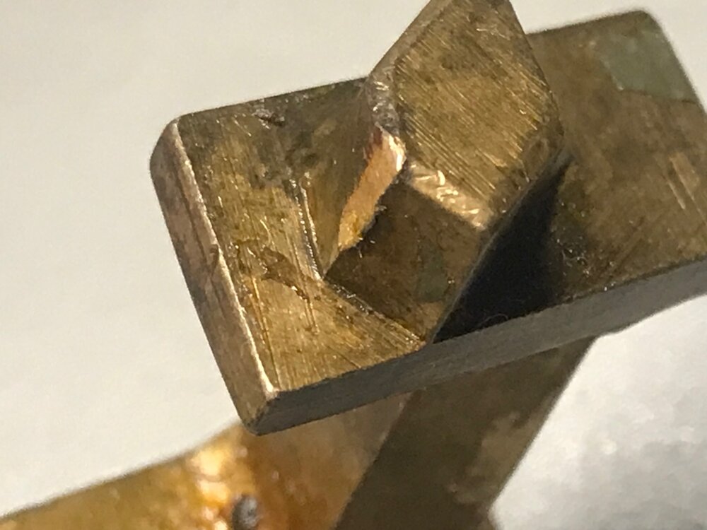

Hiller Posted April 7, 2024 Report Share Posted April 7, 2024 This Blish I bought was advertised as nos. It looks used to me. Am I crazy? Please advise, R/s, Hiller……….. Link to comment Share on other sites More sharing options...
Rekraps Posted April 7, 2024 Report Share Posted April 7, 2024 Actually, it looks like a NOS cosmolined up blish. Clean that baby up and I bet it works just fine. Link to comment Share on other sites More sharing options...

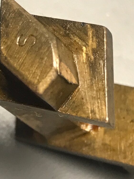

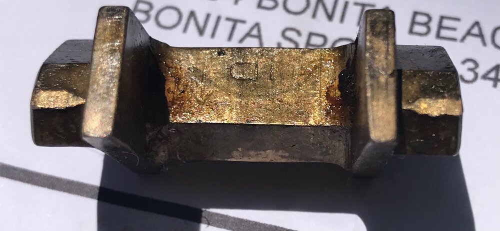

Hiller Posted April 7, 2024 Author Report Share Posted April 7, 2024 (edited) You don’t see the wear on the right and left ears from use? I’m not questioning if it will work. I have several others with the Same wear pattern. It looks like it has already been working and not new was my question. R/s, Hiller……… Edited April 7, 2024 by Hiller Ad pics Link to comment Share on other sites More sharing options...
reconbob Posted April 8, 2024 Report Share Posted April 8, 2024 Yes, that is a used blish lock. I would also say that the wear rises to the level of damage vs. normal wear. In a properly functioning gun you don’t see wear like that. A lot of people sell used parts as new either because they are dishonest or because they don’t know the difference. There was a breech oiler listed as MINT/NOS up on GB for the longest time and the felt was worn and dirty and the bluing was 50% gone and you could see the ring shaped wear marks where the buffer hits. Really at a glance you knew it was not MINT, but there it was. You have to be careful with cosmoline. I bought some NOS mag catches from a reputable seller, they were packed in little zip lock bags and all gunked up so I just put them in the bin. Months later when i degreased them to use them they were all badly pitted. I am sure the seller did not know and was duped by whoever he got them from. Bob 2 Link to comment Share on other sites More sharing options...
Motorcar Posted April 8, 2024 Report Share Posted April 8, 2024 Yes to what Bob said, also may have been run in a West Hurley that has the slots cut at the wrong angle. Link to comment Share on other sites More sharing options...
Hiller Posted April 8, 2024 Author Report Share Posted April 8, 2024 Thanx for conformation. Sell er probably doesn't look at the parts he sells with any care. Guess it could happen to anyone if they arn't paying attention. R/s, Hiller...................... Link to comment Share on other sites More sharing options...
