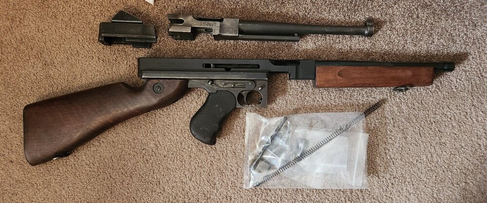

p51 Posted June 6, 2024 Report Share Posted June 6, 2024 (edited) I have an Indianapolis Ordnance M1A1 BFONG kit that I handed over to a local gunsmith but he's stumped on how to rivet the rear sights in place. Any ideas? He says he'd essentially need an actual set of tools for a Thompson to complete this. It's stopped the project for now. Edited June 6, 2024 by p51 Link to comment Share on other sites More sharing options...
TennesseeTaylor95 Posted June 6, 2024 Report Share Posted June 6, 2024 (edited) I'm still a novice so I could be off in left field here but I thought that riveting a rear sight on a TSMG was a relatively easy thing to do considering you have the correct rivets and a bucking bar/anvil (assuming that you're just going to set the rivets by hand with a punch, which isn't technically correct for a production gun but does get the job done in the grand scheme of things). Having no first hand experience with the Indianapolis Ordnance M1A1 BFONG, I don't know if they have the same countersunk rivet holes for the rivet heads to stay in without protruding into the bolt pocket or not. Assuming the rear sight rivet holes are countersunk and you have the correct countersunk rivets, then it should be as simple as inserting the rivets from the inside of the receiver, place a bucking bar/anvil in the bolt pocket to support the rivets, install the rear sight on the 4 rivets sticking through the top of the receiver, and then proceed to rivet the rear sight one rivet at a time. Do you have any pictures of the bolt pocket where the rear sight rivet holes are? Edited June 6, 2024 by TennesseeTaylor95 Info added 1 Link to comment Share on other sites More sharing options...
p51 Posted June 12, 2024 Author Report Share Posted June 12, 2024 The gunsmith has the gun right now and he's officially given up on any way to rivet the rear sights in place. The only gunsmith he's found anywhere who will take it on in the US is a guy in New York state and other than California, that's the last place I wanna send this. My guy here says he can't drill and tap those holes because there's nit enough metal to guarantee that they won't wear through with the rattling of use. Had I known it would be this tough, I doubt I'd have bought this stupid thing. Link to comment Share on other sites More sharing options...

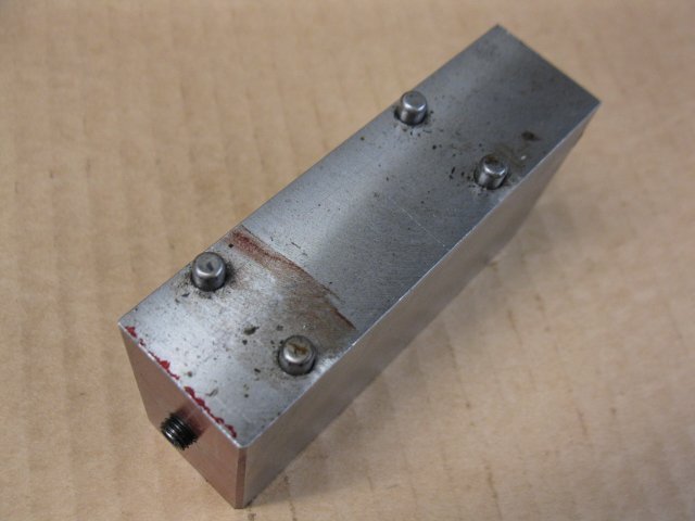

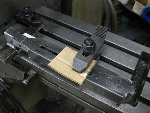

reconbob Posted June 24, 2024 Report Share Posted June 24, 2024 I just riveted a rear sight and figured I's post pictures of the setup. It's low tech. but there is really no other way. The receiver is clamped down on top of a special anvil so all 4 rivets are held solid and there is no looseness or vibration when the rivets are stuck. Clamped to the table of one of the milling machines as even a sturdy workbench would not be solid enough. This is the anvil with hardened dowel pins properly spaced to engage the heads of all 4 rivets. The set screw at the back is adjusted so when it is against the rear wall of the bolt pocket the anvil is in position. The width of the anvil is the same as a bolt - a tight sliding fit in the receiver. I use a heavy duty starting punch with the tip ground convex to flare the heads when struck. I use a 2 lb. hammer and do 4 strikes in a 4 leaf clover pattern. Bob 4 1 Link to comment Share on other sites More sharing options...
