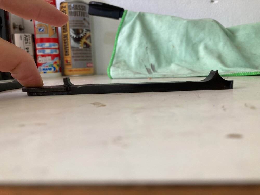

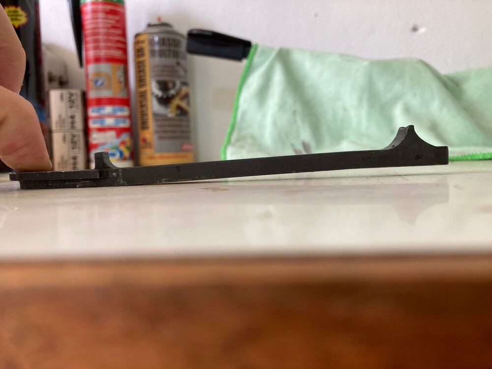

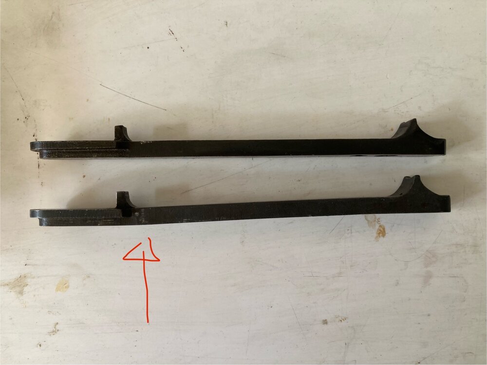

Mk1992 Posted June 19, 2024 Report Share Posted June 19, 2024 Hello to everyone, I need your opinion about these two original grip mounts. In particular I need your opinion about the grip mount at the bottom, compared to the one at the top is too curved... the one at the top it's perfectly straight. Maybe the one at the bottom was it ruined? Was it bent on purpose or by accident? Or simply it's 100% normal, maybe especially made for finned barrels. The one at the bottom have a marking like a square S. Thanks !!!! Link to comment Share on other sites More sharing options...
Rekraps Posted June 19, 2024 Report Share Posted June 19, 2024 Let's see if my $0.02 is even close to correct. The bent one is, well, bent. I didn't spend 5 years in the fourth grade for nothing! 2 Link to comment Share on other sites More sharing options...
spall Posted June 19, 2024 Report Share Posted June 19, 2024 Savage grip hanger, likely bent in service. Don't see why straightening with some soft jaws and a lead hammer wouldn't work. Link to comment Share on other sites More sharing options...
StrangeRanger Posted June 19, 2024 Report Share Posted June 19, 2024 The square S means Stevens, Savage is a rounded S. It looks like it's got 2 bends one bending upwards just in front of the retaining lug and another bending downwards father forward just behind the lug that contacts the barrel Those grip mounts are heat treated alloy steel. I don't have a clue how you would go about bending one (or unbending) one. Once bent there is a possibility that straightening it could cause it to break. I suspect that you have a paperweight Link to comment Share on other sites More sharing options...
reconbob Posted June 19, 2024 Report Share Posted June 19, 2024 The bent one is correct. The idea is that the grip mount flexes/presses against the barrel for a secure mounting of the forend. A while back before he passed away Doug Richardson made a special vise for fitting/removing barrels that had built into it a device to retract the grip mount so it did not make a spiral scratch on the barrel when you screw it in or out. That being said, the flat one is certainly original and for whatever reason is not bent. I just looked at ordnance drawing #6147676 and there is no note that the grip mount is to be bent. Interesting. Bob 2 1 Link to comment Share on other sites More sharing options...
TD. Posted June 20, 2024 Report Share Posted June 20, 2024 +1 for reconbob. He knows his Thompson parts! Did a company in the past make a run of grip mounts with the bend in the wrong direction? I seem to recall something about this several years ago. Link to comment Share on other sites More sharing options...
StrangeRanger Posted June 20, 2024 Report Share Posted June 20, 2024 I'm a little confused. The retaining lug on the grip mount in my M1 TSMG broke a few years ago and we replaced it with one from Waffenmeisters. IIRC the broken one was S marked which matched the receiver. Both the one that came out and the one we replaced it with were flat and in both cases the front lug was tight against the barrel. What am I missing? Link to comment Share on other sites More sharing options...
Mk1992 Posted June 20, 2024 Author Report Share Posted June 20, 2024 If I mount the model bent at the bottom I don’t know how I can screw the finned barrel. In my opinion, it’s too bent. Maybe this curve was made because the frontal part who touch the barrel it must rest between the two barrel fins, correct? Link to comment Share on other sites More sharing options...

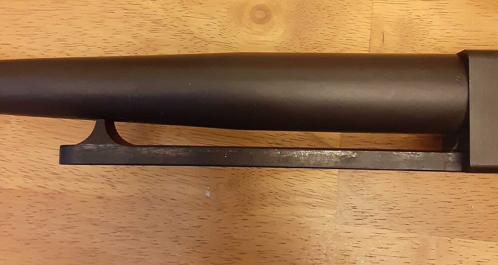

StrangeRanger Posted June 20, 2024 Report Share Posted June 20, 2024 (edited) Here's mine and as installed it appears to be sprung slightly downwards due to contact pressure with the barrel. The last thing it would need is to be bent upwards Edited June 20, 2024 by StrangeRanger added info Link to comment Share on other sites More sharing options...
StrangeRanger Posted June 20, 2024 Report Share Posted June 20, 2024 8 hours ago, Mk1992 said: If I mount the model bent at the bottom I don’t know how I can screw the finned barrel. In my opinion, it’s too bent. Maybe this curve was made because the frontal part who touch the barrel it must rest between the two barrel fins, correct? With a correctly machined barrel the front lug touches the fins, it does not fit between them Link to comment Share on other sites More sharing options...
PK. Posted June 20, 2024 Report Share Posted June 20, 2024 The Early AO drawing notes the following, with an arrow pointing to teh bottom below the retaining lug "Bend grip here before heat treating to throw forward end up .10" to insure firm seating against barrel" In my opinion, based upon observation, all Colt made parts had the bend, as did parts in all 1928 guns. I think the bend in the milled parts was likely eliminated with the M1, and the subsequent multi part assembled grips mounts did not have the bend. 2 3 Link to comment Share on other sites More sharing options...
Rekraps Posted June 20, 2024 Report Share Posted June 20, 2024 2 hours ago, StrangeRanger said: Here's mine and as installed it appears to be sprung slightly downwards due to contact pressure with the barrel. The last thing it would need is to be bent upwards I too am confused guys. are these to be bent, or not bent. Link to comment Share on other sites More sharing options...
Rekraps Posted June 20, 2024 Report Share Posted June 20, 2024 55 minutes ago, PK. said: The Early AO drawing notes the following, with an arrow pointing to teh bottom below the retaining lug "Bend grip here before heat treating to throw forward end up .10" to insure firm seating against barrel" In my opinion, based upon observation, all Colt made parts had the bend, as did parts in all 1928 guns. I think the bend in the milled parts was likely eliminated with the M1, and the subsequent multi part assembled grips mounts did not have the bend. Gotcha, I'm taking my 1928 AO apart and will look at it today. Link to comment Share on other sites More sharing options...

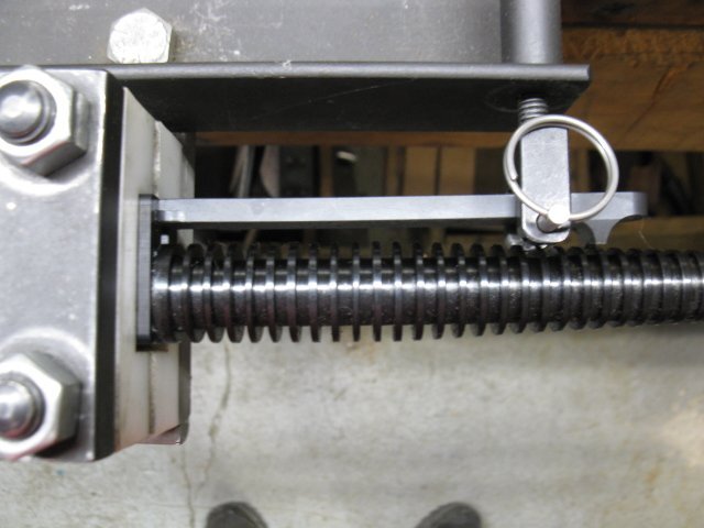

reconbob Posted June 20, 2024 Report Share Posted June 20, 2024 This is Doug's barrel/receiver vise showing the retractor for the grip mount. In absence of one of these you can get the barrel partly screwed in then press a wood carpentry wedge between the barrel and the grip mount and wind together with the barrel as you screw it in to keep the tip of the grip mount from scarring the barrel. Bob Link to comment Share on other sites More sharing options...

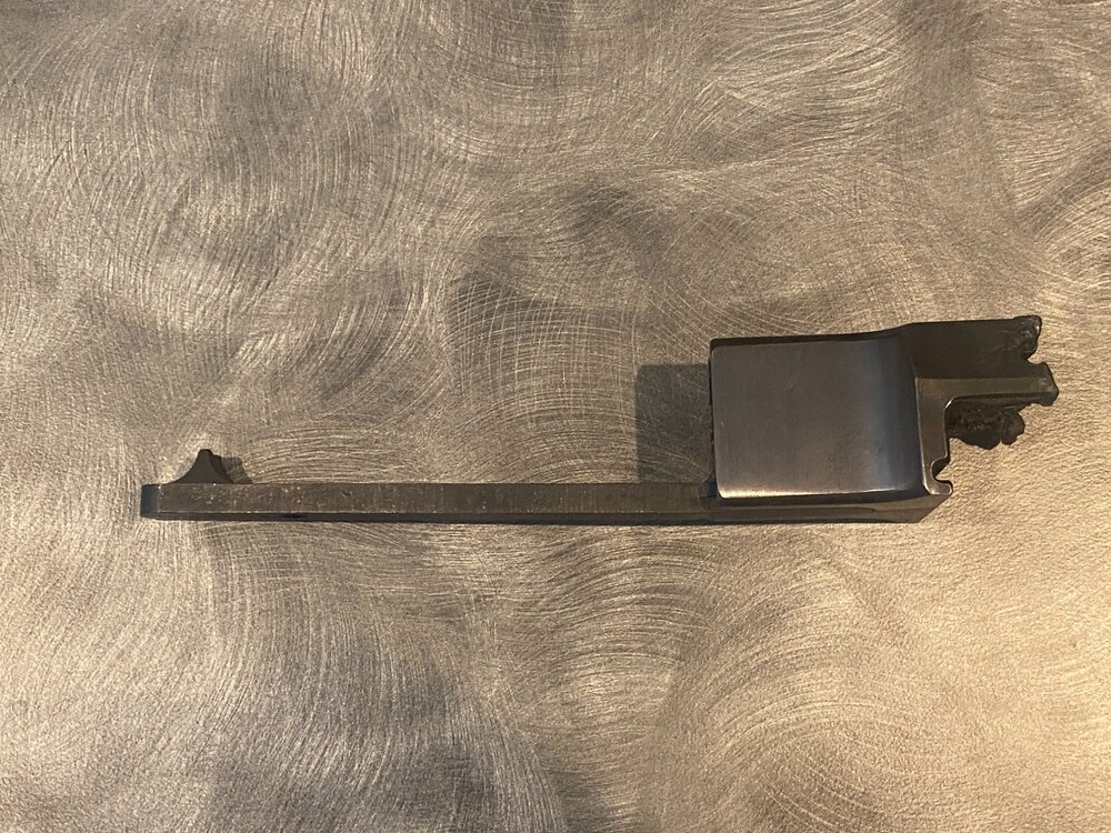

Rekraps Posted June 20, 2024 Report Share Posted June 20, 2024 (edited) On 6/19/2024 at 3:42 PM, Mk1992 said: Hello to everyone, I need your opinion about these two original grip mounts. In particular I need your opinion about the grip mount at the bottom, compared to the one at the top is too curved... the one at the top it's perfectly straight. Maybe the one at the bottom was it ruined? Was it bent on purpose or by accident? Or simply it's 100% normal, maybe especially made for finned barrels. The one at the bottom have a marking like a square S. Thanks !!!! So guess what! See the pics of my 1928 AOC OEM gun rail. Same bend, right at the 2" mark. Edited January 25, 2025 by Rekraps Link to comment Share on other sites More sharing options...
Rekraps Posted June 20, 2024 Report Share Posted June 20, 2024 6 hours ago, StrangeRanger said: With a correctly machined barrel the front lug touches the fins, it does not fit between them Exactly how my sits. See the pics above. Link to comment Share on other sites More sharing options...
Mk1992 Posted June 20, 2024 Author Report Share Posted June 20, 2024 7 hours ago, StrangeRanger said: Here's mine and as installed it appears to be sprung slightly downwards due to contact pressure with the barrel. The last thing it would need is to be bent upwards Exact, I agree with you, I can't understand why mine is bent so high, I don't even think I would be able to screw the barrel in, you would have to bend it really hard downwards to screw it in. What I think happened, it was intentionally bent upwards by someone during or after the war to fit some other barrels or put the angle between the fins... Link to comment Share on other sites More sharing options...
Colt Chopper Posted June 20, 2024 Report Share Posted June 20, 2024 When replacing the barrel, using the Richardson tool, the grip mount bar flexes more than you could really ever imagine. The first time I saw it done I was stressed that it would break. Link to comment Share on other sites More sharing options...

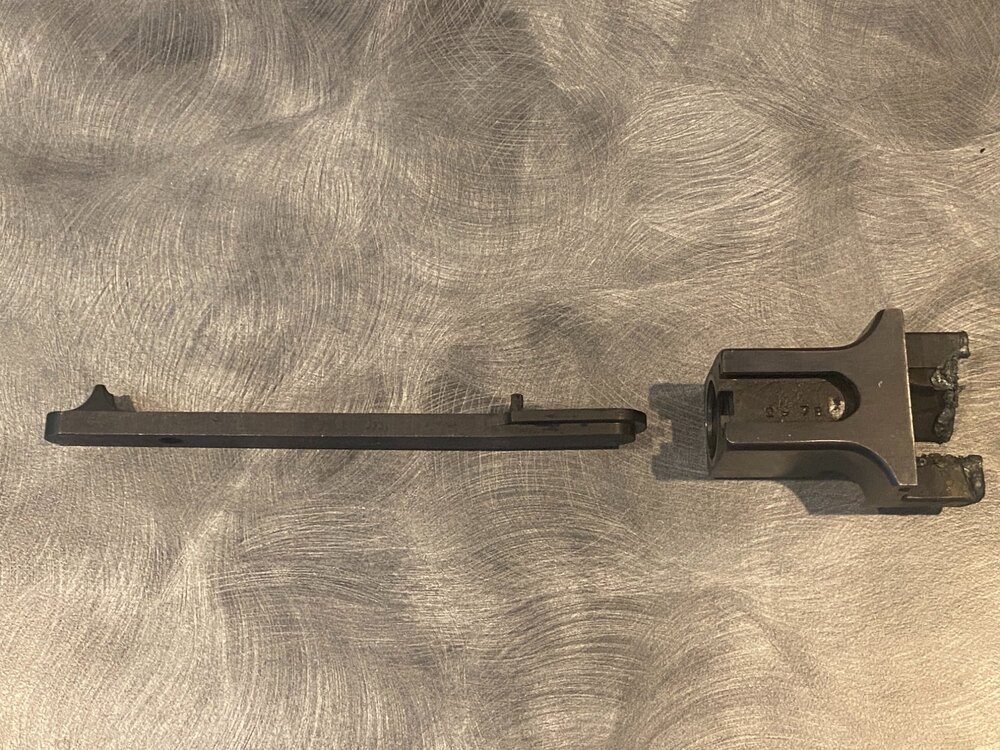

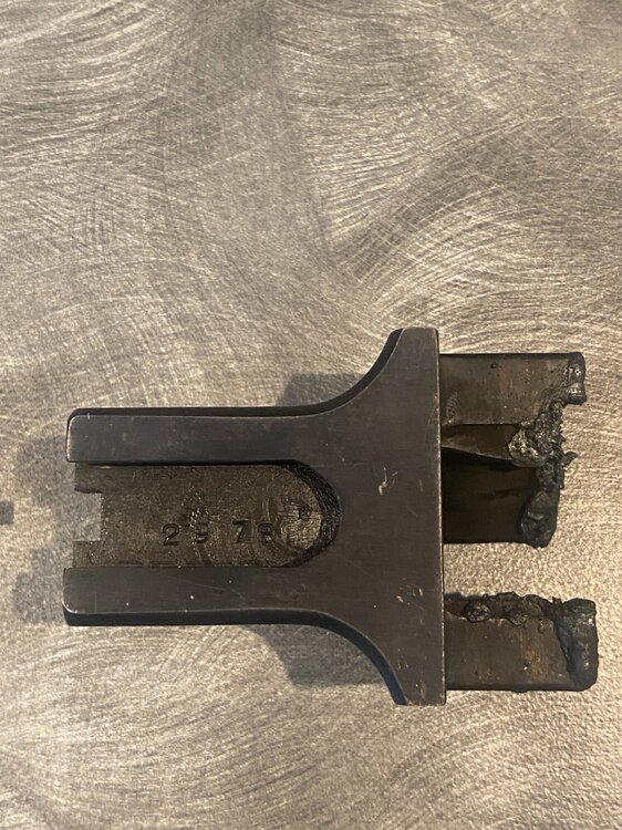

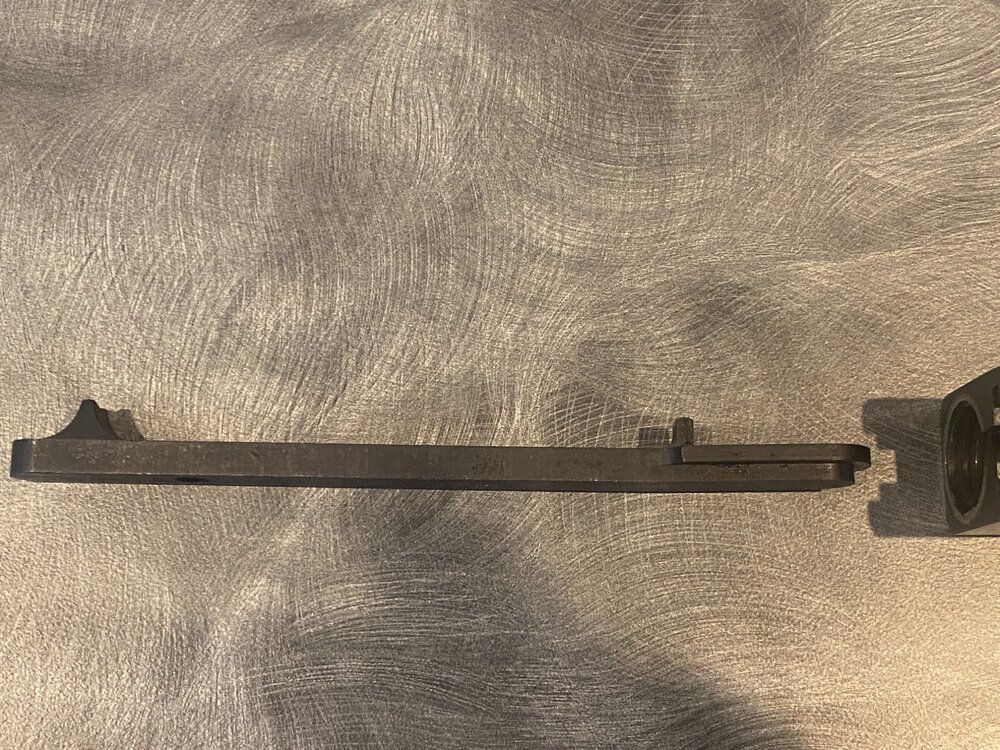

mbc230 Posted June 22, 2024 Report Share Posted June 22, 2024 (edited) I find this post very interesting and Fascinating. I have a Colt Grip Mount with Front End Nose Section For Serial Number 2978. See the below pictures: The front grip mount is bent as well and I never noticed it until I read this post. Great Information and good observations. Cheers! Edited June 22, 2024 by mbc230 Link to comment Share on other sites More sharing options...

Mk1992 Posted June 25, 2024 Author Report Share Posted June 25, 2024 Interesting... maybe are the early made grip mounts or late war made. Link to comment Share on other sites More sharing options...
laurencen Posted June 25, 2024 Report Share Posted June 25, 2024 I have 3 grip mounts from M1A1 and they are not bent the one from a 1928 has a slight bend however up until now I figured the bend was from use being dropped or to keep it tight on the barrel Link to comment Share on other sites More sharing options...
Rekraps Posted June 26, 2024 Report Share Posted June 26, 2024 On 6/25/2024 at 2:54 PM, Mk1992 said: Interesting... maybe are the early made grip mounts or late war made. My AOC 1928 is a 1942 gun. See pics above. Link to comment Share on other sites More sharing options...
spall Posted September 7, 2024 Report Share Posted September 7, 2024 Stumbled across this thread... Doug Richardson explained that the "bent" ones were intended for the vertical grips. I wonder... is that how the Colt grip mounts are? Link to comment Share on other sites More sharing options...
