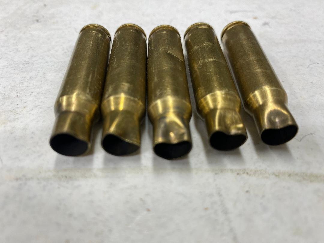

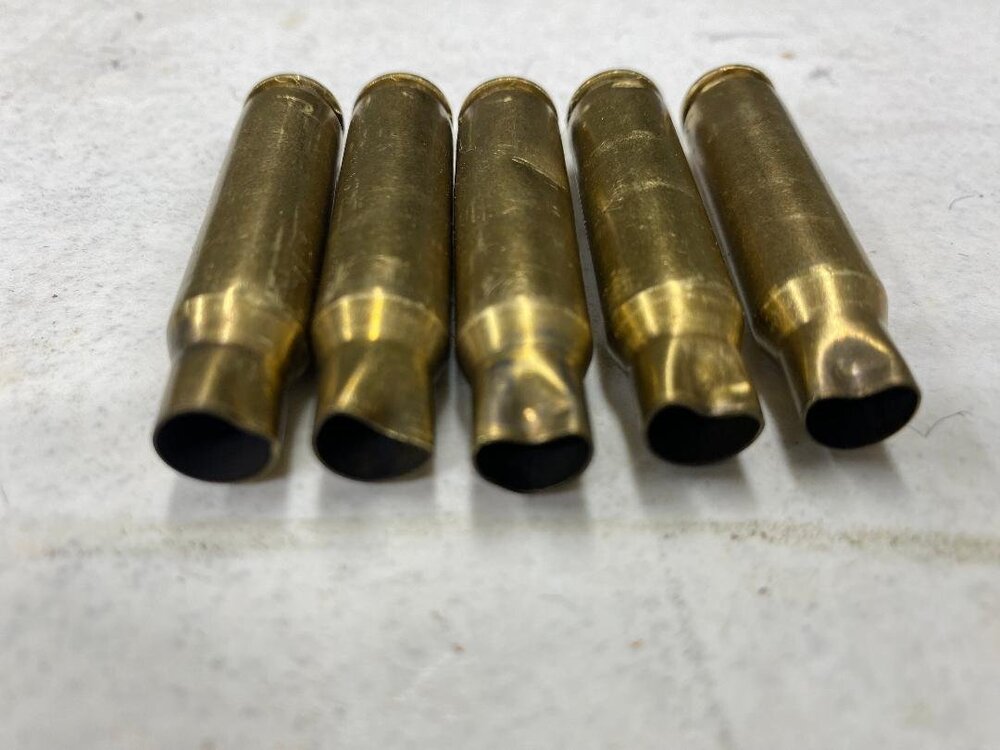

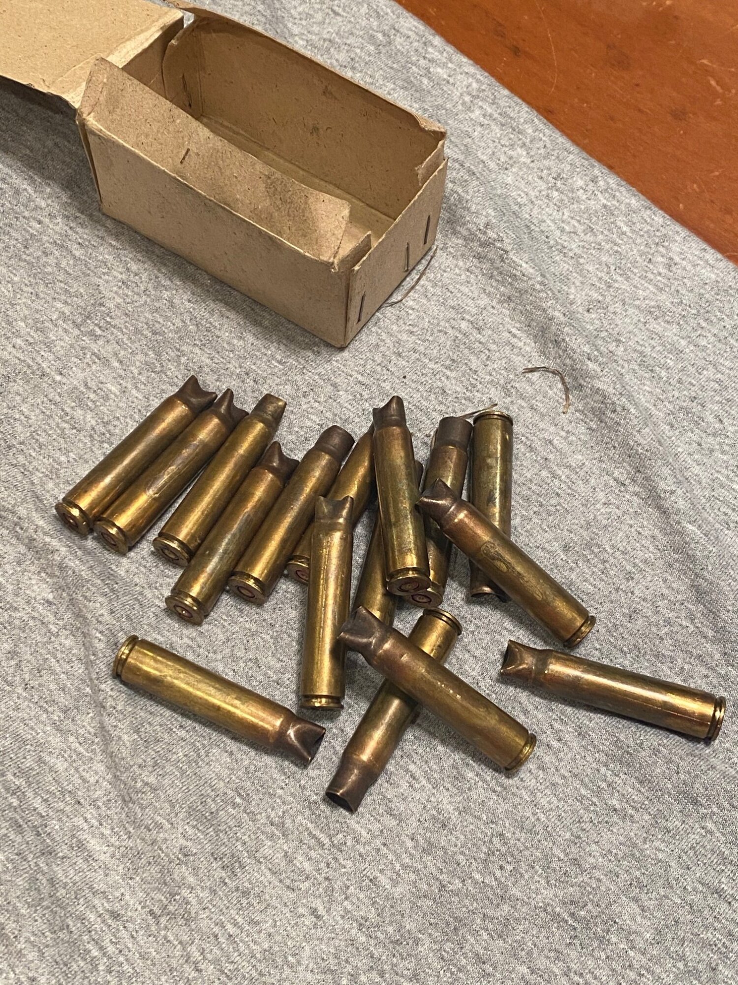

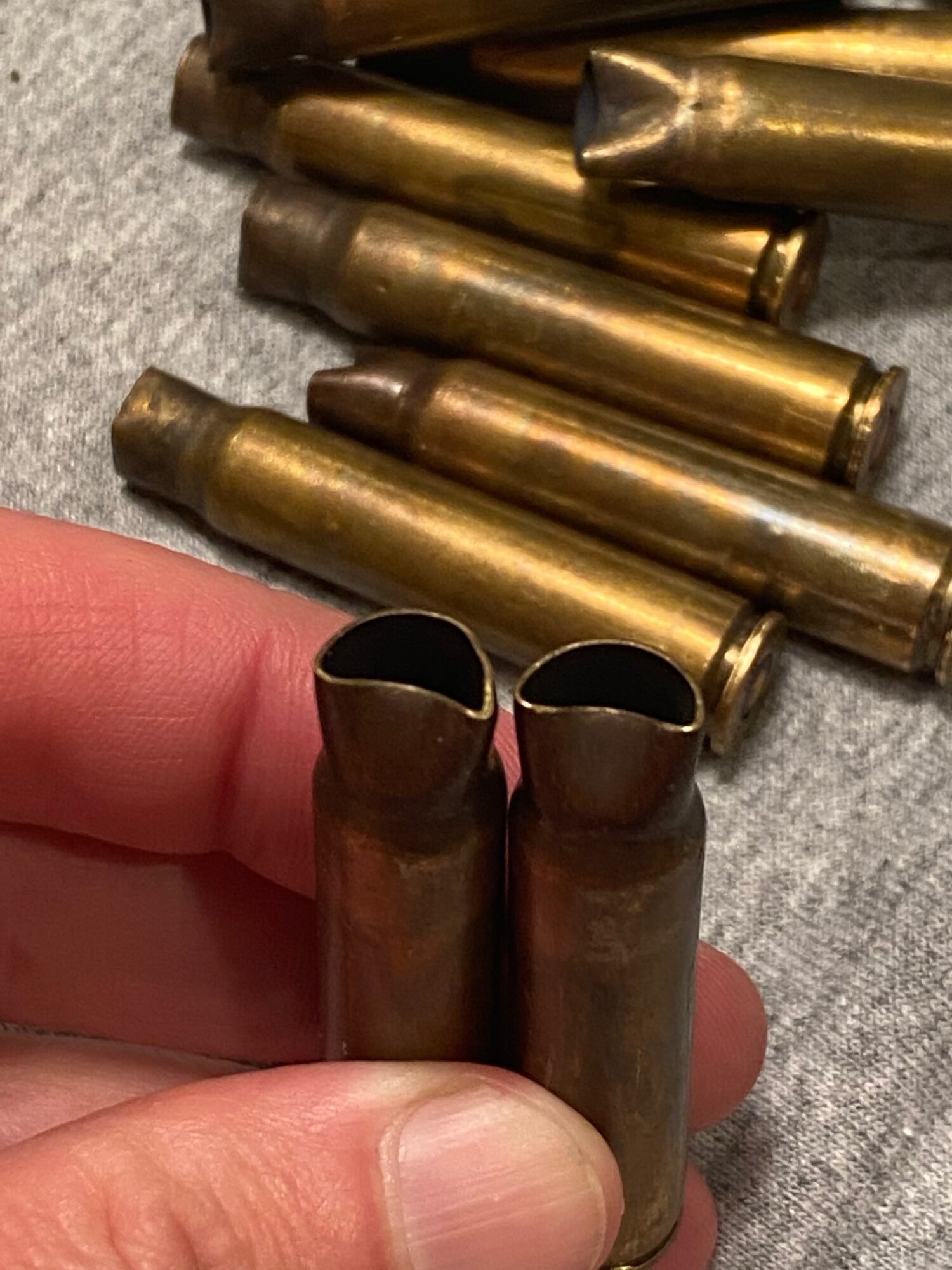

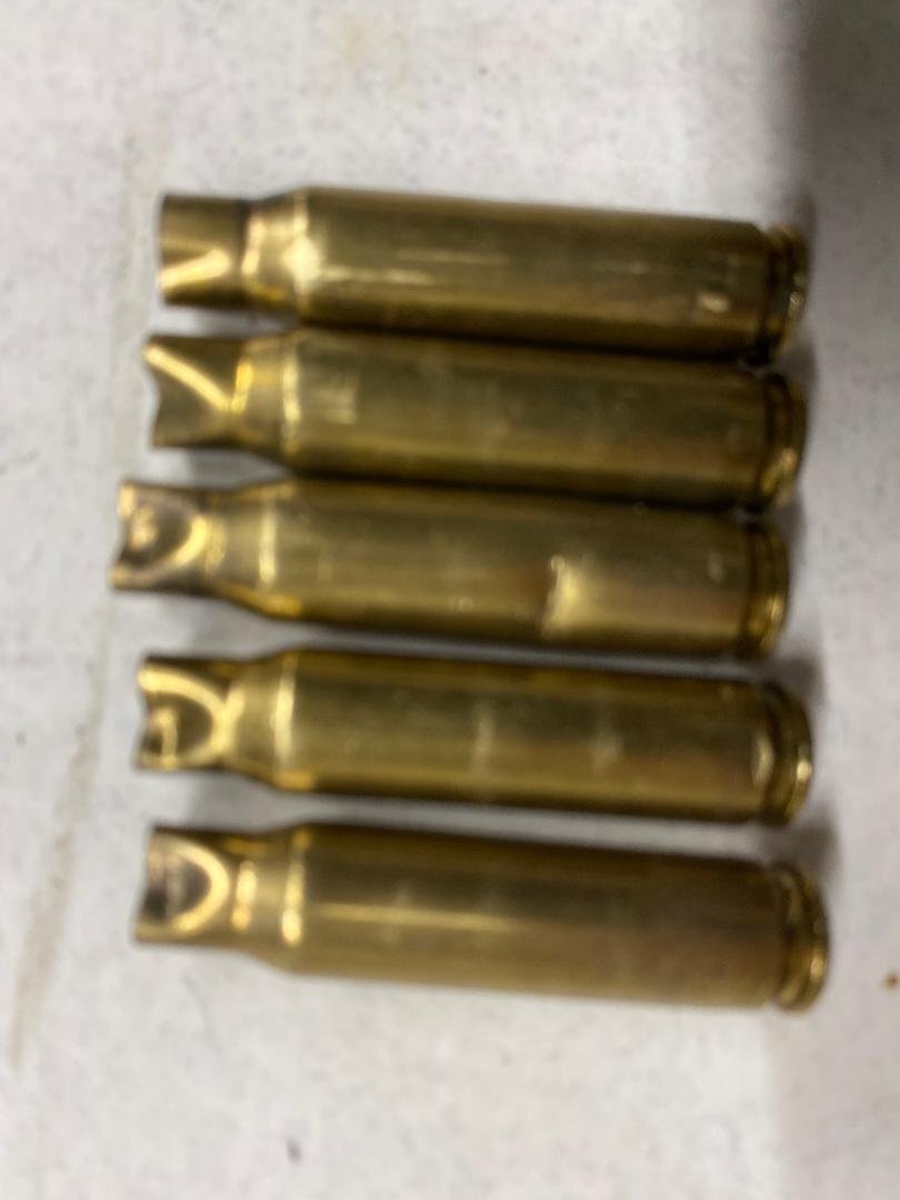

DVVKV01 Posted July 1, 2024 Report Share Posted July 1, 2024 Full auto ,.308 what causes this?? Link to comment Share on other sites More sharing options...
RoscoeTurner Posted July 1, 2024 Report Share Posted July 1, 2024 The one I owned would do that to 7.9 mm brass, just the nature of the breast. Link to comment Share on other sites More sharing options...
bmarvin Posted July 1, 2024 Report Share Posted July 1, 2024 I've had a few and they all did that Link to comment Share on other sites More sharing options...
Ryo Posted July 15, 2024 Report Share Posted July 15, 2024 Mg42 as well as MG34 are ejector brutal. Link to comment Share on other sites More sharing options...
Blanksguy Posted July 15, 2024 Report Share Posted July 15, 2024 Cut a short piece of Oil-Line/rubber-hose, then split it down one side.....then push it onto the front of your trigger-guard to act as a buffer. Link to comment Share on other sites More sharing options...
M38A1-Josh Posted July 16, 2024 Report Share Posted July 16, 2024 On my semi auto MG42 I got the gun to stop doing this by tuning the booster and nozzle, which changes how fast the bolt is driven backwards to eject the brass. I opened the nozzle bore to 1/2" and the booster is 8 clicks from tight. Link to comment Share on other sites More sharing options...

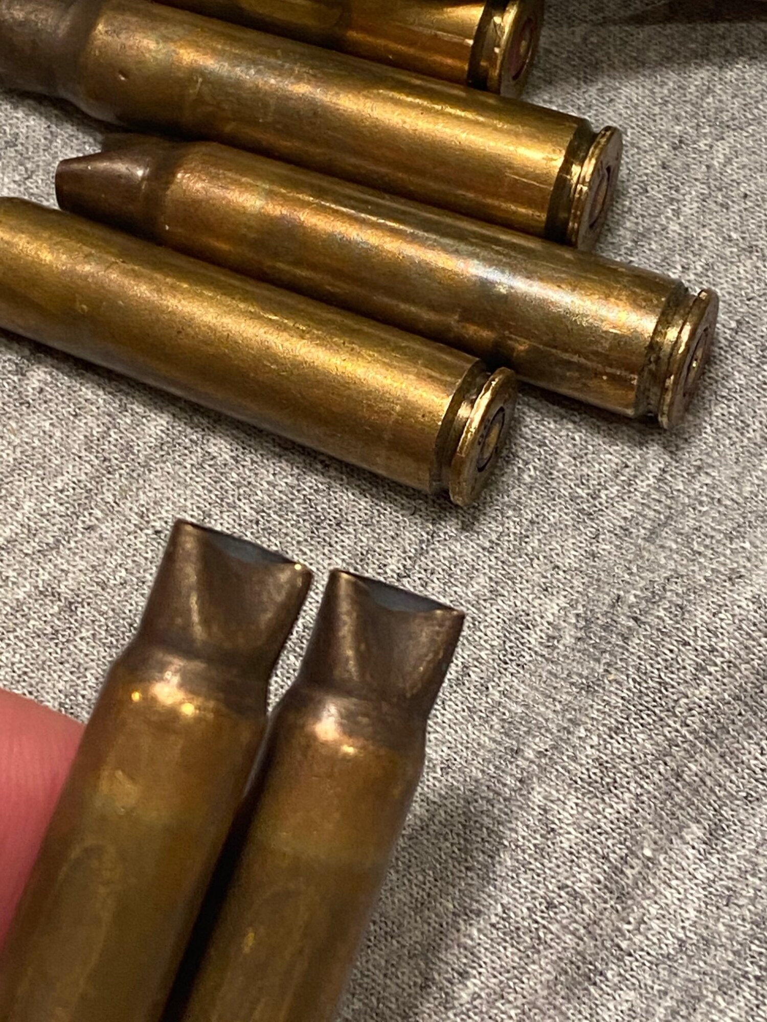

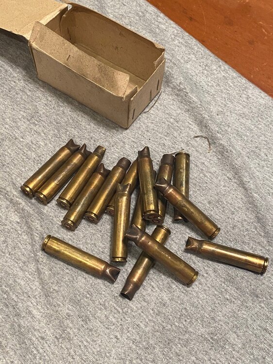

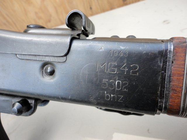

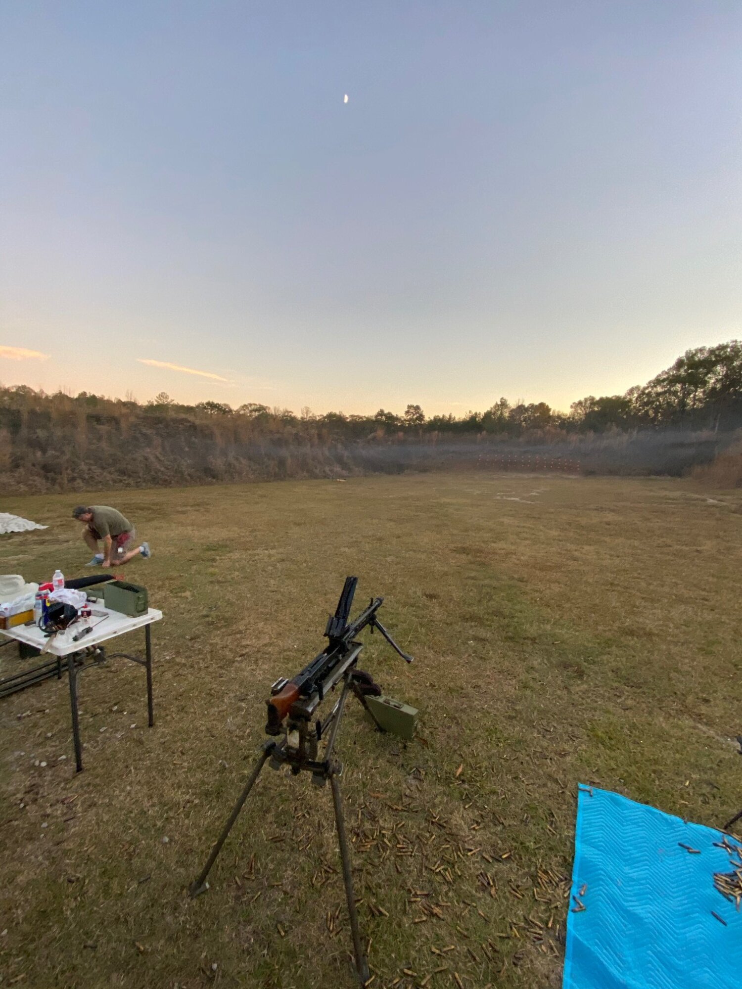

MS Collector Posted August 21, 2024 Report Share Posted August 21, 2024 Same experiences for me re: MG34 + MG42 crushing brass. Here are some examples of 1950's Yugo as ejected from a 1943 production '42 when we last shot it a few years ago. Link to comment Share on other sites More sharing options...

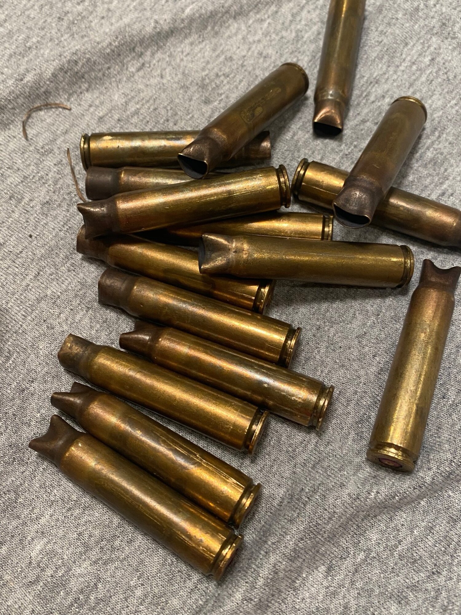

Countryboy77 Posted October 7, 2024 Report Share Posted October 7, 2024 I hate to say it but they all smack the recouperator on the way out.on tge mg3 it's a lot better they cut the forward couple inches off the stampings flat edges towards the front of the neck.Also it's ejected literally being 'spun' by the base which improves likelihood the neck will hit somthing i.e. layette, ground,shooters hand if they don't keep it on the sto k like thet are supposed to. Link to comment Share on other sites More sharing options...
