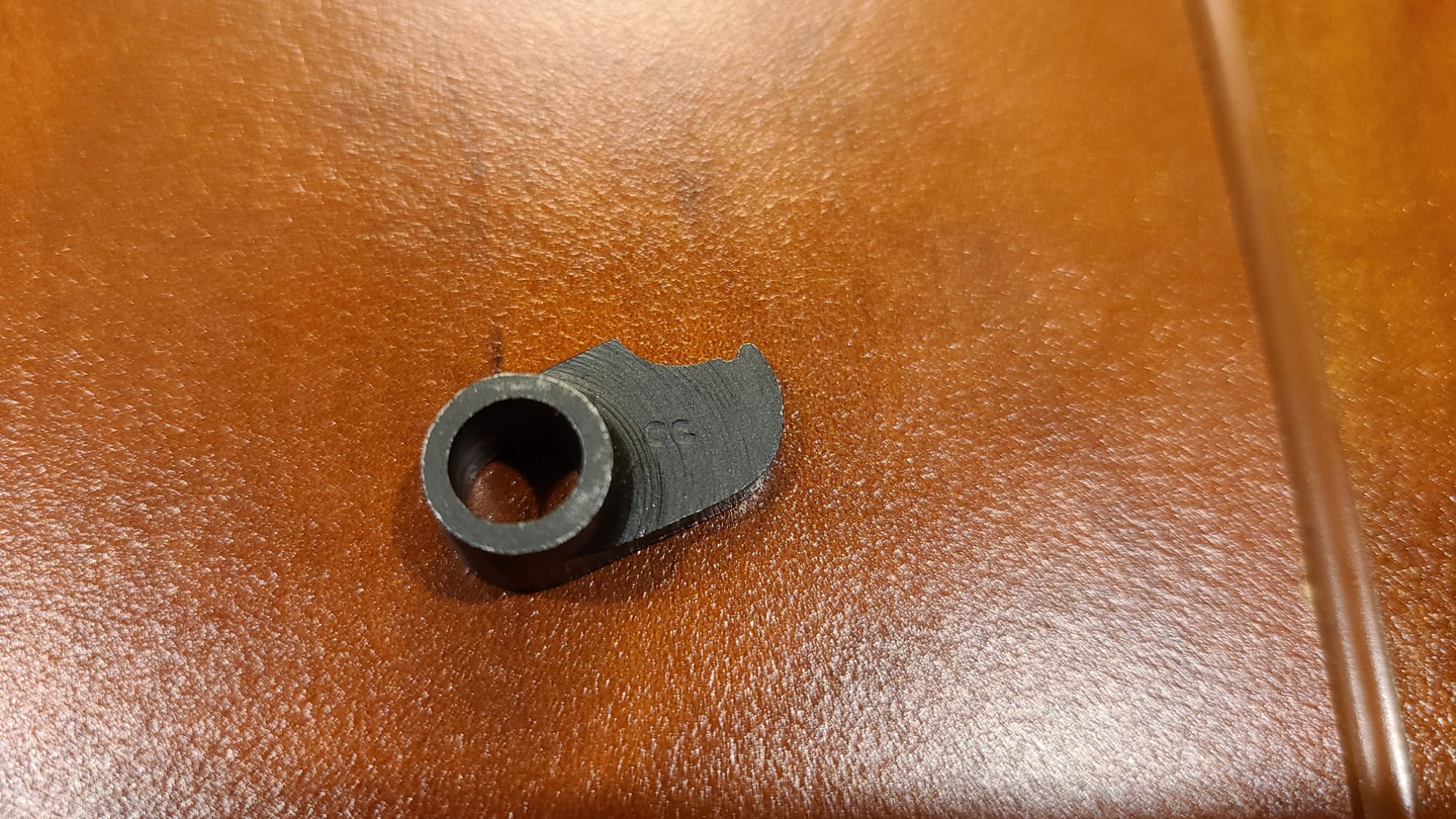

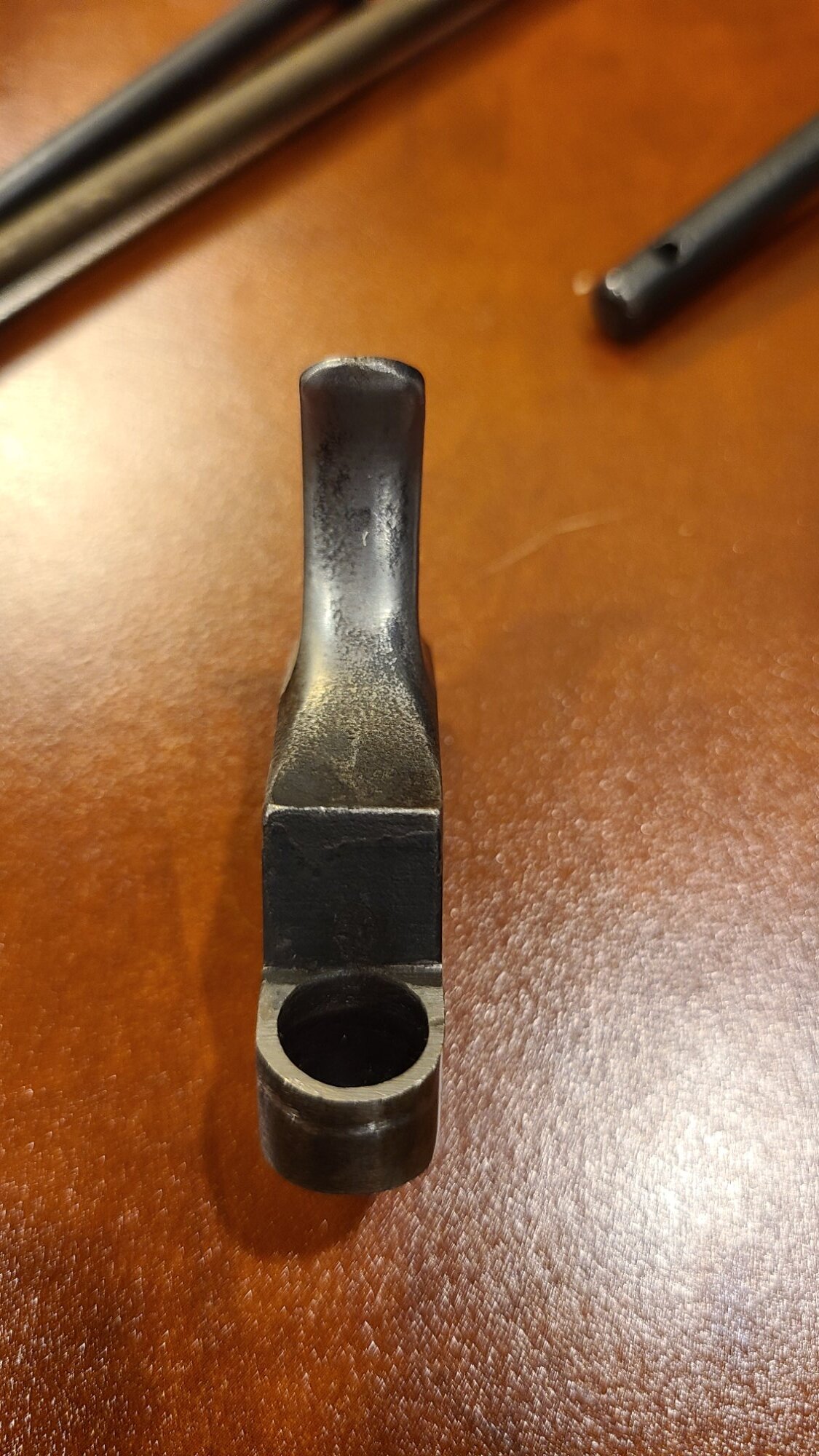

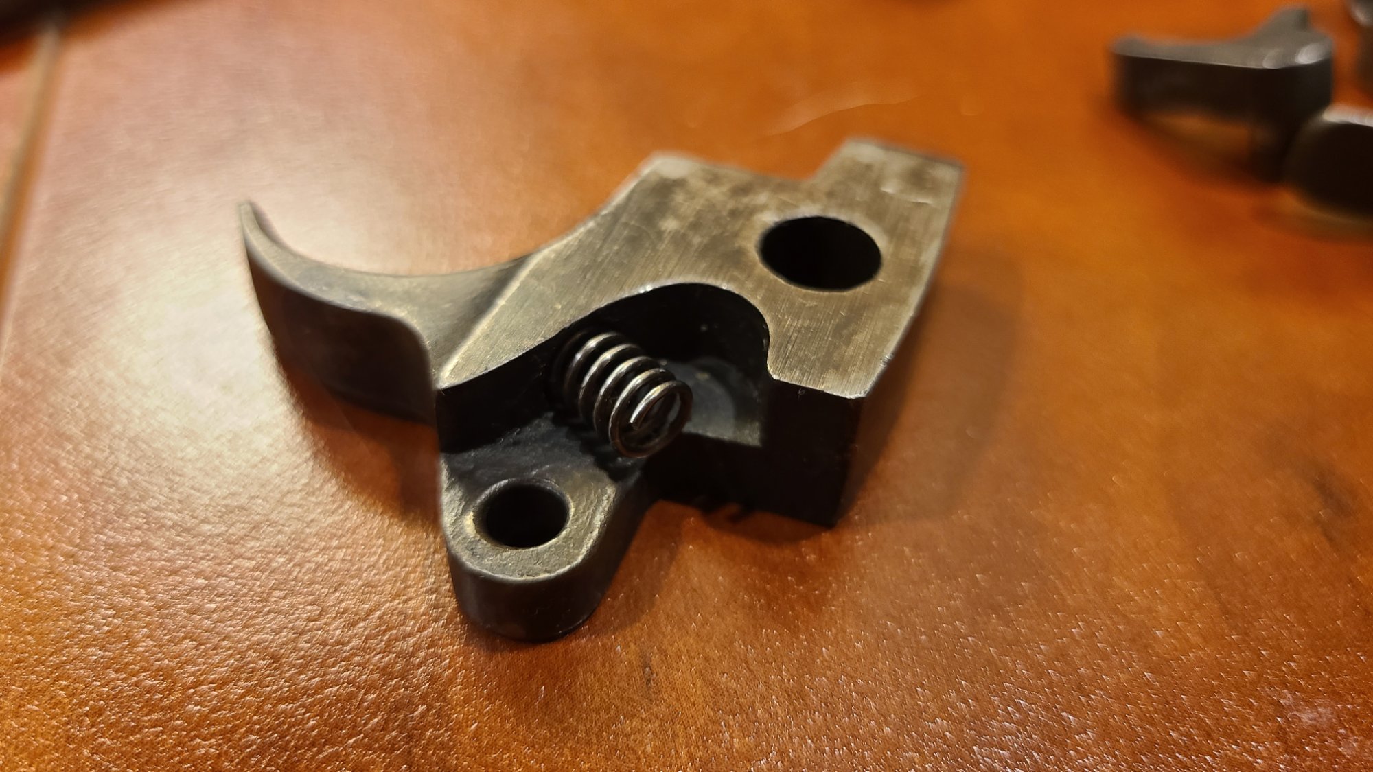

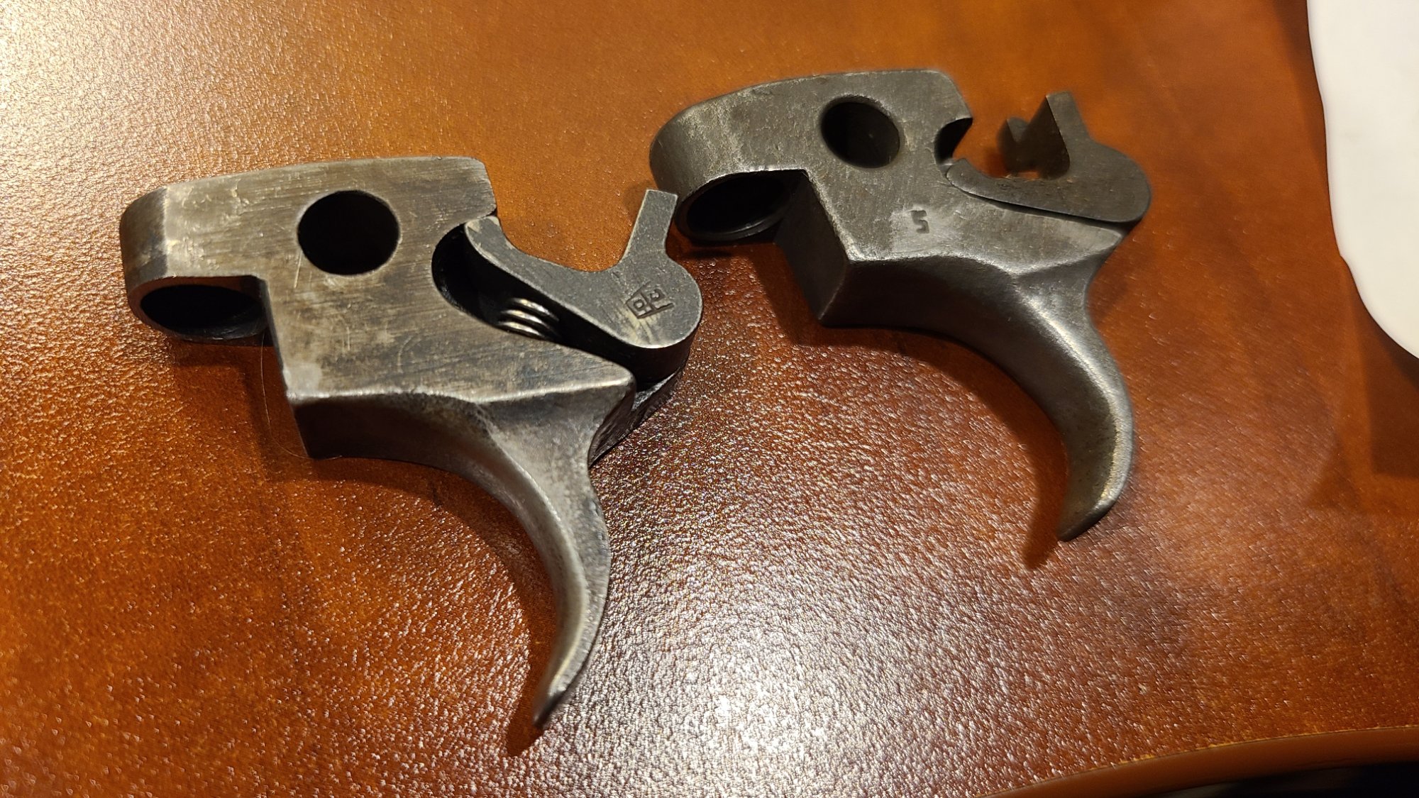

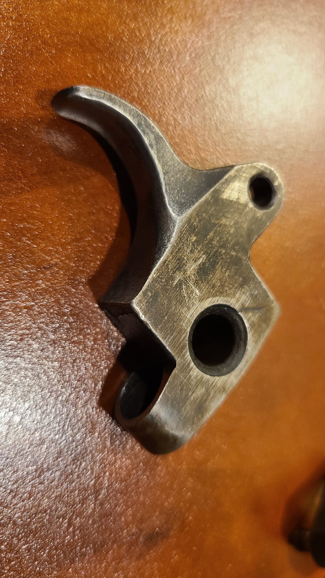

spall Posted July 6, 2024 Report Share Posted July 6, 2024 (edited) Consolidating some FCG parts and am unsure about a few of them. First is a trigger... no markings anywhere. Came in a 28A1 lower that had definitely been gone through since the war. The fit and finish is nicer than the Stevens next to it. Any guesses? Edited July 6, 2024 by spall added photos Link to comment Share on other sites More sharing options...
StrangeRanger Posted July 6, 2024 Report Share Posted July 6, 2024 The disconnector is marked Auto Ordnance so maybe... Link to comment Share on other sites More sharing options...

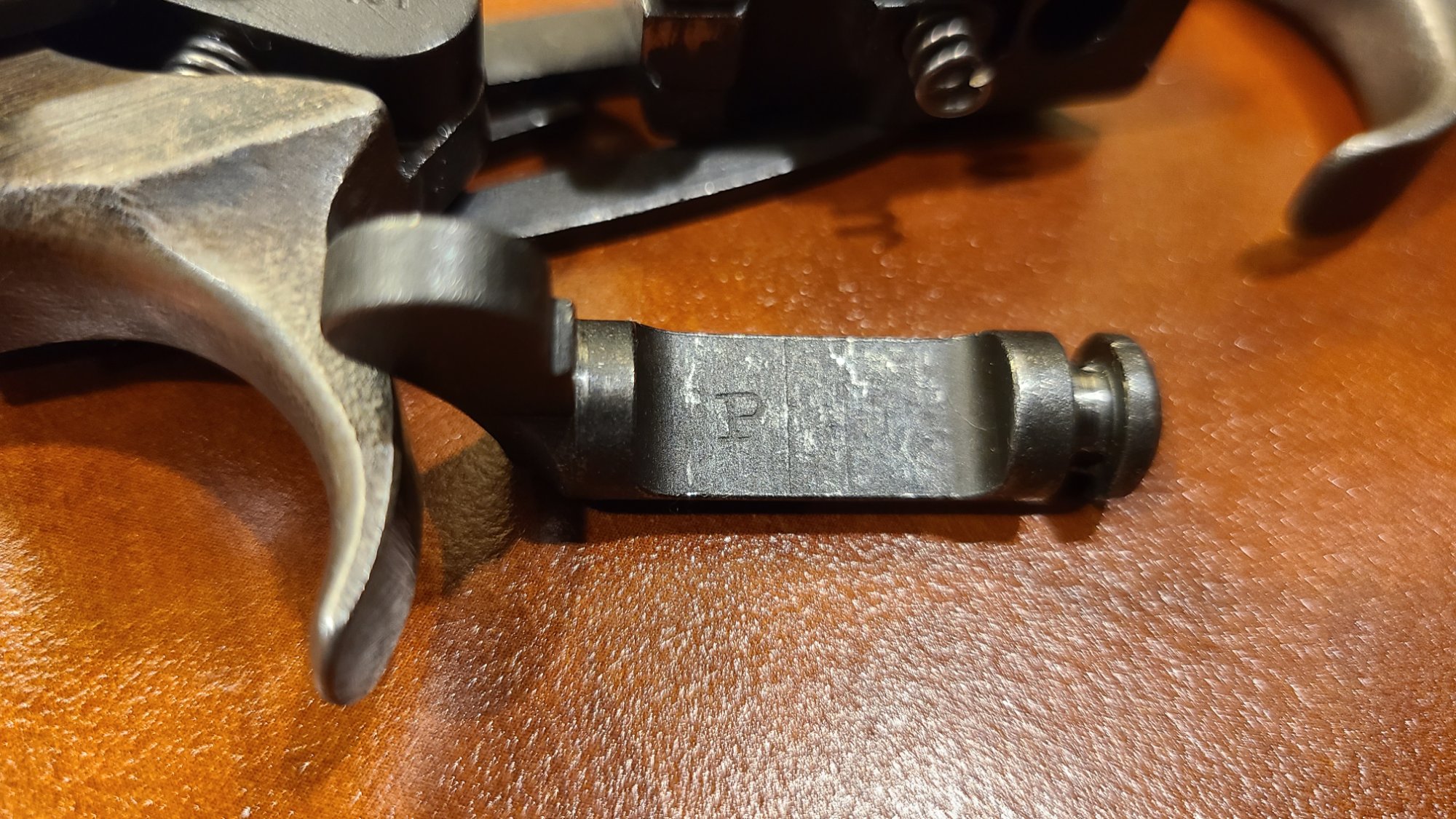

spall Posted July 6, 2024 Author Report Share Posted July 6, 2024 (edited) 43 minutes ago, StrangeRanger said: The disconnector is marked Auto Ordnance so maybe... I put that disconnector onto that trigger. Added a few photos with it removed. Next: A rocker marked "CC", and an uncheckered paddle selector switch marked "P" Edited July 6, 2024 by spall Link to comment Share on other sites More sharing options...
Rabbit57 Posted July 6, 2024 Report Share Posted July 6, 2024 According to American Thunder, 3rd edition, the rocker is made by Cinaudagraph Company (cc) out of Stamford, Conn. The "P" on the smooth safety lever stands for Pitney Bowes Postage Meter Company of Stamford, Conn. Mark Link to comment Share on other sites More sharing options...
TD. Posted July 6, 2024 Report Share Posted July 6, 2024 Based only on the pictures, I believe your unmarked trigger is a World War II part. It does not have the shape of a Colt era trigger in my opinion. That said, someone else jump in here. Link to comment Share on other sites More sharing options...
spall Posted July 7, 2024 Author Report Share Posted July 7, 2024 22 hours ago, Rabbit57 said: According to American Thunder, 3rd edition, the rocker is made by Cinaudagraph Company (cc) out of Stamford, Conn. The "P" on the smooth safety lever stands for Pitney Bowes Postage Meter Company of Stamford, Conn. Mark Thank you very much, Mark! I might have to pick up a copy of American Thunder for myself. I had no idea that either of those companies were contracted to produce machinegun components during the war. 21 hours ago, TD. said: Based only on the pictures, I believe your unmarked trigger is a World War II part. It does not have the shape of a Colt era trigger in my opinion. That said, someone else jump in here. That was my suspicion, as well... though I admittedly have zero expertise in things Colt Thompson. It seems like someone spent an extra couple of minutes on the unmarked trigger. The Stevens has the exact same curve profile on the back side, but the trigger face is "lumpy", as though it were forged into shape, but it missed a step afterwards. 1 Link to comment Share on other sites More sharing options...

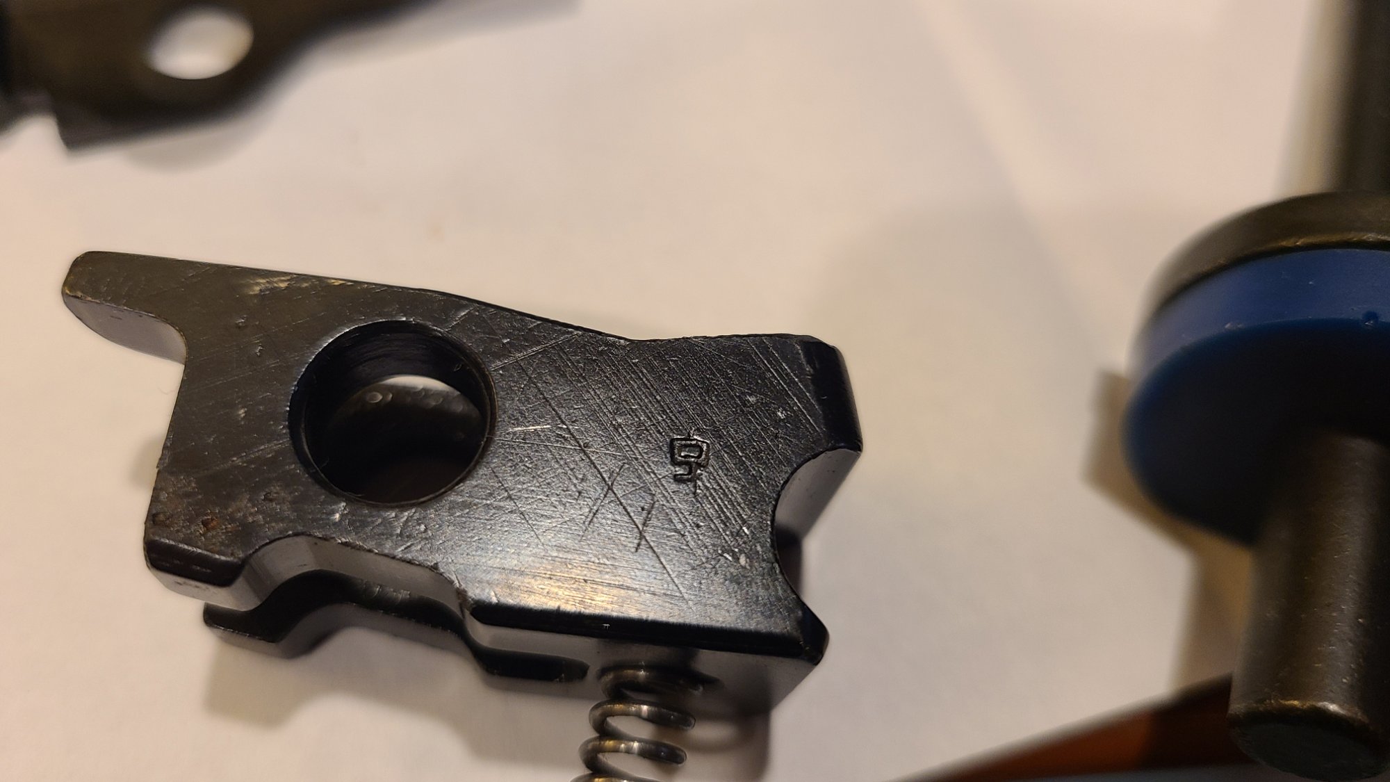

spall Posted July 13, 2024 Author Report Share Posted July 13, 2024 (edited) I'll be grabbing a copy of American Thunder, but until I get that.. I'm trying to figure out who made this auto sear. Edited July 13, 2024 by spall Link to comment Share on other sites More sharing options...
Bridgeport28A1 Posted July 13, 2024 Report Share Posted July 13, 2024 26 minutes ago, spall said: I'll be grabbing a copy of American Thunder, but until I get that.. I'm trying to figure out who made this auto sear. Square “S” is Stevens. It looks like the stamp bounced. Link to comment Share on other sites More sharing options...
Stampcollector Posted July 13, 2024 Report Share Posted July 13, 2024 Yes, I agree Link to comment Share on other sites More sharing options...
spall Posted July 13, 2024 Author Report Share Posted July 13, 2024 15 hours ago, Bridgeport28A1 said: Square “S” is Stevens. It looks like the stamp bounced. I don't know how I didn't see that until you pointed it out. Thanks! Link to comment Share on other sites More sharing options...
