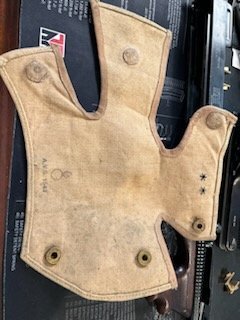

drmustang66 Posted July 9, 2024 Report Share Posted July 9, 2024 Found the canvas part in with a few WWII Thompson parts. Anyone know what it is? Link to comment Share on other sites More sharing options...
APEXgunparts Posted July 9, 2024 Report Share Posted July 9, 2024 It is a canvas cover for the M1 Thompson receiver. I actually have one on my gun. It doesn't look like it will make it on, but in the end it does. Richard Link to comment Share on other sites More sharing options...

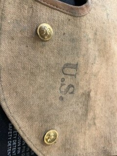

68coupe Posted July 10, 2024 Report Share Posted July 10, 2024 27 minutes ago, full auto 45 said: Richard is correct. M1/M1A1 Thompson breech cover, I believe this is a British item. Not to be contrary, but it's clearly marked U.S. Karl, 68coupe Link to comment Share on other sites More sharing options...

APEXgunparts Posted July 11, 2024 Report Share Posted July 11, 2024 6 hours ago, Roland the Thompsongunner said: Might be a reproduction I think IMA and some other places made them years back. Never saw a US marked one as mentioned they were a commonwealth item Funny you should mention that. Today I found half a box full of the real issue Thompson action covers, and another half box full of these new manufactured copies. The one in this picture is one of those copies, the marking on the brass snaps is a give-away as are the eyelet holes. We will have them properly identified when they get listed on the APEX Gun Parts web site. Richard. Link to comment Share on other sites More sharing options...
