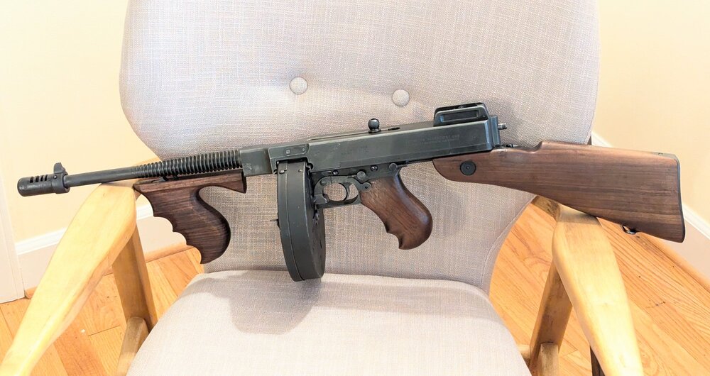

Cort Tompkins Posted July 13, 2024 Report Share Posted July 13, 2024 The mail man came earlier today and delivered my Thompson. It's not my first machine gun, but it is my first Thompson and I couldn't be more happy about it. I bought the gun from Ohio Ordnance Works back in December. It came to me on a very slow paper Form 4 since I decided to do a C&R transfer. I'd have had the gun many months ago if I'd have had it sent to my dealer and then eForm'd to me ... but oh well. The gun is S-NAC-33 which I've seen briefly referenced in a few books and in some old threads here. I own a lot of guns, but this is certainly the only one with a "famous" (big finger quotes) serial number. ? I'm in Virginia and I understand some of these NAC prefix guns went to the Virginia State Police. I'll put in the FOIA request soon and see if I can dig up some details. As a Virginian that would be a really cool connection. I haven't shot the gun yet but I'm planning to rectify that tomorrow. 2 Link to comment Share on other sites More sharing options...

TD. Posted July 13, 2024 Report Share Posted July 13, 2024 Cort Tompkins, Welcome to the Thompson forum on MachineGunBoards.com. Congratulations on NAC 33. I have known about this NAC Thompson since it appeared for sale on subguns.com in 2004. NAC 33 is featured on page 112 of my book, A Thompson Compendium. It is included in the chapter, The NAC Thompson Guns - 40 pages. Your correct about Virginia State Police owning a number of the crate or NAC Thompson guns. Most of Virginia State Police NAC Thompsons had Colt receivers but NAC 17 had a Savage receiver. I will be glad to help you file a Freedom of Information Act (FOIA) request. The new ATF FOIA request system is now web based. I make it very easy for the requestor. Contact me at tkd5501@fuse.net if you would like to discuss. TD. Link to comment Share on other sites More sharing options...

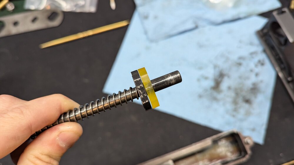

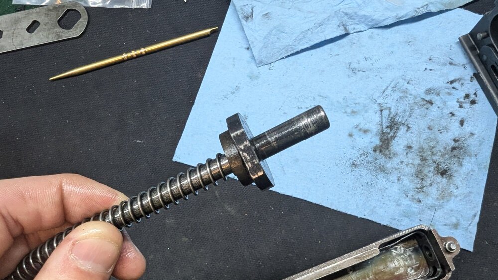

inertord Posted July 14, 2024 Report Share Posted July 14, 2024 Disassemble and check your bolt parts closely before firing. It appears that you are possibly at least missing a buffer, as the pilot is protruding out way too far. Link to comment Share on other sites More sharing options...
shotmag45 Posted July 14, 2024 Report Share Posted July 14, 2024 10-4 on the buffer.ENJOY Link to comment Share on other sites More sharing options...
Cort Tompkins Posted July 14, 2024 Author Report Share Posted July 14, 2024 Ahh yes, I see. It looks like the buffer was on the wrong side of the buffer pilot flange? I've replaced the old buffer with a new plastic/rubber buffer. I think this one came from Numrich. Link to comment Share on other sites More sharing options...
