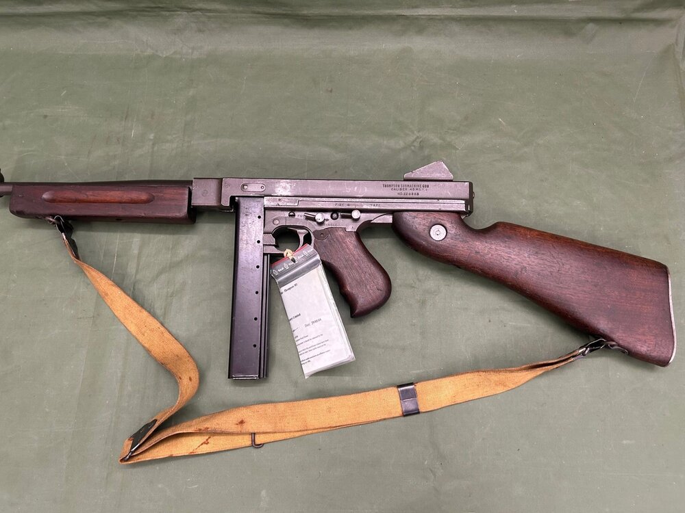

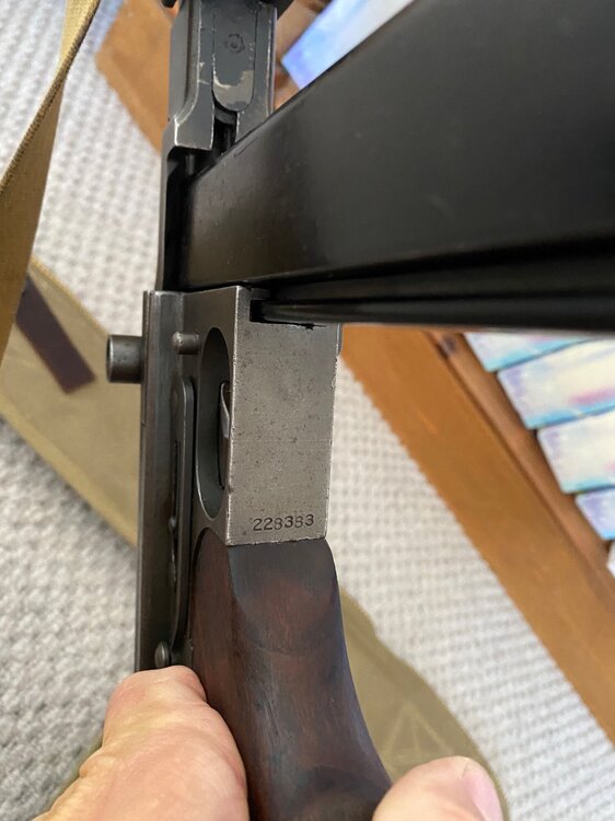

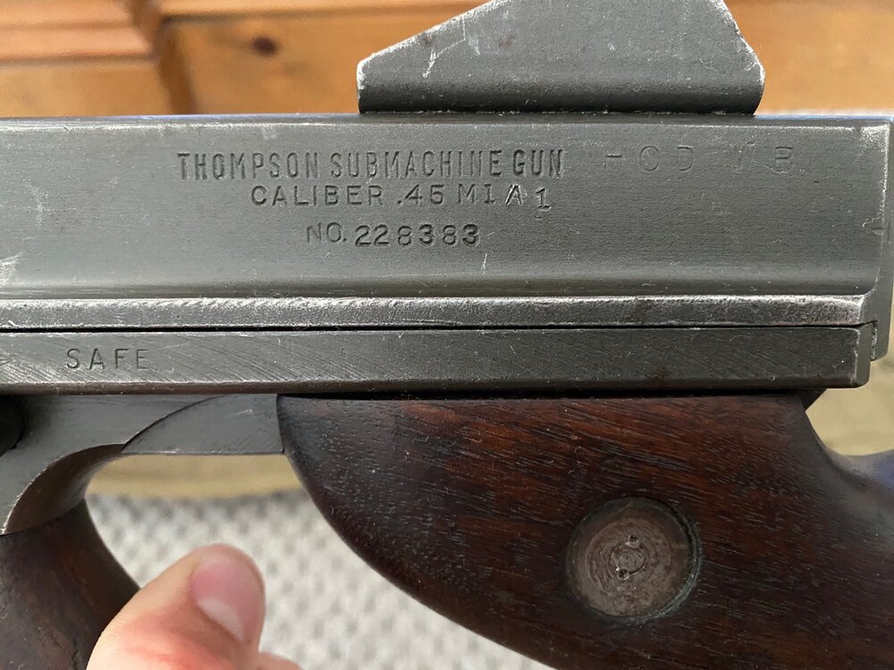

Ad Lav Posted July 19, 2024 Report Share Posted July 19, 2024 (edited) Hi guys, Just joined to hopefully further my knowledge of the Thompson SMG from the U.K. I have put a deposit on this one in the photos below. The serial reads 228383. It is deactivated but still fully moves/strips etc. I have also got an M1 Carbine and a Colt 1911. Is there anything you can tell me about it from the photos? I have got American Thunder on my watch list. Adam Edited July 19, 2024 by Ad Lav Spelling 1 Link to comment Share on other sites More sharing options...

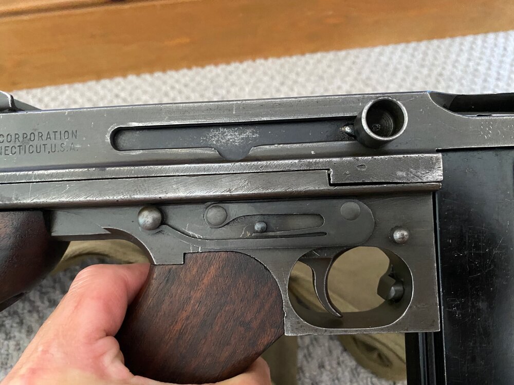

Frank I. Posted July 20, 2024 Report Share Posted July 20, 2024 On the bottom of the gun just aft of the grip mount, there should be a letter located there; S for Savage manufacture, or AOC for Auto-Ordnance's Bridgeport factory. If the trigger frame is Savage the "Full Auto" markings will be on two lines, AOC "Full Auto" will be on a single line. There MAY be a serial number on the bottom of the trigger frame, although that was discontinued, because if the original frame and receiver were mis-matched an incorrect serial number would be visible when the guns were in a storage rack. 1 Link to comment Share on other sites More sharing options...
Ad Lav Posted July 20, 2024 Author Report Share Posted July 20, 2024 Thanks for looking on Frank, much appreciated. I havn’t got my grubby mitts on it yet - but as soon as I do I will post better photos. It is marked with the same serial number on the lower receiver. Link to comment Share on other sites More sharing options...

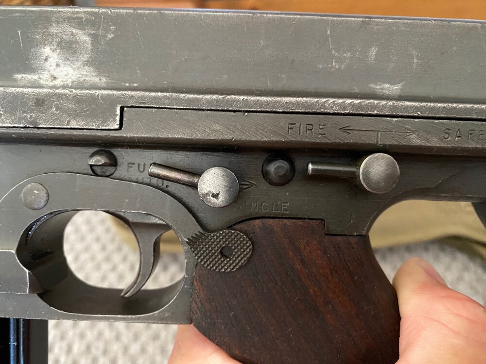

Rabbit57 Posted July 20, 2024 Report Share Posted July 20, 2024 Hello Ad Lav, I will give your markings a try. I believe your gun is a Savage made M1, that was updated to the M1A1 configuration. I think I can barely make out the FJA stamp at the front of your receiver, the stamp of Colonel Frank J. Atwood. He was the Army Inspector of Ordnance of the Rochester, New York District, where Savage guns were manufactured. If the serial numbers on the receiver and frame match, you are a lucky man. Matching numbers on the frame and receiver are not common. Your butt stock has been updated with the reinforcing bolt, and you have the "pin" type safety and rocker pivot, features that are an indication of an M1A1 model Thompson. I THINK I can see that your sling swivels are milled, not stamped, another indication that your Thompson started out as an M1 model. All in all, it looks like you have purchased a very nice example of a WWII Thompson, that started as an M1 model, and may have been updated to an M1A1 style at a later date. You can see that the A1 part of the stamping on your receiver has been added, either when the gun was made, with a left over M1 receiver, or at a later date as part of a rebuild. Also, this A1 marking is an indication that your bolt will not have a seperate firing pin, but a fixed protrusion on the bolt face. Please let us know when you are able to pick up your gun, it's a very nice piece. Mark 1 Link to comment Share on other sites More sharing options...

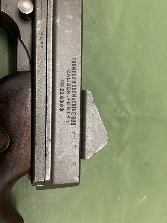

Doug Quaid Posted July 23, 2024 Report Share Posted July 23, 2024 (edited) If you turn the gun upside down, there should be a small "S" on the receiver, right in front of the magazine well. For "savage", of course. Looks like your gun has HOD WB stamped on the rear left side of the receiver. They look like rebuild stamps, but there is no HOD arsenal that I know of. Could be some kind of British markings. In the USA, sometimes you see police markings, like "LAPD." https://www.coolgunsite.com/pistols/arsenalrebuilds.htm Mine has RIA and FK stamped there. Maybe one of these guys on this site will know. They do seem to know everything! Edited July 23, 2024 by Doug Quaid 1 Link to comment Share on other sites More sharing options...

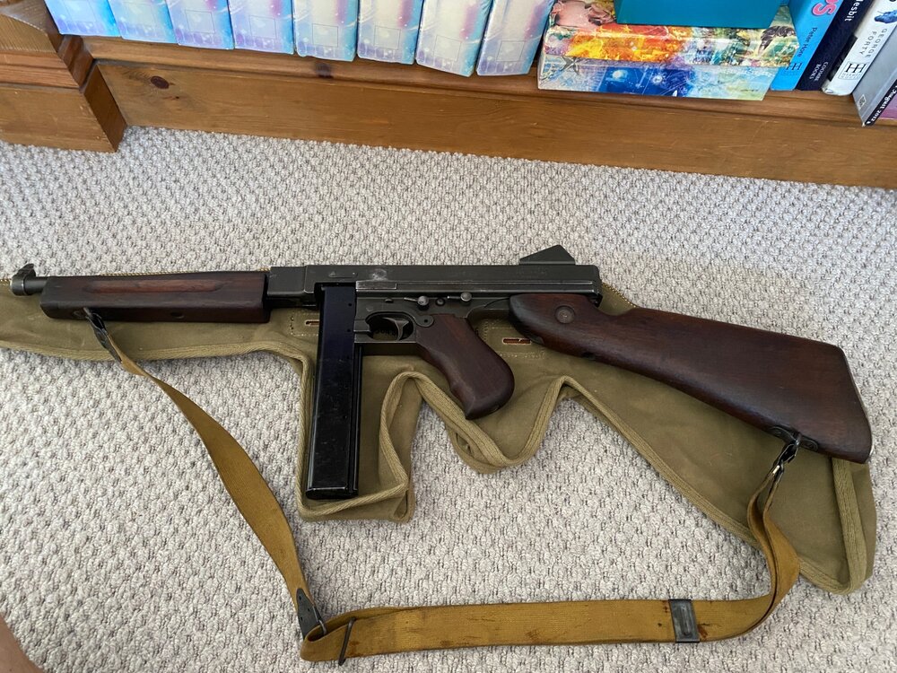

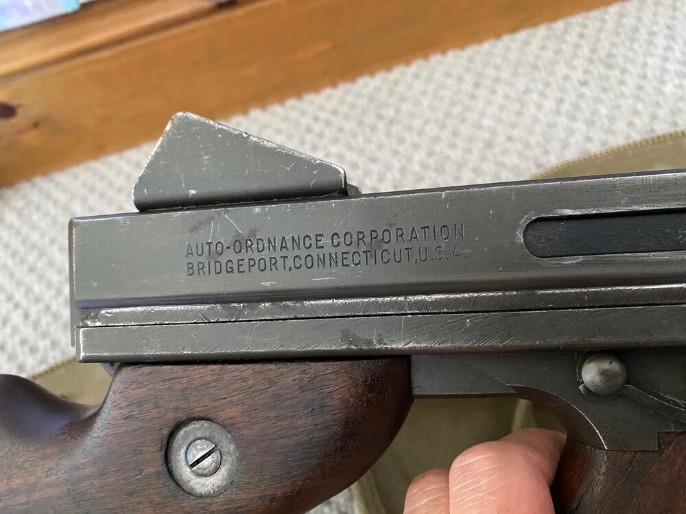

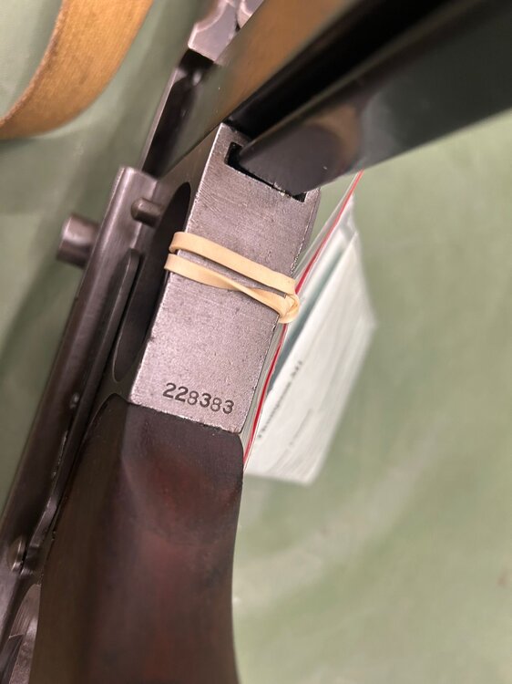

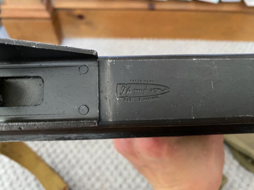

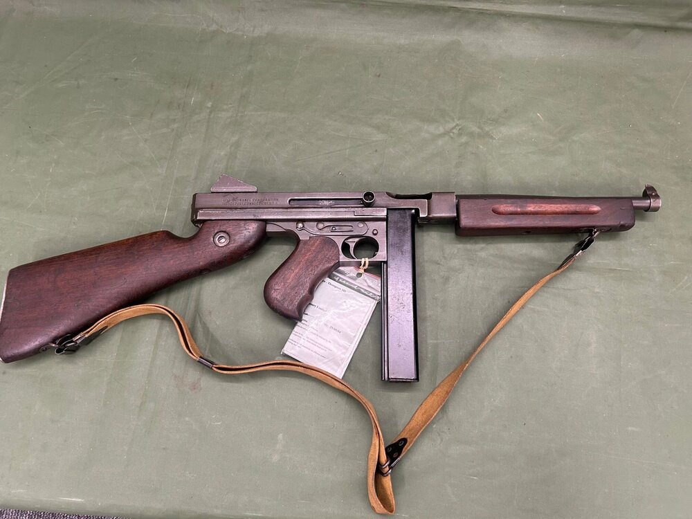

Ad Lav Posted July 28, 2024 Author Report Share Posted July 28, 2024 Finally some photos Link to comment Share on other sites More sharing options...
Ad Lav Posted July 28, 2024 Author Report Share Posted July 28, 2024 (edited) And a few more. M1, upgraded to A1 spec. Built by Savage - ‘S’ stamp evident. Matching numbers. Very pleased! Edited July 28, 2024 by Ad Lav Link to comment Share on other sites More sharing options...
TD. Posted July 28, 2024 Report Share Posted July 28, 2024 Very nice. Thank you for sharing. Could "HOD" be Hartford Ordnance District? Just a thought. 1 Link to comment Share on other sites More sharing options...
Bridgeport28A1 Posted July 29, 2024 Report Share Posted July 29, 2024 The HOD stamp is not Hartford Ordnance District. 1 Link to comment Share on other sites More sharing options...
shadycon Posted July 29, 2024 Report Share Posted July 29, 2024 My guess is the Co. that deactivated it. 1 Link to comment Share on other sites More sharing options...

TSMGguy Posted July 31, 2024 Report Share Posted July 31, 2024 (edited) There were US Army Ordnance Branch depots in the ETO that were fully capable of high-level repairs. Overhauls didn't happen only at US arsenals and depots. Edited July 31, 2024 by TSMGguy 1 Link to comment Share on other sites More sharing options...
