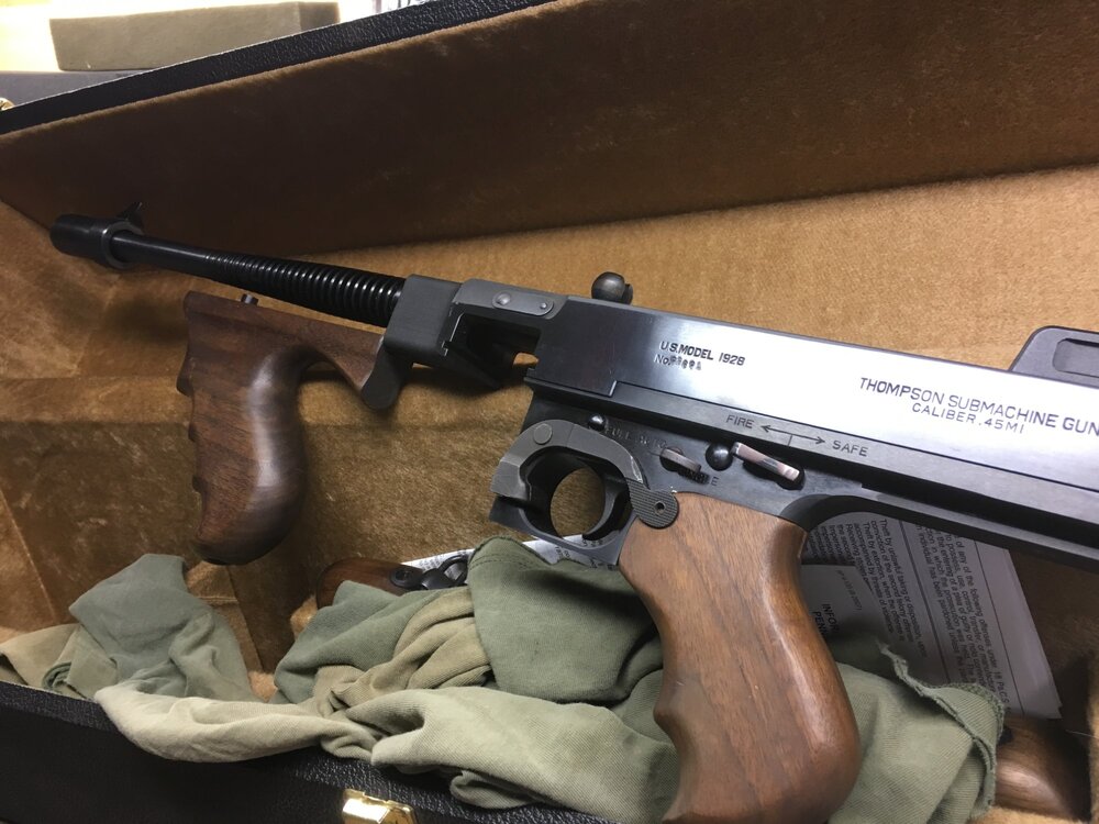

2 LONG IN THE FOUL Posted August 5, 2024 Report Share Posted August 5, 2024 IMG_1004.MOV Just want to say thanks to all those who gave advise on getting my west hurly to run as intended. I am happy (no thrilled) to report that 80 rounds ( 1) 50 rd mag) and (1 30 rd mag ) went through with out a hick cup. You'll remember me as the guy who opened up his receiver and found foreign looking parts. All USGI parts were bought and I installed them. The only question I have is the recoil spring I purchased ended up being too long and wouldn't fit so I used the old one. Would it be ok to cut the new one down?? Well anyway I really appreciate all your help Stay Frosty Link to comment Share on other sites More sharing options...
reconbob Posted August 5, 2024 Report Share Posted August 5, 2024 It would be best to just get some correct springs. If the spring is too long it is probably not a Thompson spring. Plus, springs are so cheap vs. the value of the gun there is no reason to risk it. The correct length of the spring is 11 5/16" +/- 5/16". There are "hi speed" aftermarket springs out there, but I do not think they are necessary. Bob Link to comment Share on other sites More sharing options...
Chappy Posted August 5, 2024 Report Share Posted August 5, 2024 3 hours ago, reconbob said: It would be best to just get some correct springs I use Wolff springs and they work well. Link to comment Share on other sites More sharing options...
