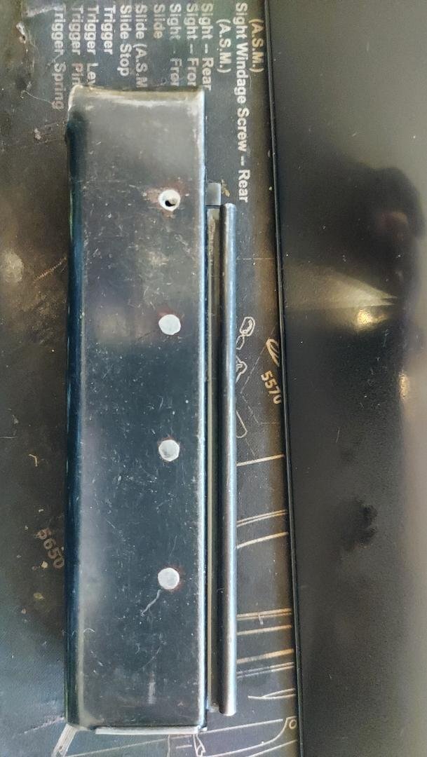

Glawre Posted August 7, 2024 Report Share Posted August 7, 2024 I can't seem to find magazines for my thompson. 1928 I tried Auto Ordanance and Numric but no go. Mags are available for model 1927's but not for a WH, or any 1928. I actually have mags but the springs are failing causing the gun to not load. Does anyone know where I can get springs for these? Thank you, Gary Link to comment Share on other sites More sharing options...

Chip Posted August 18, 2024 Report Share Posted August 18, 2024 Not mine, and rather pricey but for sale https://www.gunbroker.com/item/1061029620 Link to comment Share on other sites More sharing options...

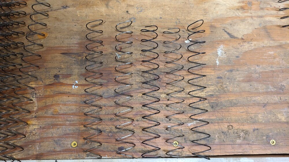

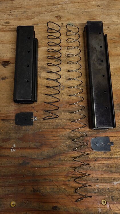

spall Posted August 18, 2024 Report Share Posted August 18, 2024 15 minutes ago, 68coupe said: I have searched in vain for replacement springs for my 20rd mags. If anyone would provide the length dimension of a spring for a NOS 20rd mag, I'm quite certain that I'm not the only one that would appreciate it. I'm equally certain that the Wolfe springs could be trimmed to work. V/R Karl, 68coupe While length is the unit of measurement for recoil springs, I'm thinking about getting some Wolff 30s and simply cutting them to the same number of coils as my original 20s. Might order some this afternoon and volunteer to be the guinea pig. Though I'd be very surprised if this hadn't been tried before... It looks like my 20s have 13 coils, and my 30s have 20 coils. Spring is the same diameter (a little more than 0.05" with my cheap dial caliper), and they seem to be formed identically, aside from the additional coils. Link to comment Share on other sites More sharing options...

spall Posted August 31, 2024 Report Share Posted August 31, 2024 The left two springs are new Wolff 30rd springs, vs. various (presumably original) springs from my other mags. The leftmost spring is a Wolff 30 that I cut down to 13 coils to match my other 20rd mag springs. I moved floor plates and followers around to put my mags into their correct configurations according to Roger Herbst's book. I also wound up straightening some bent followers and scrubbing out old cosmoline while replacing all of my springs. Fingers crossed... Link to comment Share on other sites More sharing options...
