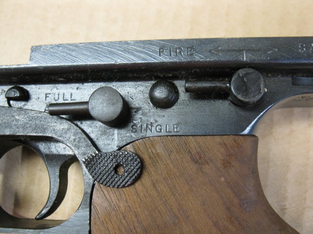

reconbob Posted August 10, 2024 Report Share Posted August 10, 2024 I have a M1928A1 trigger frame with a serial #542XXX. It has the later square T-slot for the magazine. The safety and rocker pivot are the later "pin" style levers. Are these correct for a late frame like this? Or should the frame have the flat paddle style levers? Or no way of knowing? Not restoring a gun, just curious... Bob Link to comment Share on other sites More sharing options...

Rekraps Posted August 11, 2024 Report Share Posted August 11, 2024 (edited) Picture from Frank's article on the 1928A1... Edited January 25, 2025 by Rekraps Link to comment Share on other sites More sharing options...
StrangeRanger Posted August 11, 2024 Report Share Posted August 11, 2024 You're looking at 80 or more year old guns that were built with parts on hand at the time, re-built or at least refitted probably several times in the interim. There really is no definitive answer as to what is original or as to whether the current configuration is the original configuratiln Link to comment Share on other sites More sharing options...
Rekraps Posted August 11, 2024 Report Share Posted August 11, 2024 57 minutes ago, StrangeRanger said: You're looking at 80 or more year old guns that were built with parts on hand at the time, re-built or at least refitted probably several times in the interim. There really is no definitive answer as to what is original or as to whether the current configuration is the original configuratiln Ah, the voice of reason. With this, I am 100% in agreement. What I see is a very nice Savage lower. Link to comment Share on other sites More sharing options...

Rekraps Posted August 12, 2024 Report Share Posted August 12, 2024 So, I'm waiting on Frank to chime in, but in the meantime I called Andrewski to get his take on the 1928's and he opined that in his experience, almost all rebuilds (arsenal) have pin type BUT he has seen many non-rebuilds with pin types also (although there is no way to say of they are original from the factory configuration). He prefers paddle (easier to use) but both types are original and neither add nor detract from the value of the gun. As Stranger Ranger says, 80+ years, not that good of documentation on this topic and who knows what variations actually came out of the factory. Link to comment Share on other sites More sharing options...
Rekraps Posted August 12, 2024 Report Share Posted August 12, 2024 Frank responded and his position is that all 1928's Savage/Bridgeport left the factor with paddle controls. He said, never say never, but along with Andrewski's view, I think we are safe to say that 1928's, OEM (not rebuilt) had paddle safety and actuators from the factory. Pin style was for rebuilds, field repairs etc. Again, it does not detract from the value of the guns, as both configurations are "real". Link to comment Share on other sites More sharing options...

Frank I. Posted August 12, 2024 Report Share Posted August 12, 2024 Well, the pin type control levers came out with the M1A1 Thompson, at that time the 1928 Model was out of production. Link to comment Share on other sites More sharing options...
Rekraps Posted August 12, 2024 Report Share Posted August 12, 2024 1 hour ago, Frank Iannamico said: Well, the pin type control levers came out with the M1A1 Thompson, at that time the 1928 Model was out of production. Glad i asked you! Link to comment Share on other sites More sharing options...
gijive Posted August 12, 2024 Report Share Posted August 12, 2024 (edited) On 8/11/2024 at 2:04 PM, Rekraps said: Ah, the voice of reason. With this, I am 100% in agreement. What I see is a very nice Savage lower. Rekraps, The grip frame you show in the picture you posted is not a Savage frame. It is an Auto-Ordnance made frame. The Full Auto is engraved on one line, not like the Savage frames that have it on two lines. The AC guns, like the one pictured were sold by Maguire Industries and were put together from end of contract parts and sold to law enforcement agencies, mainly Post-WWII. They were all 1928 Models. Edited August 12, 2024 by gijive Link to comment Share on other sites More sharing options...
Rekraps Posted August 13, 2024 Report Share Posted August 13, 2024 15 hours ago, gijive said: Rekraps, The grip frame you show in the picture you posted is not a Savage frame. It is an Auto-Ordnance made frame. The Full Auto is engraved on one line, not like the Savage frames that have it on two lines. The AC guns, like the one pictured were sold by Maguire Industries and were put together from end of contract parts and sold to law enforcement agencies, mainly Post-WWII. They were all 1928 Models. Thanks, I knew that. Sometimes there are so many pics and concurrent discussions that I get things mixed up. Link to comment Share on other sites More sharing options...
Rekraps Posted August 13, 2024 Report Share Posted August 13, 2024 16 hours ago, gijive said: Rekraps, The grip frame you show in the picture you posted is not a Savage frame. It is an Auto-Ordnance made frame. The Full Auto is engraved on one line, not like the Savage frames that have it on two lines. The AC guns, like the one pictured were sold by Maguire Industries and were put together from end of contract parts and sold to law enforcement agencies, mainly Post-WWII. They were all 1928 Models. That was in reference to the original pic by reconbob. Link to comment Share on other sites More sharing options...
gijive Posted August 14, 2024 Report Share Posted August 14, 2024 21 hours ago, Rekraps said: That was in reference to the original pic by reconbob. Okay, I understand now. Link to comment Share on other sites More sharing options...
