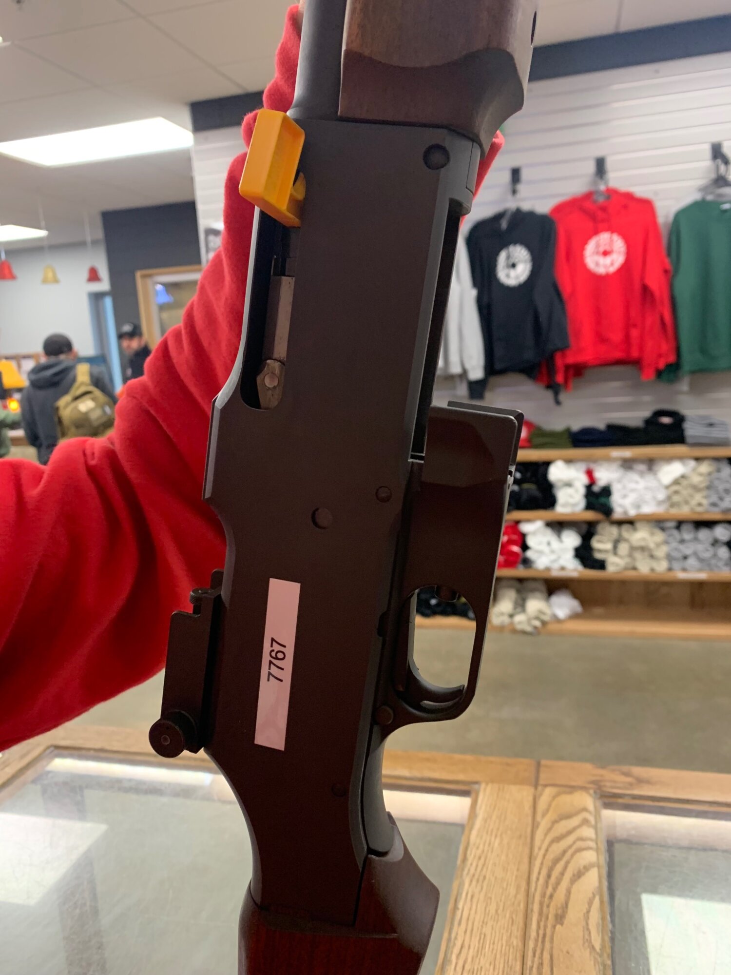

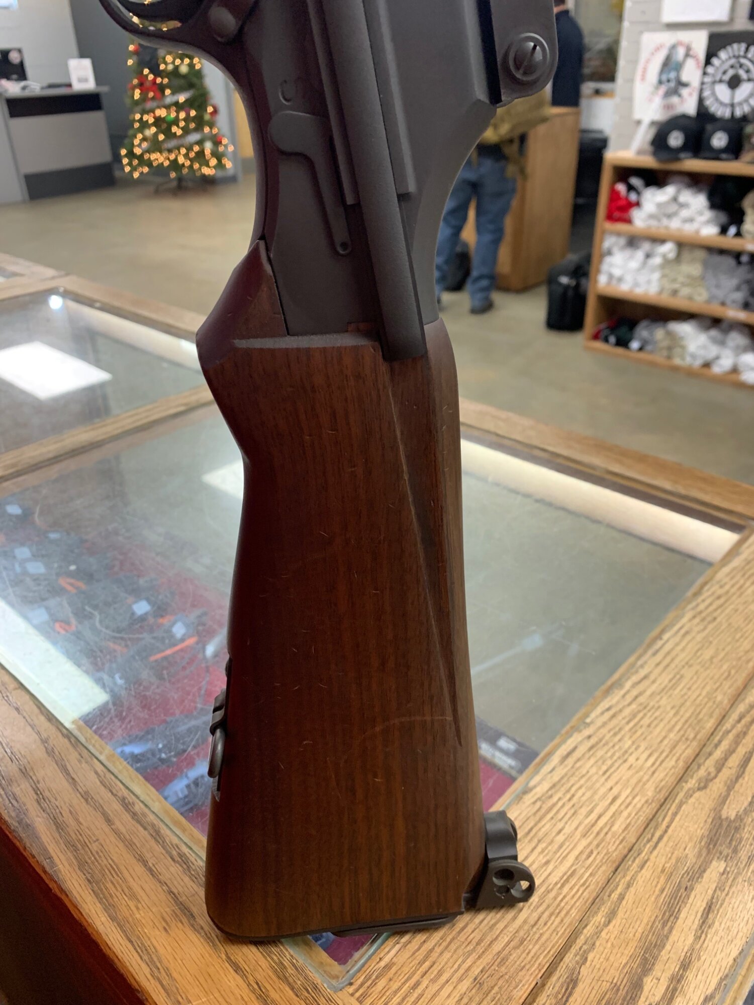

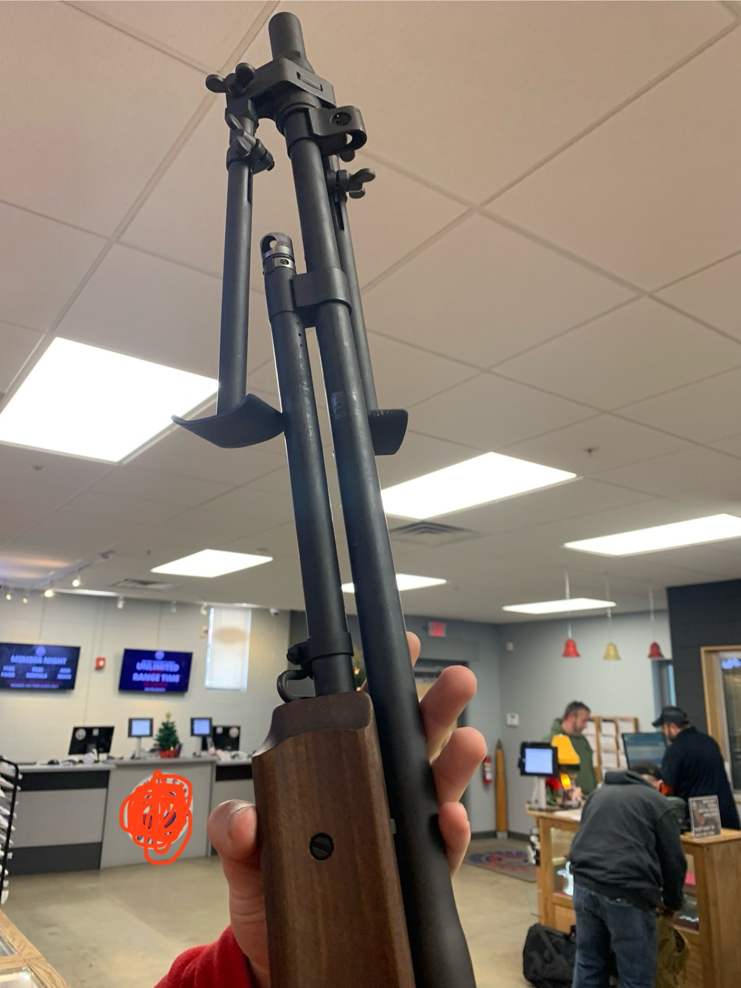

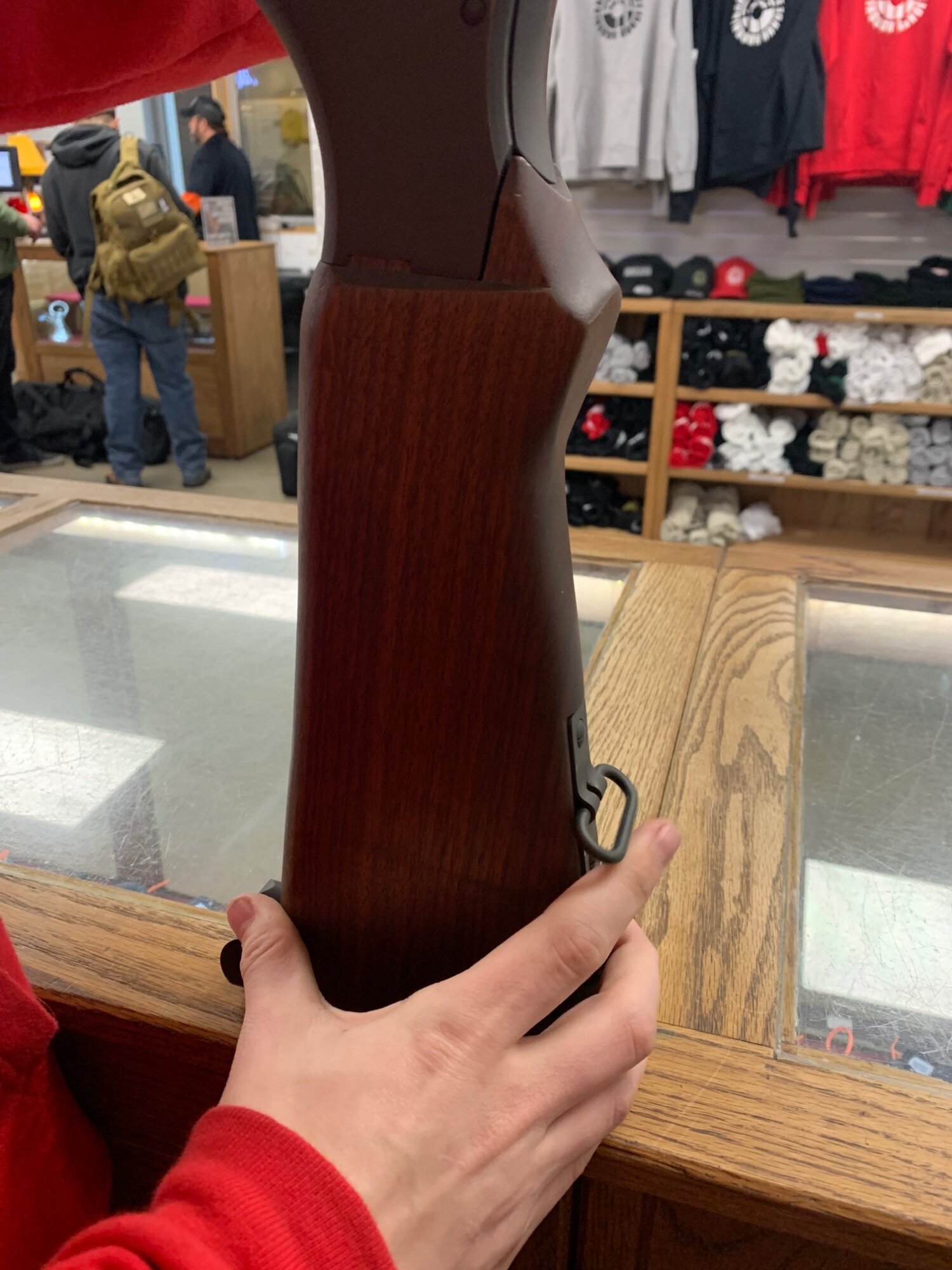

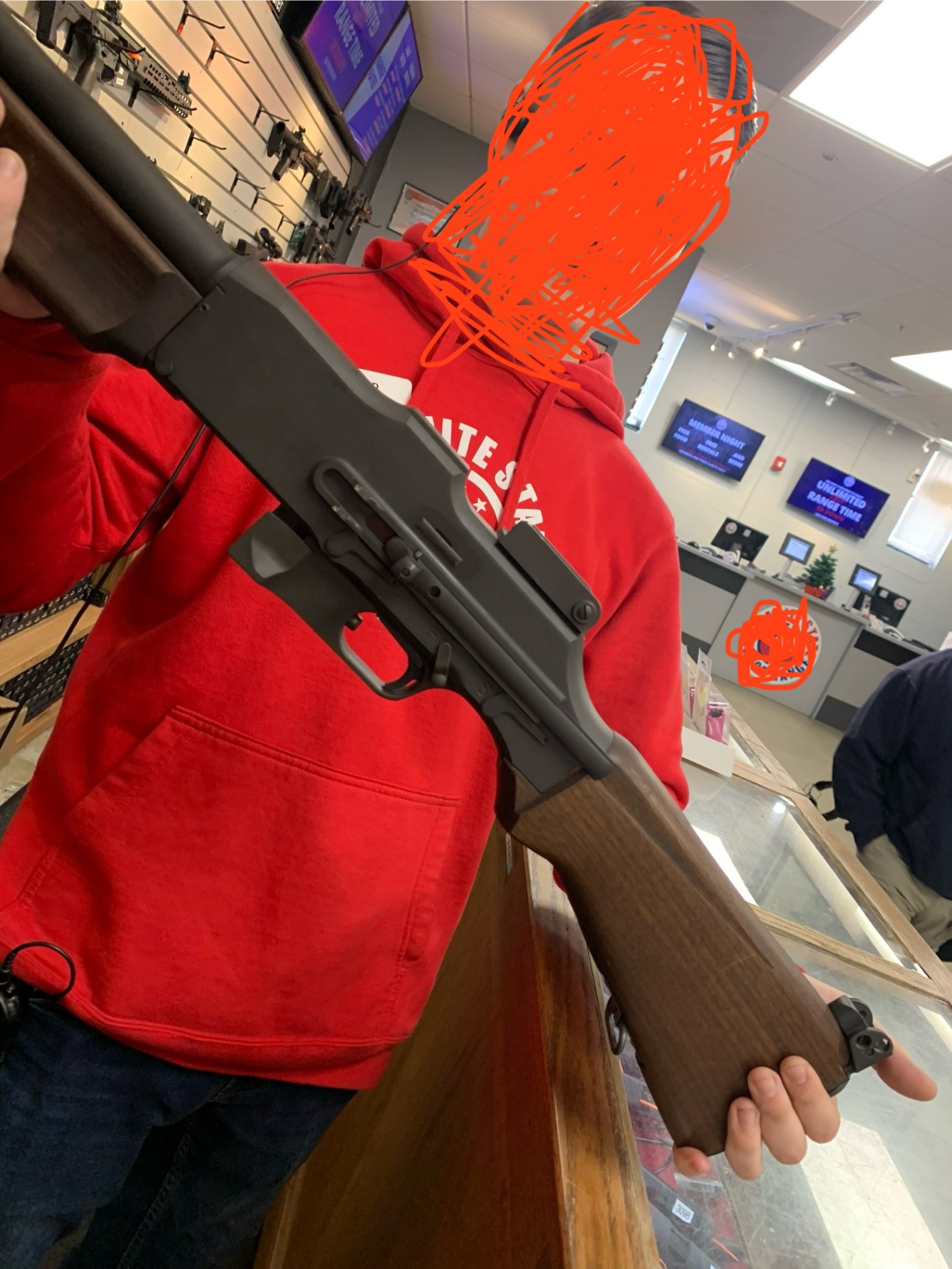

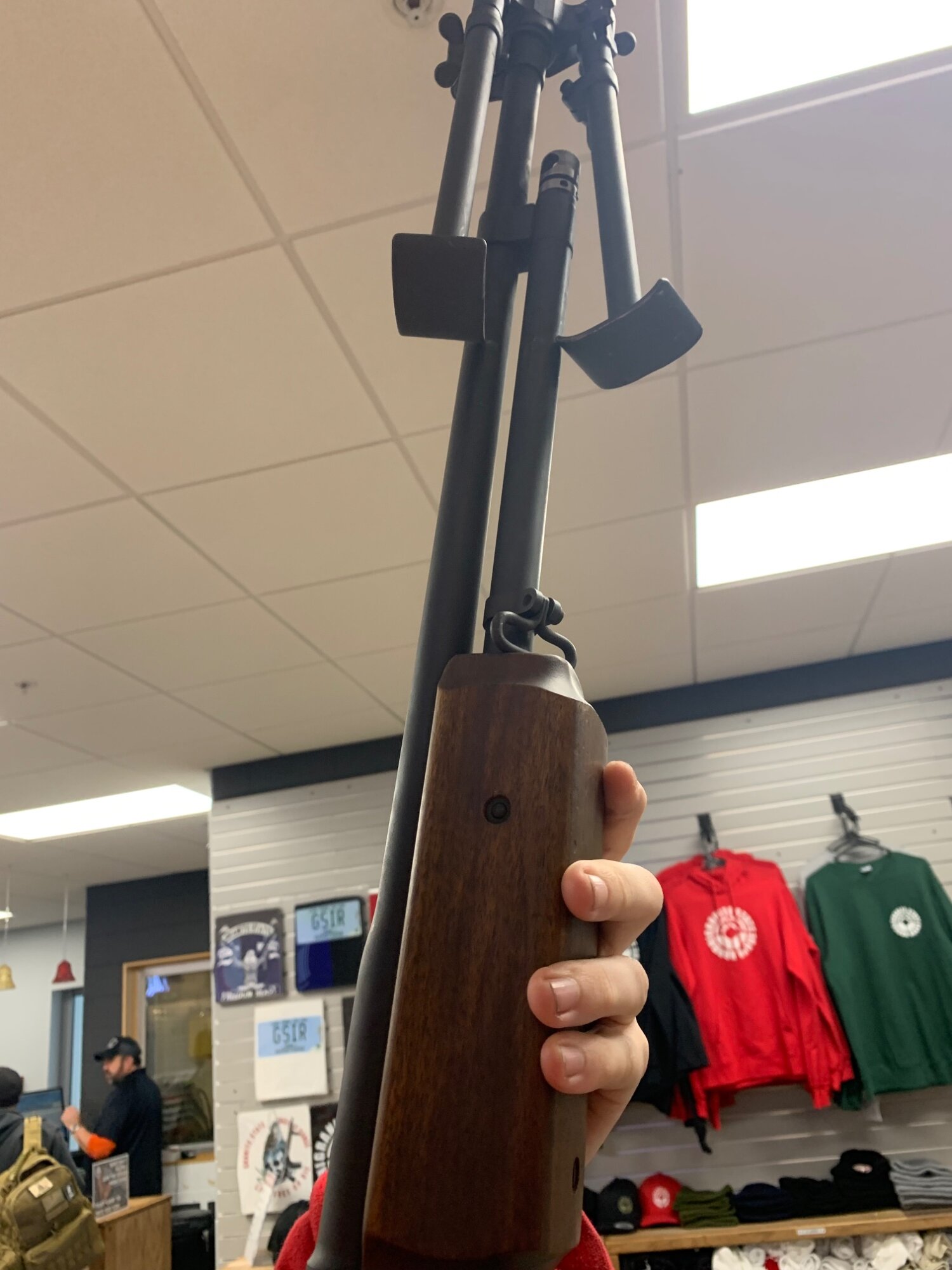

Mattg203 Posted August 25, 2024 Report Share Posted August 25, 2024 Hey guys I found an Ohio Ordnance BAR 1918A3 for sale at a too good to pass up price. However, the seller said the firearm has a cycling issue. The firearm will load correctly, fire, but will not cycle. The user has to manually charge the action to feed another round and fire again. Is this an issue anyone has seen before and is it fixable? Thank you for your attention. Link to comment Share on other sites More sharing options...

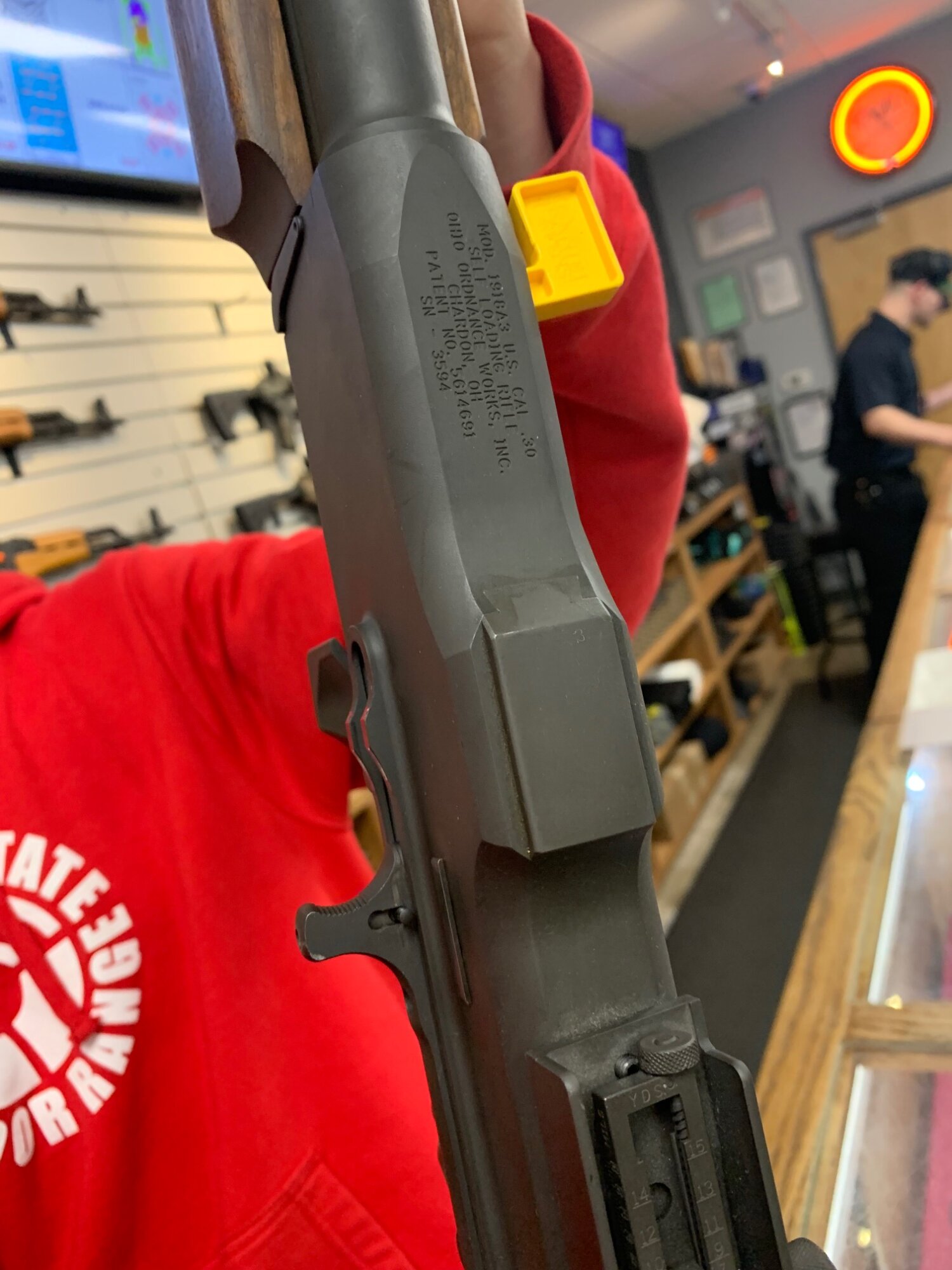

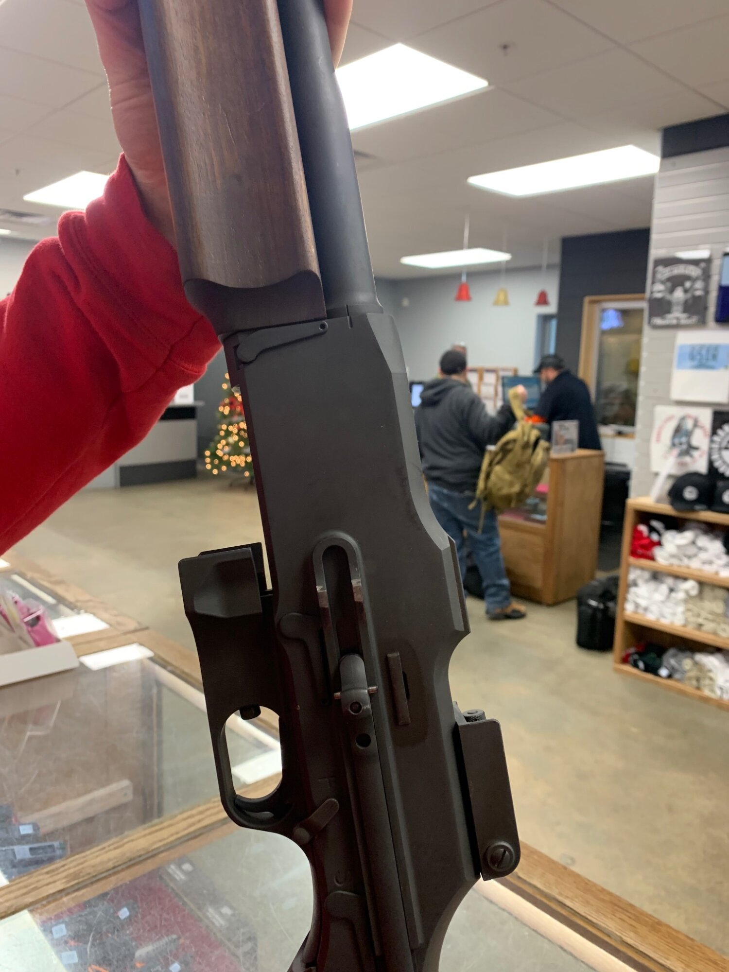

inertord Posted September 13, 2024 Report Share Posted September 13, 2024 Would be great if the OP posts some photos, so we can determine what he actually has. Link to comment Share on other sites More sharing options...
Mattg203 Posted September 26, 2024 Author Report Share Posted September 26, 2024 Here are some pics. Link to comment Share on other sites More sharing options...
