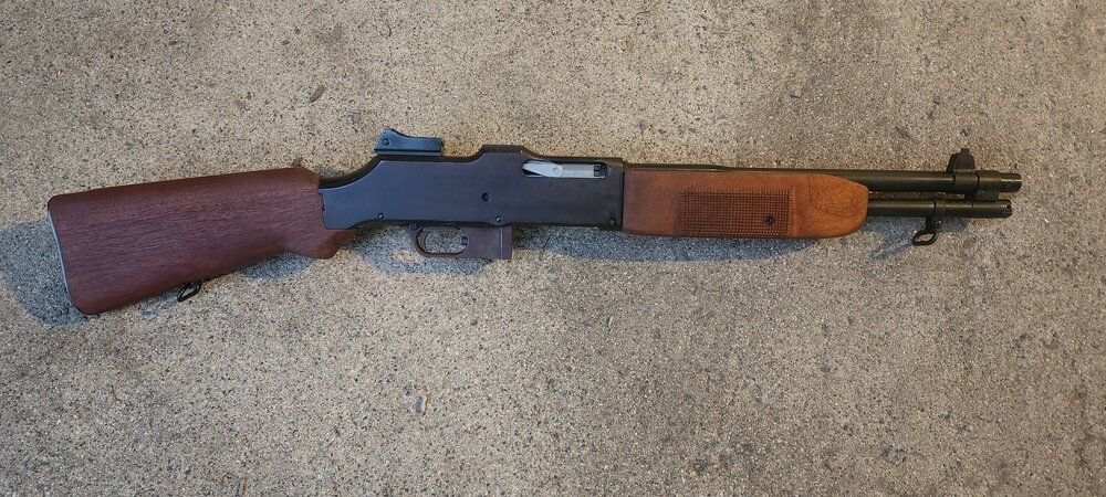

deerslayer Posted September 10, 2024 Author Report Share Posted September 10, 2024 Just finished this one up. Test firing soon! Link to comment Share on other sites More sharing options...

DARIVS Posted September 10, 2024 Report Share Posted September 10, 2024 OMG. The short bar shoots 30-06???! Link to comment Share on other sites More sharing options...
StrangeRanger Posted September 10, 2024 Report Share Posted September 10, 2024 What does it weigh? Link to comment Share on other sites More sharing options...
BPinFL Posted September 10, 2024 Report Share Posted September 10, 2024 How about some more info? barrel length, gas tube mods, stock length, etc. whats ROF? I bet its a flamethrower! Thanks for sharing, BP Link to comment Share on other sites More sharing options...

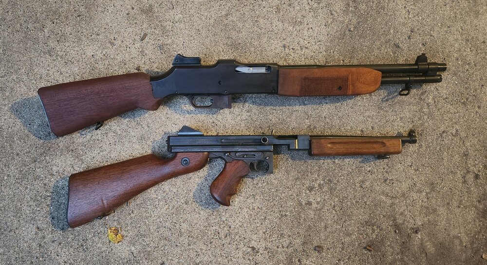

deerslayer Posted September 12, 2024 Author Report Share Posted September 12, 2024 Semi auto Ohio ordnance. 16 inch barrel. How much less would it weigh with 4 inches less barrel? Not much! Butt stock length standard. Gas tube shortened. Made a new short piston on the lathe. Gas block and front sight moved back. Had to increase the diameter of the front sight ring to put it behind the gas block. I thought i added the video. Sorry. It's loud! And lots of fireball muzzle flash. I need to shoot it in the dark. Its fun to shoot! 3 Link to comment Share on other sites More sharing options...

minimike Posted September 18, 2024 Report Share Posted September 18, 2024 I would imagine that’s the only semiautomatic BAR Jungle Carbine in the world. It needs a leather scabbard though. Something similar to the Garand scabbards. Link to comment Share on other sites More sharing options...
