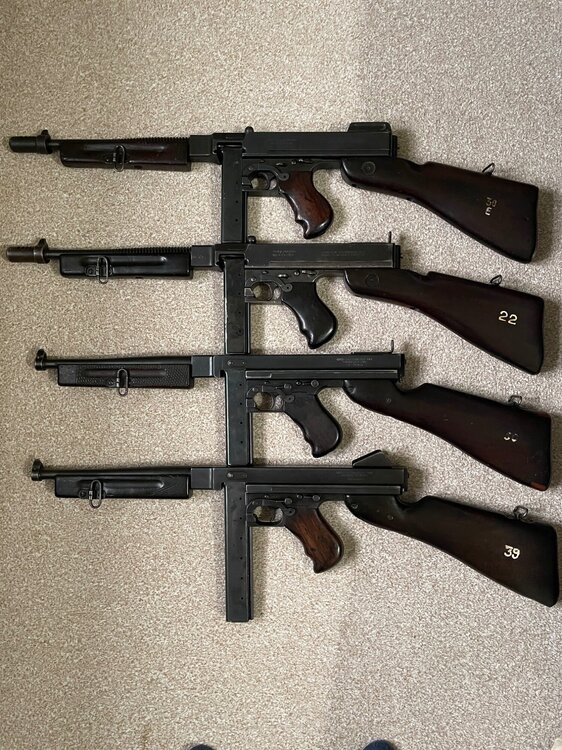

quartermaster-1939-69 Posted October 8, 2024 Report Share Posted October 8, 2024 Can anyone tell me how many Thompsons the US ordered prior to February 1940? The photo is partly for attention, but also slightly related to my research in to British issue sub machine guns. They’re all British contract, commonwealth issue. These came out of India. Thanks in advance! Link to comment Share on other sites More sharing options...

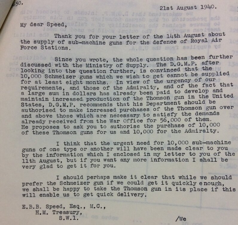

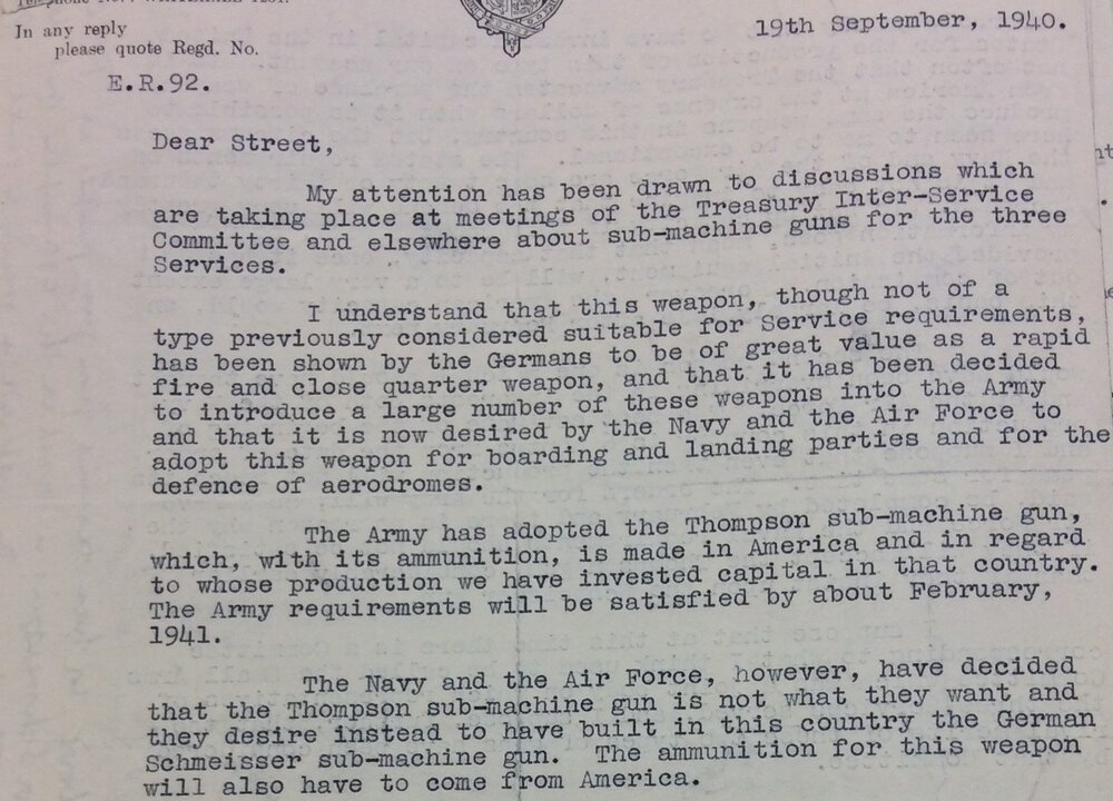

quartermaster-1939-69 Posted October 9, 2024 Author Report Share Posted October 9, 2024 I have your book sitting next to my arm chair as I type! Fantastic book. Below is one of the letters with the reference to the investment and development of the Thompson gun. From memory I've seen four others, including the last ditch attempt from the MoS to stop the Lanchester (Schmeisser) production. I have copies, the below just happened to the be the first I came across. I read the meaning to be that some considerable lump sum has been outlaid to the states to help expand/maintain Thompson production to ensure future supply to Britain, however do you think it's just saying that Britain has already placed and paid for past orders and that was the sum they were referring to? I will dig out the MoS letter, from memory it'll be from early 1941. 1 Link to comment Share on other sites More sharing options...

TD. Posted October 10, 2024 Report Share Posted October 10, 2024 Thank you for the kind words about, Great Britain - The Tommy Gun Story (GB-TTGS). I can tell that you have done some in-depth research by the two documents you posted. It has been a long time since I looked at the documentation James West found at the National Archives and provided to me. A book was never intended. The initial information sought was to document the production of the Model of 1928A or no compensator Thompson submachine gun by Savage Arms for Great Britain. This information resulted in a story in Small Arms Review (SAR) magazine in 2013. But James found so much more information! I believe I understand your theory of Great Britain helping America "develop" with "invested capital" the production of the Thompson submachine gun at Savage Arms in 1940. I don't think those words have the meaning you believe they do. You have to remember the 1920s Thompson submachine gun was obsolete in 1940 when it was placed back into production at Savage Arms. That said, the Thompson gun was a proven design that worked. Actually, it worked very well at its intended purpose. Most importantly, it was available - thanks to the foresight of J. Russell Maguire. After the German army showed the world the value of a submachine gun in 1939, the old military thinking about the submachine gun that wasted large amounts of low velocity pistol ammunition changed - and quickly. And Maguire had the only game in town with his Auto-Ordnance Corporation. Great Britain had placed orders and spent money for the entire factory production run of Thompson submachine guns until the end of 1940. Great Britain was not actually receiving the entire production run but that is a different story. Suffice to say, Great Britain was receiving the bulk of the production. The authorities in Great Britain really wanted locally produced submachine guns; the "Schmeizer" Lanchesters and STENS. However, delivery was of these weapons were many months away and Great Britian could not wait. They needed guns immediately. I believe what the authorities were worried about in August/September 1940 was without future orders (and expenditure of more capital), Savage Arms may move on to the manufacture of other weapons upon completion of the Thompson orders. Of course, that did not happen, and the issue became moot with the passage of the Lend Lease Act in March 1941. I did not find the two documents you posted in my documentation provided by James. However, I don't believe these documents changed anything I wrote on page 15 (The Air Ministry) and page 16 (No Additional Orders?). I encourage you to keep going with your research. Again, I do believe Great Britain did invest capitol to expand ammunition production in the America - Pages 66-69 (Ammunition - fuel for the Gangster Guns). I welcome your research and opinions. If the results change what I have written in GB-TTGS, so be it. I am very open minded and try to write stories that can be expanded on or added to in the future by other researchers. All good stuff!!! Link to comment Share on other sites More sharing options...

TD. Posted October 11, 2024 Report Share Posted October 11, 2024 Do not allow my opinions to put a damper on your research. There may be more information that could buttress your thoughts. Or lead you down a different path. No one person has the answers to everything. I find your posts very serious and informative. There are Thompson purists that despise J. Russell Maguire. William Helmer painted a very poor picture of him in TGTMTTR. Regardless of his personality or personal life, he was way ahead of everyone when it came to the Thompson submachine gun. He also risked a large amount of his own money to gain control of Auto-Ordnance Corporation. The first contract with Savage Arms for 10,000 guns could have resulted in thousands of unsold Thompson guns, again in storage. Of course, that did not happen. Under Maguire's leadership, the stockholders, including the Thompson and Blish families, received enormous dividend payments during World War II. James West (Mk VII) may join in on this thread. He is very knowledgeable on all things British. Forum member StrangeRanger had a beautiful Lanchester display at the 2024 Thompson Collector's Association Show & Shoot. I remember him telling me about how he obtained a copy of a very rare Lanchester manual from Great Britian. If I had a question about Lanchester submachine guns, I would certainly turn to him or James West. There is also a Sten, Sterling, and Lanchester SMG Message Board on MachineGunBoards.com. Please continue to post. And let us know when your book is published. All my books are printed via Kindle Direct Publishing at KDP.com, an Amazon.com company. I find print on demand publishing an excellent platform for niche books about submachine guns. Hardcover is now an available option. Feel free to contact me directly at: tkd5501@fuse.net with questions, or if you just want to talk Thompson. Link to comment Share on other sites More sharing options...

quartermaster-1939-69 Posted October 11, 2024 Author Report Share Posted October 11, 2024 Ahhhhh, I can partly answer the military doctrine question. Yes, there was a tactical need for a sub machine gun, however that wasn't the main reason they placed such large orders. A memo dated December 1940 states that there were 1,550,000 .303 rifles available. Projected production for 1941 was estimated to be 180,000 which left a deficit of 170,000. This didn't include 200,000 rifles India had requested. Rifle production wasn't expected to have caught up with demand until the end of 1942 so whilst the sub machine guns (well, machine carbines) were originally ordered for a tactical reason, the main reason for their production and purchase was to relieve and supplement rifle production. The admiralty stated that they treated the issue of the Lanchesters and rifles as interchangeable and there was a question about whether they gave up all their rifles and replaced them with Lanchesters. I can't remember which file it was in but there a letter regarding Thompsons being phased over to India when quantities of Sten became available. I'll confess I skimmed over it slightly, however I presumed it was for similar reasons to ease the strain on rifle production. I'd love to see a copy of the French Lanchester manual! I managed to track down the 1942 manual and also the exceptionally rare 1941 manual. Below is one of the photos which formed the basis of the lines drawing in the 1942 Naval user manual BR 832. Note the gun he's holding.... If anyone has any Lanchester questions, I can't guarantee I'll know the answer but always love a chat, so ping them over on the Lanchester discussion group. Link to comment Share on other sites More sharing options...
