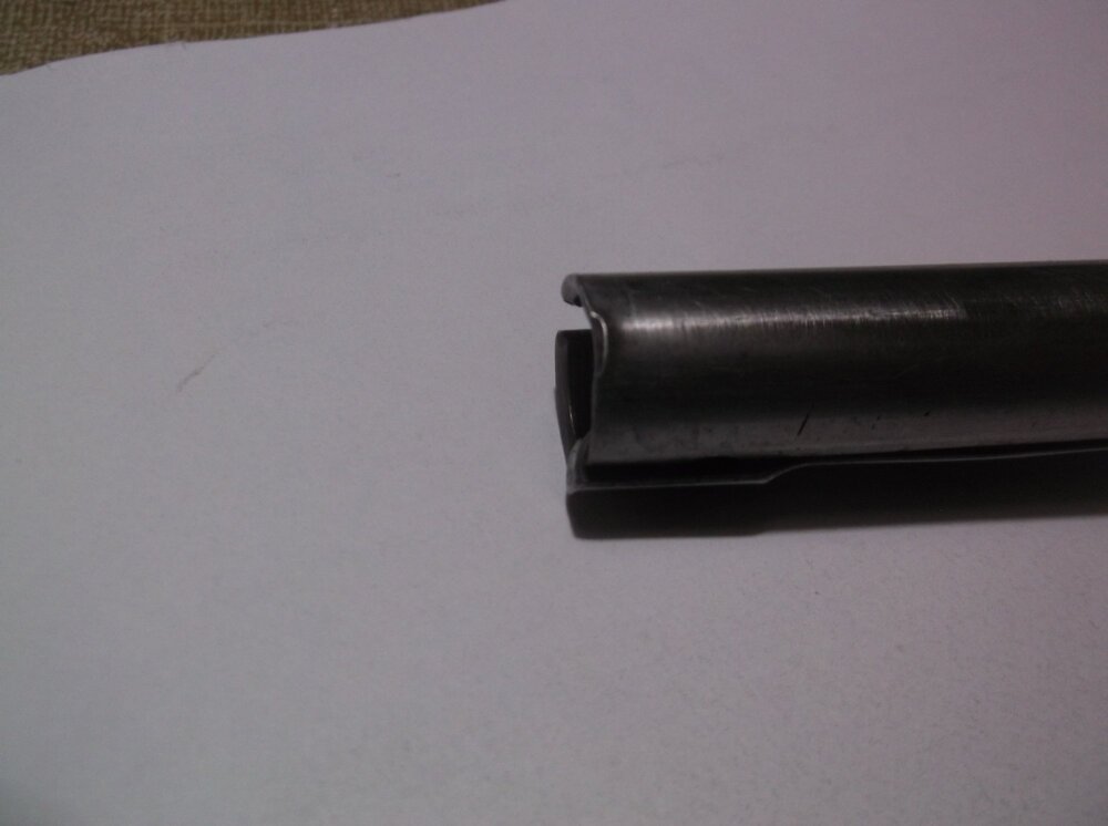

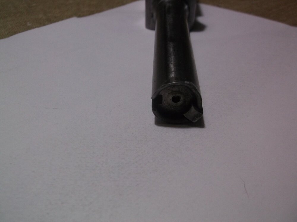

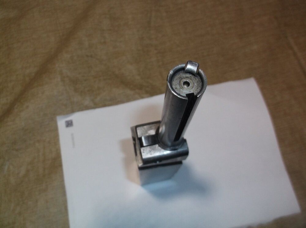

Moose1 Posted October 15, 2024 Report Share Posted October 15, 2024 Gentlemen A friend and I were at the range with our Thompsons. We both have WH 28 with all GI parts (bolts, actuators, lower- barrels). His 28 started to jam, FTF. We took his apart and found that the bolt rim/lip was smashed/bent out at the bottom (feeding side). He did not drop the bolt, but he was using Winchester and Wolf, both are Steel case ammo. Has anyone experience this before? If so, this is a good reason not to use steel case ammo. Thanks Moose Link to comment Share on other sites More sharing options...
Got Uzi Posted October 15, 2024 Report Share Posted October 15, 2024 Steel case ammo will do that. It’s been documented since WWII that shooting steel case ammo in Thompson’s will screw up the bolt nose, case in point. Link to comment Share on other sites More sharing options...
Moose1 Posted October 16, 2024 Author Report Share Posted October 16, 2024 Roger that. Thanks for the info Got Uzi Moose Link to comment Share on other sites More sharing options...
bug Posted October 16, 2024 Report Share Posted October 16, 2024 Just curious. Who made the bolt? There should be letters on the back. Link to comment Share on other sites More sharing options...

Moose1 Posted October 16, 2024 Author Report Share Posted October 16, 2024 Bug I will have to check with him and see whose stamp is on it. I remember us buying them and all the GI parts at the creek. As for steel case, I use the Romanian 8mm steel case in my FA Browning 1919 and it runs very good. Also use steel case in my Colt M16 chambered in 9mm. Do not use it in the M16 in 223, Thompson or the SW76. Thanks Moose Link to comment Share on other sites More sharing options...

Got Uzi Posted October 17, 2024 Report Share Posted October 17, 2024 Look up the British armorer notes on steel case ammunition during WWII and then decide “during an ammunition shortage brass case 45acp ammunition will be held in reserve for units predominantly issued Thompson’s. Units predominately issued M3’s will be issued the steel case ammunition” this was due to the steel case ammo breaking bolt heads as you have seen in the OP’s pics. But do as you will as it’s your own gun, ammo, and repair bill if something happens. 2 Link to comment Share on other sites More sharing options...

Countryboy77 Posted October 17, 2024 Report Share Posted October 17, 2024 (edited) I'm pretty sure that bolt can be repaired,I know I would/could,if your buddy is going to trash it see if he wants to get rid of it.I would heat it with some voltage and tap it back and finish reharden.And ammo is a choice all up to tge individual some guns I will use it in,some I wont.Thompson is a definat wont.A .45 uzi is different it eats everything even supers Edited October 17, 2024 by Countryboy77 Link to comment Share on other sites More sharing options...
Got Uzi Posted October 17, 2024 Report Share Posted October 17, 2024 Or for less that $100-$200 why risk it in a $20,000+ gun? If you can afford the gun, don’t cheap out on replacement parts or ammo. Trying to fix a bolt like this makes no real sense as you can literally find dozens of NOS 1928 type bolts for not much money. Cost you more time and effort than it’s worth. Link to comment Share on other sites More sharing options...
Countryboy77 Posted October 17, 2024 Report Share Posted October 17, 2024 I thought this was a rarer M1 bolt with the hammer that's the Only reason I woukd repair. If it was a 28 yes buy anotger,bet if it was a 1921 MANY would try to repair.He can buy a 28 bolt and use the conversion block to use it in the m1. Link to comment Share on other sites More sharing options...
TSMGguy Posted October 17, 2024 Report Share Posted October 17, 2024 I've fired a lot of WWII Chrysler Evansville EC ammo and have found it to be utterly reliable but very smoky and dirty. It does no damage. The resulting sludge is easily cleaned up by regular cleaning methods. Over five billion rounds of .45 ball ammo were produced by the US during WWII. Steel cased ammo was relegated to stateside training only. Ammo issued in combat theaters was all brass cased. Steel cased ammo was provided to US allies under various assistance programs. 1 Link to comment Share on other sites More sharing options...
Got Uzi Posted October 17, 2024 Report Share Posted October 17, 2024 (edited) The OP stated it was in a WH 1928 gun and you can see the Blish slots in the pic so no reason you should have thought it was an M1 when it clearly was stated it was not the case. That last statement isn’t entirely true as steel cases from 45 ammo was found on ETO battlefields. Again something that has been documented. Edited October 17, 2024 by Got Uzi Link to comment Share on other sites More sharing options...

Moose1 Posted October 19, 2024 Author Report Share Posted October 19, 2024 Bug He said the bolt is marked with a S, Savage. TD Yes, I need to join and attend both of the club's events. I met some of the guys at the Novi antique show when they had the Thompson display. I brought in some finned Thomspon barrels and other parts to ask some questions about them. I met the late Mike Wank, Roger, Phil and Tracie. Great guys- very knowledgeable. I worked with Dave Evans at TACOM (Tank arsenal) and he is a member. FYI, we have a TACOM event, where we rent the Pontiac Lake range (in Waterford) six times a year. The last shoot is coming up Oct 29th, 9am to 4. They charge $15 for the whole day if anyone is available. Thanks Moose Link to comment Share on other sites More sharing options...
