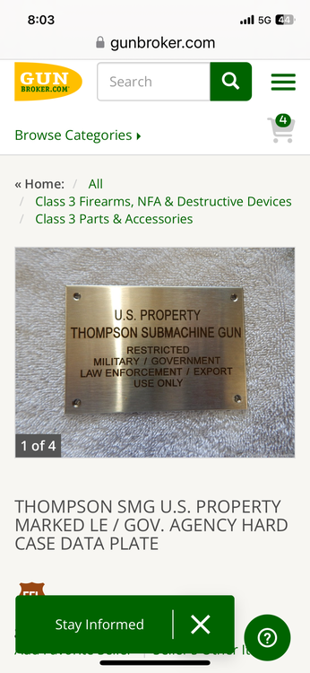

inertord Posted October 25, 2024 Report Share Posted October 25, 2024 Seller has all kinds of rare TSMG Items! “THOMPSON SUB MACHINE GUN U.S. PROPERTY MARKED 3"X4" STAINLESS STEEL DATA PLATE TAKEN OFF A DECOMISSIONED MILITARY / LAW ENFORCEMENT / GOVERNMENT AGANCY THOMPSON SUB MACHINE GUN HARD STORAGE / CARRY CASE LIKE NEW.” Link to comment Share on other sites More sharing options...

Frank I. Posted October 25, 2024 Report Share Posted October 25, 2024 That engraving looks very suspect. IMHO FAKE!! Link to comment Share on other sites More sharing options...
ron_brock Posted October 25, 2024 Report Share Posted October 25, 2024 Looks to be the same font used on both items too. I bet we see more rare engraved items with the same font Link to comment Share on other sites More sharing options...
