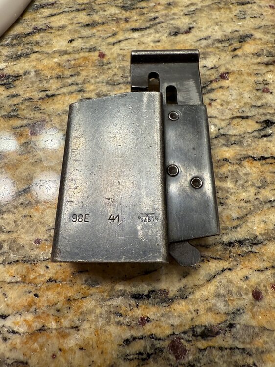

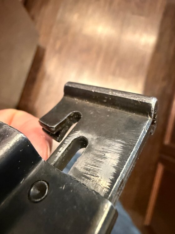

signal_4 Posted October 27, 2024 Report Share Posted October 27, 2024 I’m up in Portland Oregon this weekend and stopped by The Warfront shop and picked up this Steyr-Daimler-Puch AG, Werk Steyr (A) 98E. Very Cool ! Link to comment Share on other sites More sharing options...

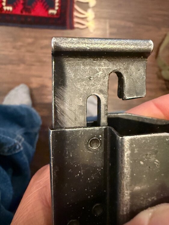

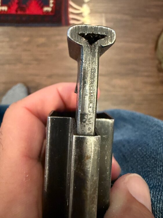

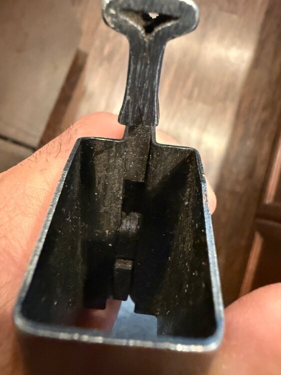

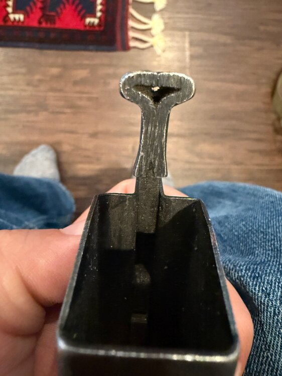

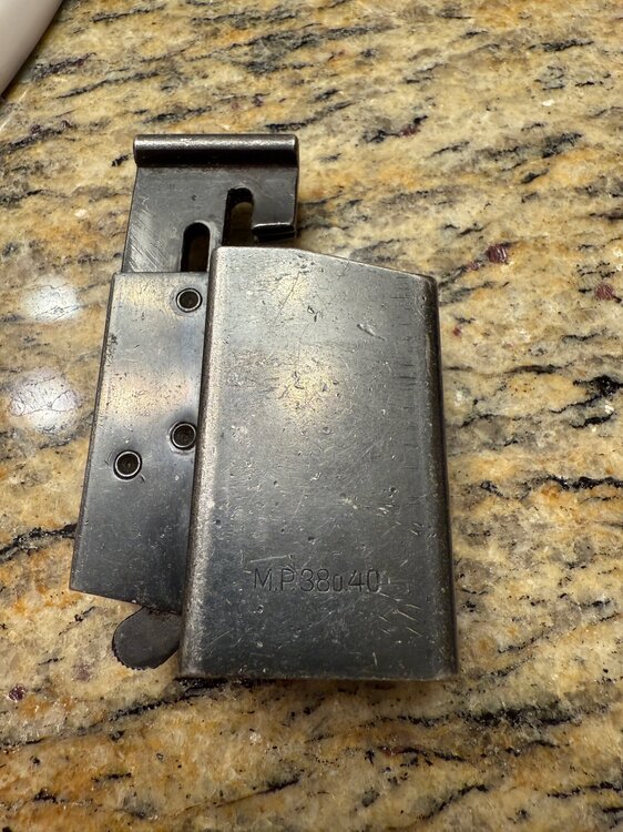

signal_4 Posted October 27, 2024 Author Report Share Posted October 27, 2024 (edited) 3 hours ago, TSMGguy said: Just for discussion: Hmmmm ok. I took some closer pictures but I can get better ones later. I know the people at that shop are pretty reputable and knowledgeable. The loader was behind glass and in consignment. I’d really like to know now cause if the consensus is repo I’d like my $225 back. I don’t see any evidence of welding. And the action is very smooth. https://www.thewarfront.com Edited October 27, 2024 by signal_4 1 Link to comment Share on other sites More sharing options...
TSMGguy Posted October 27, 2024 Report Share Posted October 27, 2024 (edited) Your loader looks legit to me. The rivets are right, as are the markings. There is no evidence of grinding on the loader body. I think you got lucky. That said, MP40 loaders have been extensively reproduced. They're something I no longer buy unless I have the chance to examine it first. Loaders and mags made by Steyer have about the best quality of several manufacturers. They invariably fit and function perfectly. The 98E code changed to kur in early 1942. At The Front offers kur loaders as reproductions for about $80. They're perfect and can't be told from originals. MP40 Loader Edited October 27, 2024 by TSMGguy Link to comment Share on other sites More sharing options...
Rekraps Posted October 27, 2024 Report Share Posted October 27, 2024 18 hours ago, signal_4 said: I’m up in Portland Oregon this weekend and stopped by The Warfront shop and picked up this Steyr-Daimler-Puch AG, Werk Steyr (A) 98E. Very Cool ! Yours looks to be the real McCoy. The Waffenstamp is correct. Fake ones usually omit this. Link to comment Share on other sites More sharing options...

signal_4 Posted October 27, 2024 Author Report Share Posted October 27, 2024 5 hours ago, TSMGguy said: Your loader looks legit to me. The rivets are right, as are the markings. There is no evidence of grinding on the loader body. I think you got lucky. That said, MP40 loaders have been extensively reproduced. They're something I no longer buy unless I have the chance to examine it first. Loaders and mags made by Steyer have about the best quality of several manufacturers. They invariably fit and function perfectly. The 98E code changed to kur in early 1942. At The Front offers kur loaders as reproductions for about $80. They're perfect and can't be told from originals. MP40 Loader Ok thank you. Whew. After reading your post from 2012 I thought you had spotted something on mine that was dead give away. 1 Link to comment Share on other sites More sharing options...
