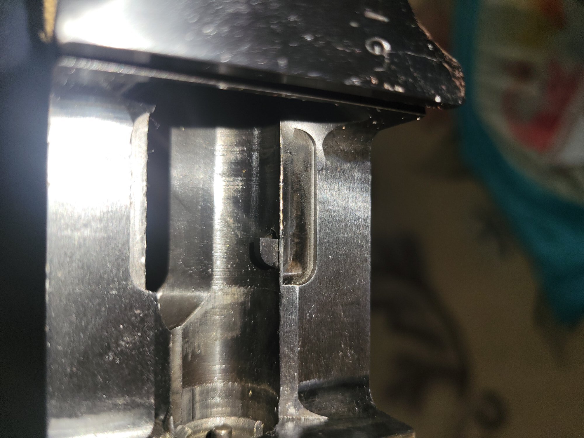

Countryboy77 Posted November 20, 2024 Report Share Posted November 20, 2024 (edited) How does your ejector look? Is it popped through the receiver,double feed is usually a fail to eject and a fresh round,or is it 2 fresh rounds?And if Dan installed the barrel I would imagine he test fired it before sending it to you. Edited November 20, 2024 by Countryboy77 Link to comment Share on other sites More sharing options...

HistorianInProgress Posted November 24, 2024 Author Report Share Posted November 24, 2024 Sorry guys, just got back from vacation. I actually emailed Dan earlier this week and he said he'll check it out, no cost. I'll try to take it out again today, also to test a drum I just got, and will otherwise be mailing it to him in the next day or two. To answer you guys though: Cowboy, here's a photo of my ejector. I assume it's in place correctly, but not sure. Peter, Dan didn't modify my mag catch to accept surplus. Unfortunately I don't have anything to compare it with, but the issue is present with original Kahr mags as well as a surplus I modified. Troll, I suppose that's possible. I'm not sure how effective the extractor is supposed to be, but compared to other guns it seems strange I can't reliably, manually cycle the gun. Link to comment Share on other sites More sharing options...

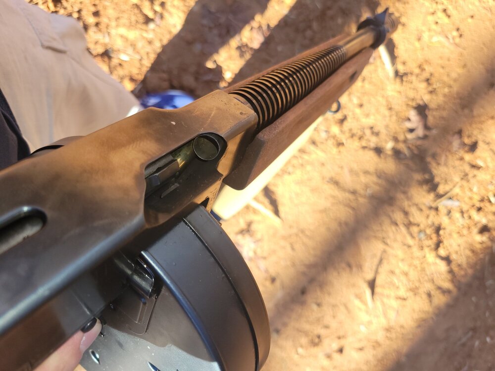

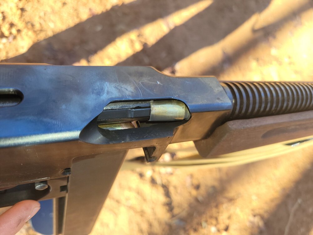

HistorianInProgress Posted November 24, 2024 Author Report Share Posted November 24, 2024 Follow up from the range. I'll preface it by saying it's not the best sample size, as I was down to my last box of 45acp; S&B 230gr. I loaded 15 in the drum, and 10 each in one Kahr and one surplus mag. With all three I decided to fire as quickly as I could pull the trigger, and experienced two malfunctions. Both malfunctions were a failure to eject a spent casing (photos attached). I thought the second malfunction was amusing, in that the spent casing managed to completely turn around backwards and the bolt attempted to rechamber it backwards. On the other side was a live round, which was fully chambered. Link to comment Share on other sites More sharing options...
peter kohler Posted November 25, 2024 Report Share Posted November 25, 2024 (edited) first unload the gun then slowly pull the bolt back and see how far into the bolt the ejector id riding mine is about half way to the middle of the bolt im wondering if your extractor is fully seated or there may be dirt underneath again your mags half to sit tight against the upper part of the receiver. and your feed lips may be bent if you had success with all the other mags and the drum then this mag may be the problem Edited November 25, 2024 by peter kohler Link to comment Share on other sites More sharing options...
DARIVS Posted November 26, 2024 Report Share Posted November 26, 2024 On 11/24/2024 at 1:45 PM, HistorianInProgress said: Follow up from the range. I'll preface it by saying it's not the best sample size, as I was down to my last box of 45acp; S&B 230gr. I loaded 15 in the drum, and 10 each in one Kahr and one surplus mag. With all three I decided to fire as quickly as I could pull the trigger, and experienced two malfunctions. Both malfunctions were a failure to eject a spent casing (photos attached). I thought the second malfunction was amusing, in that the spent casing managed to completely turn around backwards and the bolt attempted to rechamber it backwards. On the other side was a live round, which was fully chambered. The first thing to check is the recoil springs, which may be too light. Try the rifle with the original springs and see if it fires reliably. This may be a long shot, but if the bolt face doesn't line up axially with the chamber, couldn't that result in the ejector slipping off the rim upon extraction? The receiver would have to be milled incorrectly or the chamber be off axis within the barrel, but stranger things have occured with these Kahr rifles. Ask Dan to check bolt alignment with respect to the barrel. A cylindrical object that fits precisely in the chamber (similar to that empty case in your photo above) could be inserted and checked against the position of the boltface. When there is an issue with these rifles, it is often a combination of things which need to be checks to make them behave properly. My 1927A-1 made in 2000 was SBR'd, and Dan noticed a couple of factors that resulted in the firing pin being snapped off every 800 rounds or so. In my case, the firing pin guide surfaces were not in tolerance such that the pin would be impacted lightly from the side every time it moved forward. Multiple impacts eventually snaps off the pin. The part which acts firing pin is a silly weird shaped piece of crudely stamped hardened sheet steel with a small nub for a pin on the front. It requires sanding and polishing to move smoothly and sometimes needs to be adjusted in shape to operated in your gun properly, which was second issue. The base of the nub of a pin has a sharp cornered inside edge, which is a natural stress riser, hence my problem. Dan had to remove the metal which was being struck by the side of the pin to remove the impact. That adjustment was not easily assessed. Link to comment Share on other sites More sharing options...
