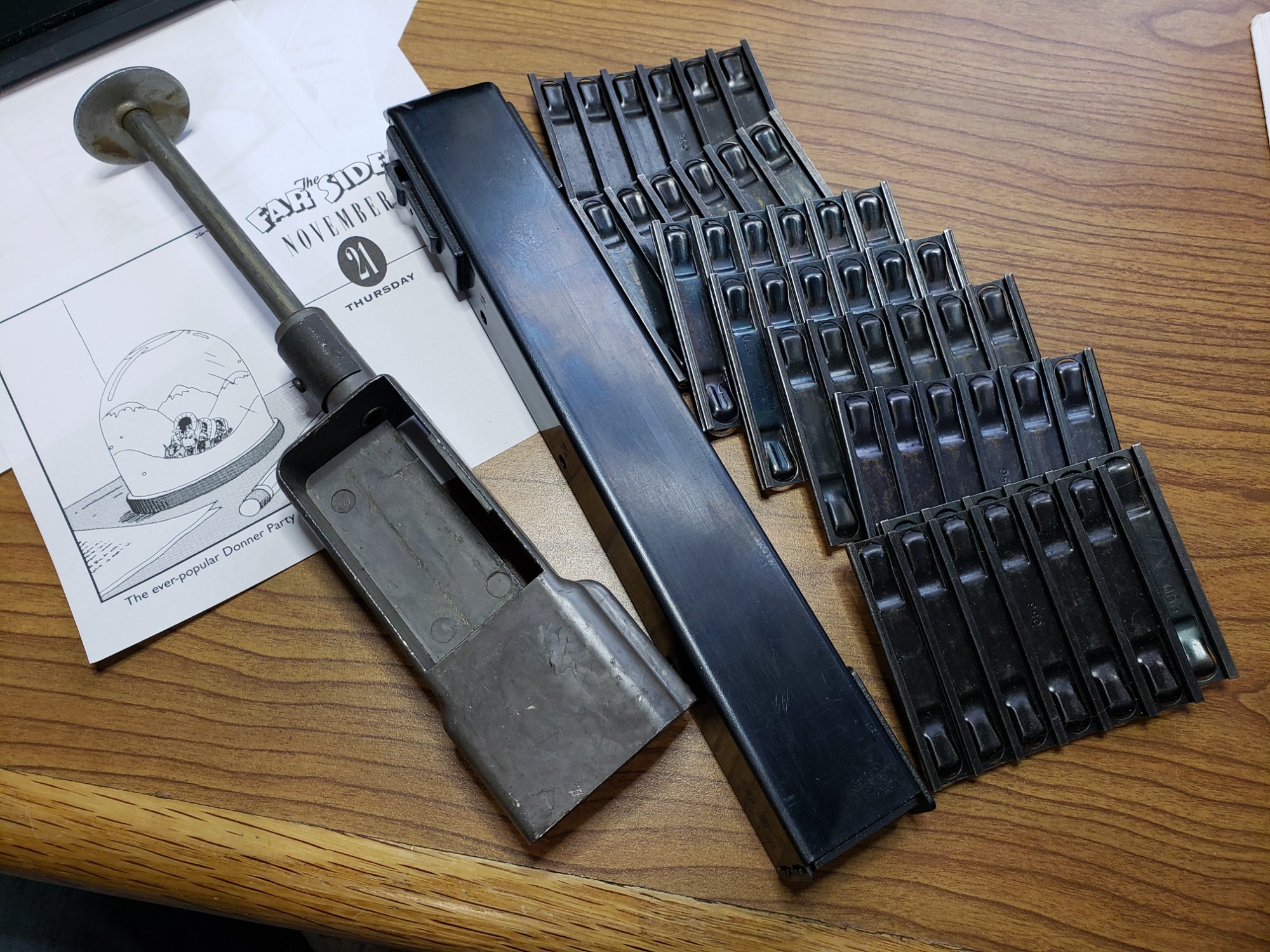

Lewisfan Posted November 23, 2024 Report Share Posted November 23, 2024 Pic of Swedish K loader with stripper clips. Link to comment Share on other sites More sharing options...
BillinBama Posted November 23, 2024 Report Share Posted November 23, 2024 18 hours ago, Rekraps said: I thought I bought them all? You may have, but I keep finding things that I had forgotten about, so.... I'd plead the 5th but I can't remember what that is. Link to comment Share on other sites More sharing options...
Rekraps Posted November 24, 2024 Report Share Posted November 24, 2024 On 11/23/2024 at 12:26 AM, Lewisfan said: Pic of Swedish K loader with stripper clips. That's the ticket! Probably the best loading system ever made. I use it for both the M76 and my K's. Link to comment Share on other sites More sharing options...

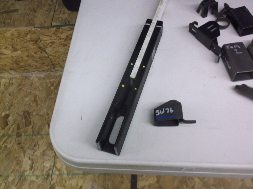

Moose1 Posted December 16, 2024 Report Share Posted December 16, 2024 When I bought my SW76 it came with a slide loader (no name was on it) You loader 13 or 15 rounds in the slot and push the handle to load the mag. Same thing like the RAE but bigger. I bought and tried the RAE loader, the loader fit the mag, but could not fit the rounds in the slot. Called them numerous times, said they would do something, but never did. Called Ebay and they resolved the returning problem. I wish it would have worked out. They said their engineer quit. I also bought a steel loader like the one on Ebay (Customer loader) the loader works but it's not fast. I cannot remember the name of the company. They also had PPS43 mag loaders. I will look for my paperwork and see what I can find. Both loaders are in the barn, I will take pictures tomorrow. Cammaga (spelling?) use to make loaders, but now he makes customer knives. I was at his house (Muskegon Mi Area) for a small shoot. I showed him my push loader and asked him if he could make some. He had one of Brain's BRP sub guns that use Suomi mags. So, I was hopeful. It's been four years, so either he forgot or is too busy. Moose Link to comment Share on other sites More sharing options...
Moose1 Posted December 16, 2024 Report Share Posted December 16, 2024 Gents I went and took a picture of the 76 loaders. The slide one works nice, if the rounds do not tip over in the slot while loading it and if the magazine does not move in the holder. I have no idea who made, I acquired this from an estate sale (the guy was deceased). I might have to order the one off of Ebay for a backup. (you can never have too many backup), plus more people can help me load since they want to shoot it. Thanks Moose Link to comment Share on other sites More sharing options...
Moose1 Posted December 16, 2024 Report Share Posted December 16, 2024 I just opened up Ebay to look at the RAE loader for some reason. Hmmm, Inflation. I paid $25 for the one I bought and returned. Maybe that is why It was cheaper? LOL Link to comment Share on other sites More sharing options...
Outsider Posted December 17, 2024 Report Share Posted December 17, 2024 is the slide one cut out of plastic or printed? Link to comment Share on other sites More sharing options...
Moose1 Posted March 11, 2025 Report Share Posted March 11, 2025 Outsider Just seeing your post. Sorry. The slide looks like one piece of plastic. It does have some wear on the round side from pushing them in. I'm very happy with it, but always looking because I know someday it will break. Thanks Moose Link to comment Share on other sites More sharing options...
