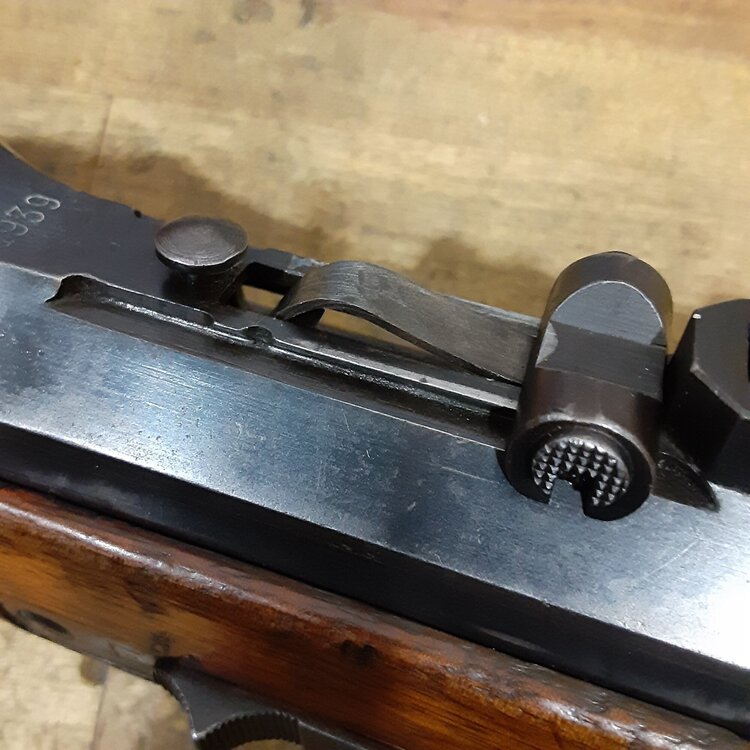

StrangeRanger Posted November 26, 2024 Report Share Posted November 26, 2024 It had some issues: The top-cover mounted safety was damaged the first and only time I took it to the range. The safety was in the off position but somehow it caught the safety notch in the bolt and got pretty thoroughly bent and blocked any movement of the bolt. The trigger pull was atrociously heavy. The spare bolt has a 9mm Steyr bolt face and wouldn't accept a 9 Para/7.62 Tok sized rim and the firing pin protruded too far. The extractor in the spare bolt was bent. The most critical problem was obviously the safety which kept it from running. I took it to Gary Szechy (Gary's Bunker.) He said the safety could not have bent like it did if it had been heat treated; turns out it was dead soft. He straightened it and heat treated it and it now it is strong enough that it cannot possibly be moved accidentally. He brought the spare bolt into spec and repaired its extractor. He disassembled and polished the Firing Control Group and brought the trigger pull down to a very smooth and light but safe level. The gun now runs 100% with either bolt in both semi and full auto. Gary's turnaround time was unbelievably quick and the cost was surprisingly low. He's got a waiting list but his work is worth the wait. Link to comment Share on other sites More sharing options...

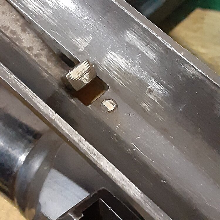

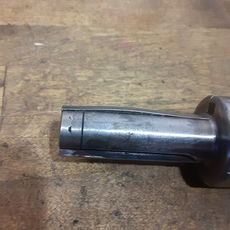

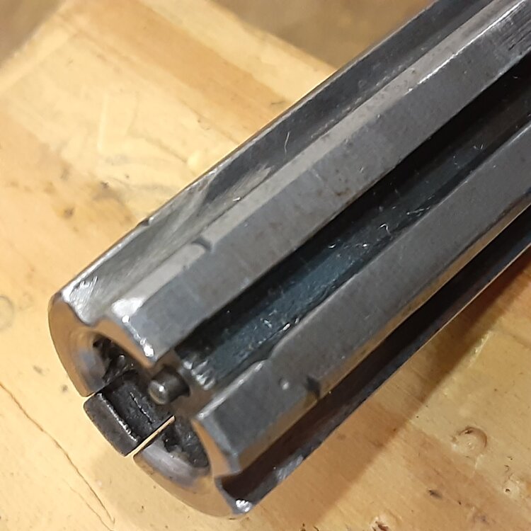

StrangeRanger Posted November 28, 2024 Author Report Share Posted November 28, 2024 Here's the damaged safety from above: and below: Here's the bolt face and firing pin guaranteed to pierce primers: and the extractor that didn't The safety and the extractor are both springs and I learned the hard way not to cold bend springs. Gary cleaned the mess up quickly Link to comment Share on other sites More sharing options...

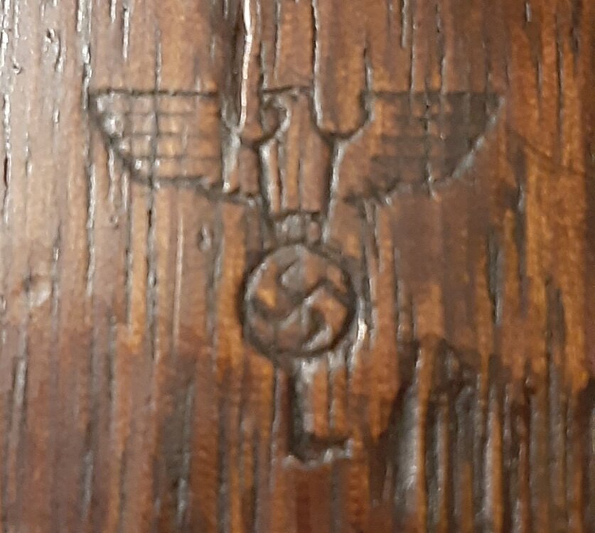

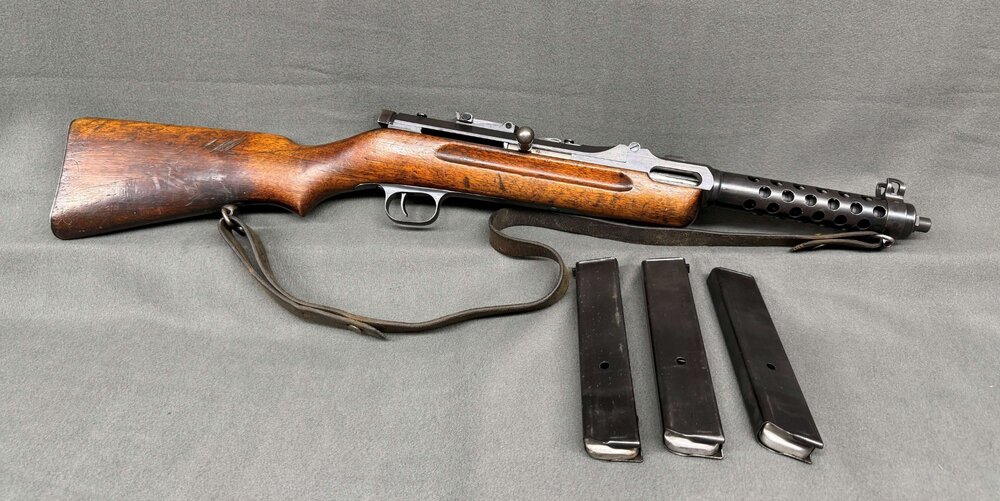

StrangeRanger Posted November 29, 2024 Author Report Share Posted November 29, 2024 Here's the gun: and the Luftwaffe Waffenamt Link to comment Share on other sites More sharing options...

APEXgunparts Posted September 20 Report Share Posted September 20 On 11/28/2024 at 10:19 AM, StrangeRanger said: Here's the damaged safety from above: and below: Here's the bolt face and firing pin guaranteed to pierce primers: and the extractor that didn't The safety and the extractor are both springs and I learned the hard way not to cold bend springs. Gary cleaned the mess up quickly Looking at that bolt it would appear it was a restored dewat. I have seen an MP28 with the bolt face ground off, firing pin opening welded over, firing pin tip cut off and the barrel chamber welded closed. Back in the day an importer sold a 3 pack of dewats, all prewar classic SMG's, MP28, MP34and I forget the 3rd. This may have been one of those dewats. Richard Link to comment Share on other sites More sharing options...
StrangeRanger Posted September 21 Author Report Share Posted September 21 It was a dewat and not a very well done one. The bolt face matched 9mm Bergmann/Longo not 9 Para/.30 Tok and the ID cavity was too deep allowing the FP to protrude too far. Rather than modifying the FP which was in spec, Gary made up a spacer that fit over the shoulder and corrected the protrusion. The extractor was bent outwards at the base and was a bit soft. He straightened and heat treated it. Link to comment Share on other sites More sharing options...
