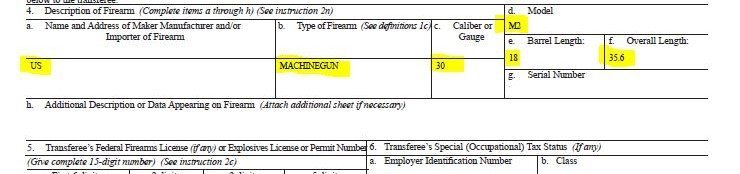

Archmark Posted November 29, 2024 Report Share Posted November 29, 2024 I just received an approval for an authentic roll-stamped Inland M2 Carbine manufactured around 6/45 (Serial #7506XXX). On the Form 4 in Box 4A the "Name of the Maker, Manufacturer and/or Importer of Firearm" is listed as "US", not Inland. My FFL/SOT says that he has never seen such a description, especially since the US Government never sold machineguns directly to US citizens. So how did my M2 get this description? Link to comment Share on other sites More sharing options...
Grasshopper Posted November 29, 2024 Report Share Posted November 29, 2024 Hi Archmark, FOIA time Whatever was put on the original paperwork. Doesn't appear to necessarily correspond with reality. FOIA will likely let you know who or what did the initial registration. Enjoy, Grasshopper Link to comment Share on other sites More sharing options...

Frank I. Posted November 29, 2024 Report Share Posted November 29, 2024 Possibly an amnesty registered M2? I have seen countries listed on many foreign guns and even "unknown". Knowledge of machine guns was scarce until books were published and then the internet. 1 Link to comment Share on other sites More sharing options...
Rekraps Posted November 29, 2024 Report Share Posted November 29, 2024 The manufacturer block is an odd bird and one that I don't think the ATF pays attention to. I've had all kinds of things and have spent quite a few hours submitting corrections to the ATF, which, after many months get approved. The Form 4 does not change, but you'll have a stamped ATF correction letter in the event you decide to sell. Then the next Form 4 will reflect the change. Link to comment Share on other sites More sharing options...

MS Collector Posted February 13, 2025 Report Share Posted February 13, 2025 I've had an NFA Branch Examiner tell me that, other than needing to remain consistent from transfer to transfer, the data in the "Manuracturer" box is "not important". She also added that what they do "really focus on" is the SN, caliber, model, overall length, and barrel length boxes . . . those are the "big deal" data points for them. Link to comment Share on other sites More sharing options...

MS Collector Posted February 13, 2025 Report Share Posted February 13, 2025 Rekraps: To compound your frustration, I've been involved in transfers of C&R guns where guys like you came before me in the chain of ownership . . . . and had worked to "correct" stuff like the manufacturer or model information. Then, on the most reecnt transfer (i.e. to me) the form gets rejected because the corrections somehow appear to have been lost by BATFE, so that the NFRTR contines to reflect the original (incorrect) data from the original registration decades ago. I've gotten to the point of taking a "don't mess with it" apporach to this data, unless there is something just so terribly wrong that it may cause a legitmate question about the identity of the gun. Other than that . . . just leave well enough alone and use the information that BATFE has in the NFRTR. Link to comment Share on other sites More sharing options...
