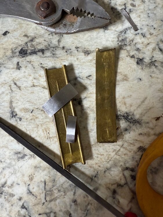

signal_4 Posted December 7, 2024 Report Share Posted December 7, 2024 (edited) Hi ! Does anyone have an extra spring for the rear sight. Or if they are easy to make am can someone tell me how to do it. Thanks ! Edited December 7, 2024 by signal_4 Link to comment Share on other sites More sharing options...

signal_4 Posted December 7, 2024 Author Report Share Posted December 7, 2024 Thanks ! Ya he’s usually my go to person but I think he’s a bit high priced on that one. Seems like it wouldn’t be to hard to make one but I’m no machinist. Link to comment Share on other sites More sharing options...
DavisB Posted December 30, 2024 Report Share Posted December 30, 2024 I've heard of a person taking mauser stripper clips springs and trimming them to size. Was told they worked, but I've not tried it myself. Link to comment Share on other sites More sharing options...

signal_4 Posted December 30, 2024 Author Report Share Posted December 30, 2024 29 minutes ago, Rekraps said: Or, you could take a front mainspring off a surplus jeep and grind it down, or maybe one off a train. Oh I made one last night out of the spring steel in a Mauser stripper clip. Cut it down to size and worked perfectly ! Link to comment Share on other sites More sharing options...
signal_4 Posted December 30, 2024 Author Report Share Posted December 30, 2024 1 hour ago, DavisB said: I've heard of a person taking mauser stripper clips springs and trimming them to size. Was told they worked, but I've not tried it myself. That’s exactly what I did ! Worked perfectly !!!! Thank you Sir ! Link to comment Share on other sites More sharing options...
Rekraps Posted December 31, 2024 Report Share Posted December 31, 2024 17 hours ago, signal_4 said: Oh I made one last night out of the spring steel in a Mauser stripper clip. Cut it down to size and worked perfectly ! Very nice work. Edges look smooth, and polished. Wow. Link to comment Share on other sites More sharing options...
