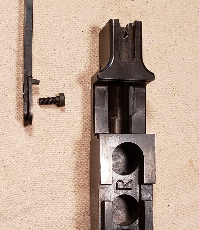

jojeep Posted December 16, 2024 Report Share Posted December 16, 2024 (edited) Been a long time since I looked through Richardson Books, but I remember him mentioning staggered holes drilled with an Indexing Machine into the Barrel to direct gasses into the Suppressor, but the Barrel could be changed with a Quick Disconnect Barrel System. Richardson sold the Tap and Dies in the size of the Thompson's Grip mount bolts. The short Horizontal Grip mount Bolt trimmed down to lock onto a notched area on the Barrel thread. The Grip Mount would be Counter Sunk so that Horizontal Bolt sat flush. This would allow the user to switch from Standard Barrel, or Blank Fire Barrel, or a Suppressor Barrel. Hope the photo helps to see the system. Restoring back to original would be putting an unmodified Grip Mount to hide the threaded hole. Edited December 16, 2024 by jojeep Link to comment Share on other sites More sharing options...
Countryboy77 Posted December 16, 2024 Author Report Share Posted December 16, 2024 Thats a Beauty jojeep.Piece of Modern Thompson History there. Link to comment Share on other sites More sharing options...
