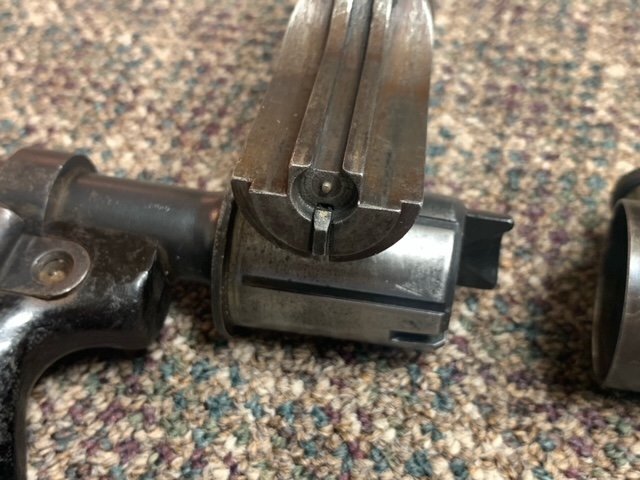

APEXgunparts Posted January 15, 2025 Report Share Posted January 15, 2025 Here is a picture of my OWEN bolt face, for a crude visual reference. Hope it helps. Do you have a STEN bolt to reference it against? I had something similar with the PPs-43, and it turned out to be the "firing pin" in the bolt face. Fortunately in the case of the PPs-43 it is replaceable. Richard Link to comment Share on other sites More sharing options...
maxfaxdude Posted January 17, 2025 Author Report Share Posted January 17, 2025 Richard, I will check the bolt face on my Owen. This does help! Thank you! John Link to comment Share on other sites More sharing options...

APEXgunparts Posted January 25, 2025 Report Share Posted January 25, 2025 On 1/16/2025 at 11:34 PM, maxfaxdude said: Richard, I will check the bolt face on my Owen. This does help! Thank you! John I wish I had a protrusion height on the "firing pin". I suspect it will approximate that of the STEN gun. Plenty of STEN bolts around! Richard Link to comment Share on other sites More sharing options...

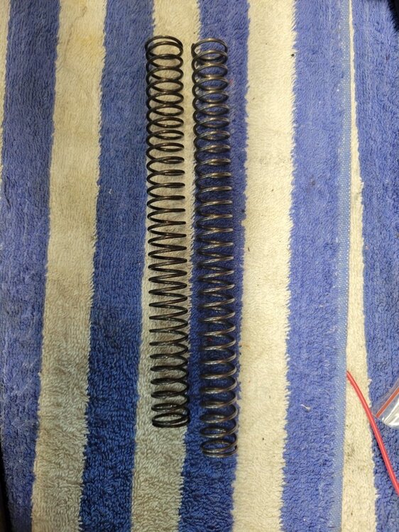

maxfaxdude Posted January 26, 2025 Author Report Share Posted January 26, 2025 (edited) 6 hours ago, johnsonlmg41 said: I'm going to guess it may be more of a tube issue than the spring or FP protrusion, but that's my pure speculation. Sometimes the barrel is too far out as well? Having intimate knowledge on these(even though I forgot most of it) there are some critical tolerances that might not be to spec on a tube gun? Sometimes you have a gun that works for a while, but is on the edge of the tolerances and due to dirt or wear, it slips just over to the "marginally" function side. A piece of debris lodged in front of the charging handle collar would keep the bolt handle from riding fully forward into the divider, thus limiting bolt travel. Loose set pin on the barrel or egged barrel hole would allow the barrel to move slightly forward leaving a light strike. Even pushing forward on the front grip could be an issue? Fixed firing pins are pretty easy to fix using a couple different methods. johnsonlmg41 has been kind enough to send me a repro mainspring from Warwick's in Australia. A big THANK YOU to Jeff! Compared with the old mainspring, the new mainspring is at least 1 inch longer and has a larger wire diameter than the old spring and measured 8 lbs versus about 6.5 lbs force on my gunsmith's spring scale. He has yet to test fire the gun but said the bolt now comes forward against the breech with a lot more force. And johnson, you may be right, the way the barrel fits into the receiver is a little wonky... We shall see... The picture below shows the old mainspring on the left next to the new repro mainspring on the right. Edited January 26, 2025 by maxfaxdude Link to comment Share on other sites More sharing options...
APEXgunparts Posted January 27, 2025 Report Share Posted January 27, 2025 If that new spring fits and works, please count the coils, measure the wire diameter, outer diameter and inner diameter and document this on a post here. It will be interesting to discover if this is a spring that can be procured commercially. Richard Link to comment Share on other sites More sharing options...
maxfaxdude Posted January 30, 2025 Author Report Share Posted January 30, 2025 On 1/27/2025 at 1:02 AM, APEXgunparts said: If that new spring fits and works, please count the coils, measure the wire diameter, outer diameter and inner diameter and document this on a post here. It will be interesting to discover if this is a spring that can be procured commercially. Richard Richard, Will do! Link to comment Share on other sites More sharing options...
