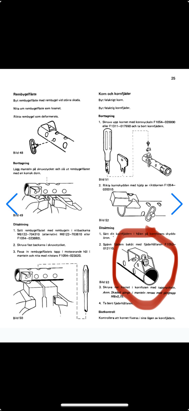

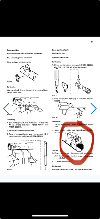

Rekraps Posted January 21, 2025 Report Share Posted January 21, 2025 So, if you're as dumb as me, then at one time or another you attempted to replace a broken front sight adjustment spring and figured the best way was to install the front sight post, then push the spring in until it fit in the slots. Well, maybe if you have three hands and lots of patience, but today I figured it out. Duh. Remove the front sight post using a K front sight post removal tool, (two pronged, on GB), installing the spring is now super easy. Then taking the front post with the tool inserted into the adjustment holes, put the threaded in just inside the hole and apply pressure toward the front of the shroud until the sight is perpendicular to the shroud, 1/2 turn and you are in business. And to think I went through three or four springs doing it wrong. Link to comment Share on other sites More sharing options...
Labanaktis Posted January 22, 2025 Report Share Posted January 22, 2025 Link to comment Share on other sites More sharing options...
NE Patriot Posted January 23, 2025 Report Share Posted January 23, 2025 Rekraps, Thanks for that. Good tip, that one doesn't think about until it's pointed out. Laban, And thanks for the photo. Link to comment Share on other sites More sharing options...
