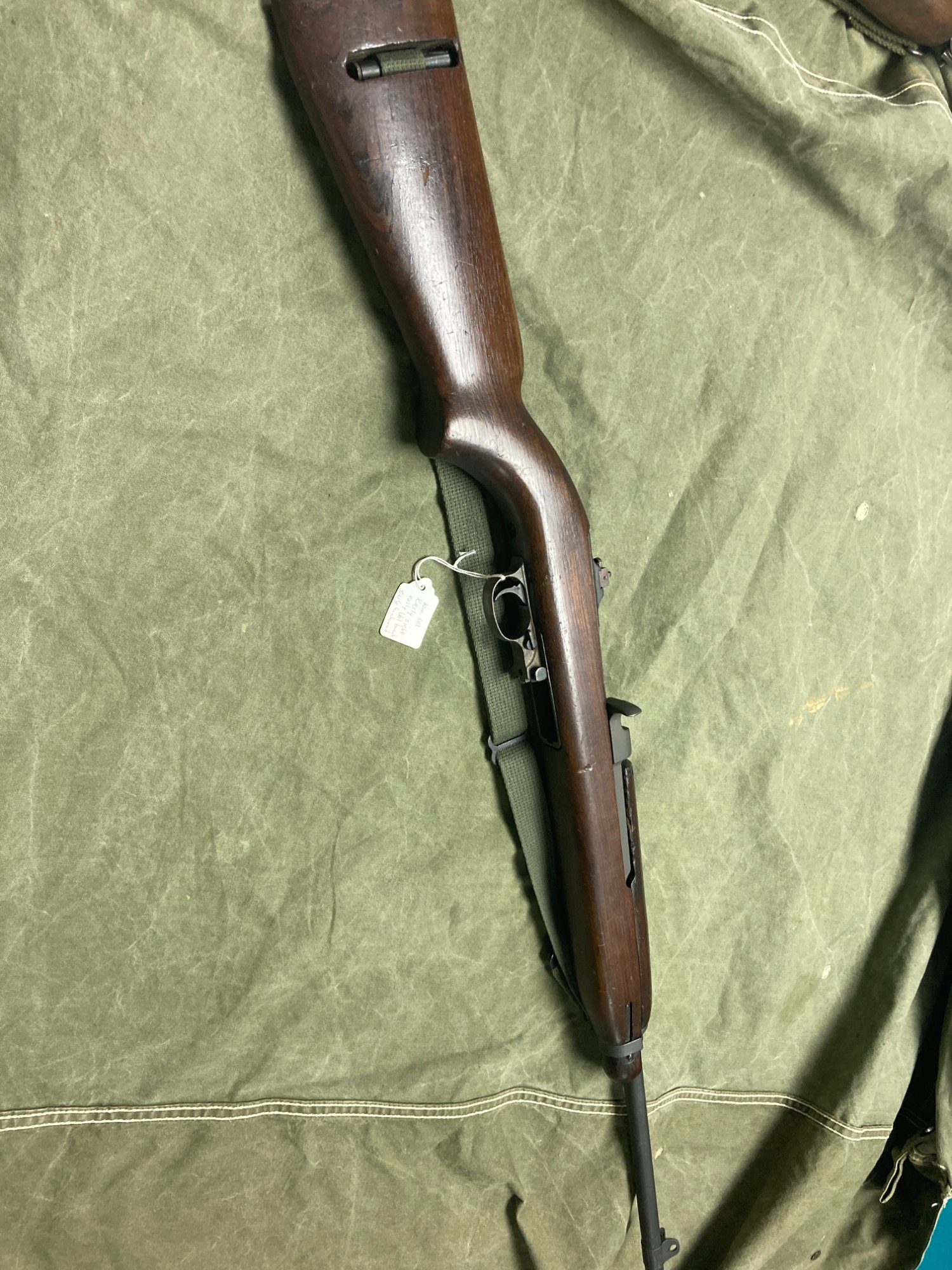

BillinBama Posted February 1, 2025 Author Report Share Posted February 1, 2025 Here are two I have on my tablet, I'll get one of the side of the receiver with the Fed Ordnance marking. Link to comment Share on other sites More sharing options...
BillinBama Posted February 1, 2025 Author Report Share Posted February 1, 2025 It reads "Federal Ordnance Inc. SEM CA" and above it "before using read warning" Link to comment Share on other sites More sharing options...
jim c 351 Posted February 2, 2025 Report Share Posted February 2, 2025 Its a RockOla receiver with the rear sight installed backwards. Fed Ord was either the importer or the remanufacturer of the RockOla receiver. The deep pitting makes me worry that welding was involved. Jim C 1 Link to comment Share on other sites More sharing options...

68coupe Posted February 2, 2025 Report Share Posted February 2, 2025 It doesn't take much to turn that flip sight around, even without a carbine-specific rear sight pusher. The problem lies in zeroing the rear sight. A bit of trial-and-error would be involved, regardless of method used, be it laser bore sighting or live ammo. Just my humble opinion, Karl, 68coupe Link to comment Share on other sites More sharing options...
BillinBama Posted February 3, 2025 Author Report Share Posted February 3, 2025 The sight is an easy fix for me, thanks for the advice. Sighting in by shooting is part of the fun! (I do have a laser bore sight tool I can use to get it close though). I'm glad to know it is a real Rockola and not a knockoff. Don't know about the pitting, though. Link to comment Share on other sites More sharing options...
NFA amnesty Posted February 4, 2025 Report Share Posted February 4, 2025 (edited) It looks like it was re-welded to me from the pictures. Look at the end of "warnin" and then look up to the top of the receiver....looks welded to me. Hence the warning on the receiver. Edited February 4, 2025 by NFA amnesty Link to comment Share on other sites More sharing options...
