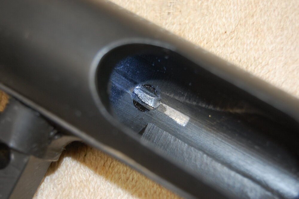

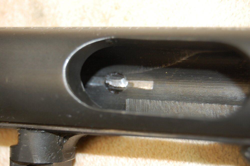

Butch Posted February 2, 2025 Report Share Posted February 2, 2025 I have just begun adding Machine Guns to my collection. My first 2 were M50's. Unfortunetly the first one failed after about less than 40 rds. The ejector shiered off. I have the broken piece and have secured the replacement. It is a very nice Reising and I would like to locate soneone with experience. I joind this Fourm so I could ask for help. Thank You all, Butch Link to comment Share on other sites More sharing options...

StrangeRanger Posted February 16, 2025 Report Share Posted February 16, 2025 You keep conflating extractor and ejector. They are very different items and require different solutions/capabilities. The broken ejector needs to be pressed out and the replacement pressed in. Alignment is critical and some minor tooling fabrication would be necessary or at least helpful to the process https://www.ar15.com/forums/armory/_ARCHIVED_THREAD____Anyone_familiar_with_the_Reising_mod__50_ejector_/2-285798/ https://www.machinegunboards.com/forums/index.php?/topic/11991-broken-ejector/ Link to comment Share on other sites More sharing options...
Butch Posted February 23, 2025 Author Report Share Posted February 23, 2025 On 2/16/2025 at 12:42 PM, StrangeRanger said: You keep conflating extractor and ejector. They are very different items and require different solutions/capabilities. The broken ejector needs to be pressed out and the replacement pressed in. Alignment is critical and some minor tooling fabrication would be necessary or at least helpful to the process https://www.ar15.com/forums/armory/_ARCHIVED_THREAD____Anyone_familiar_with_the_Reising_mod__50_ejector_/2-285798/ https://www.machinegunboards.com/forums/index.php?/topic/11991-broken-ejector/ Yes mine is the ejector. Shown in the pictures Link to comment Share on other sites More sharing options...
