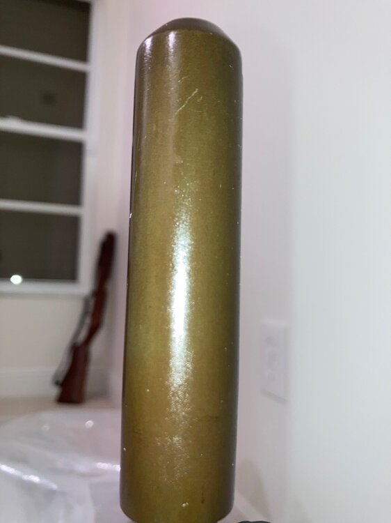

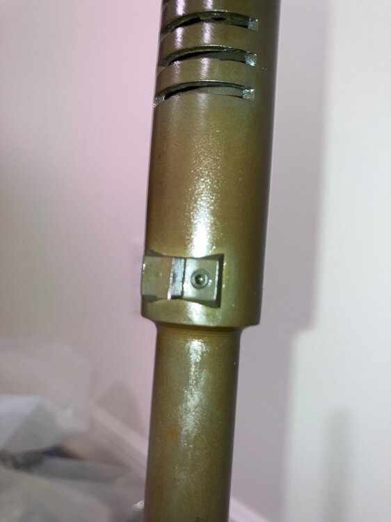

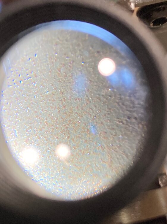

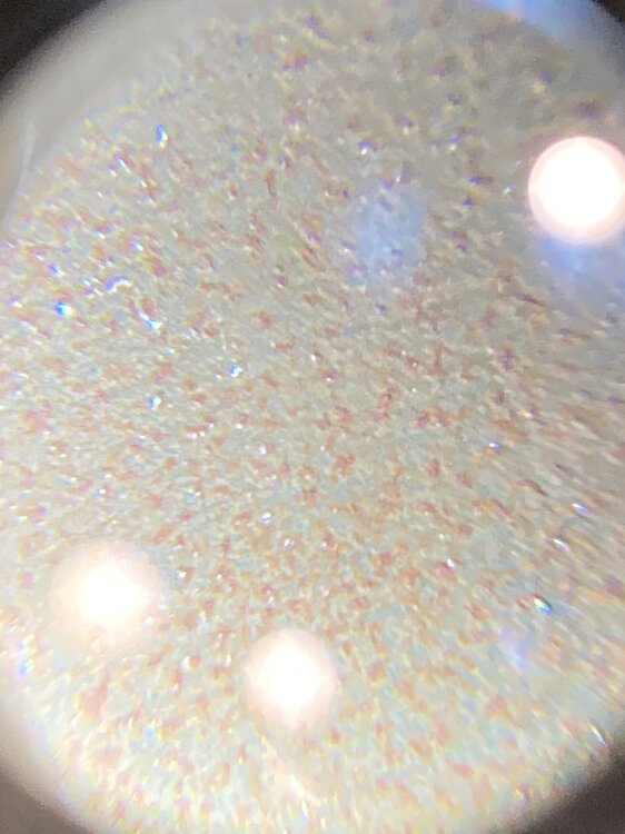

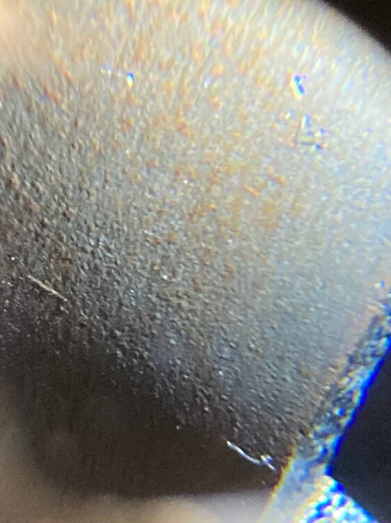

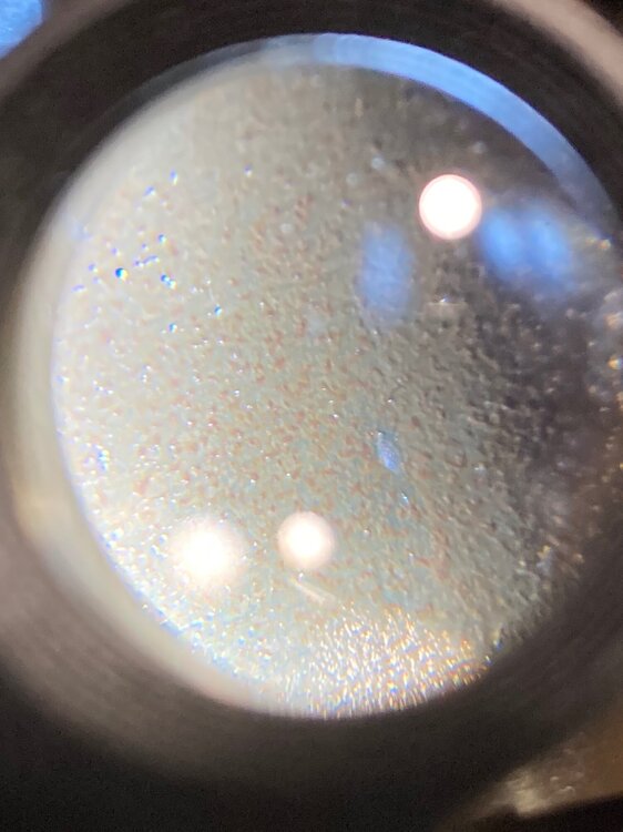

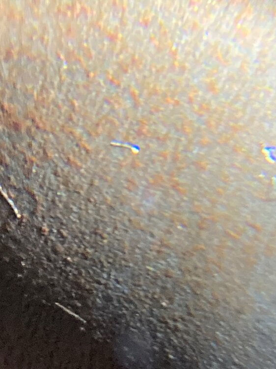

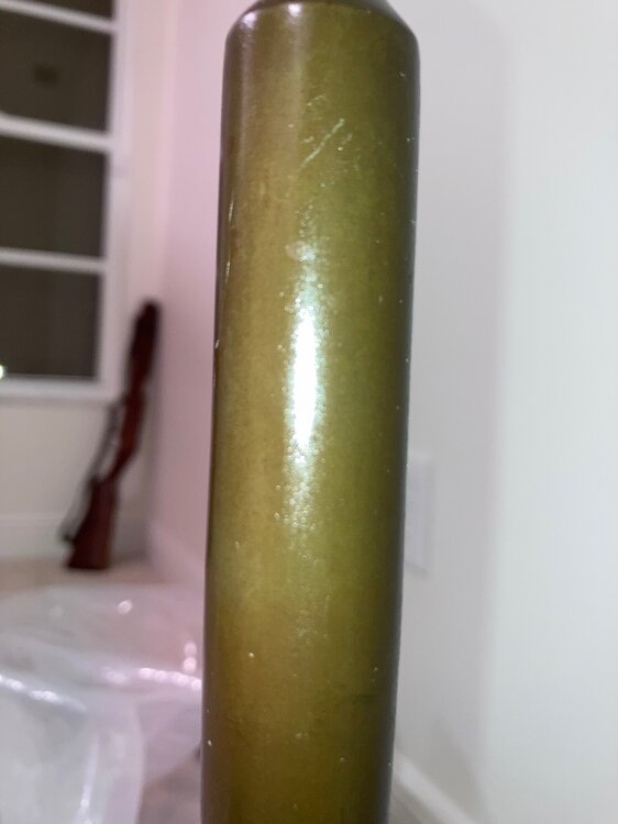

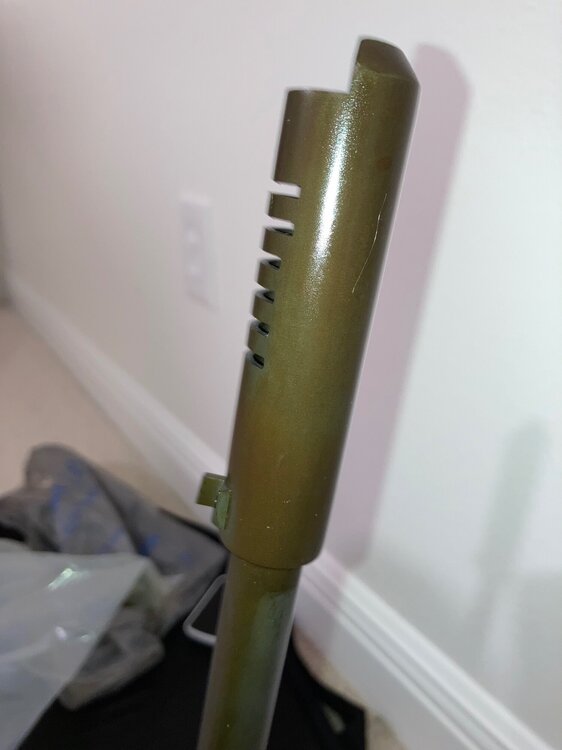

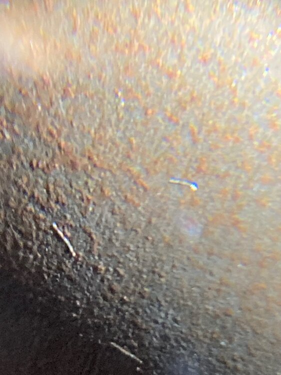

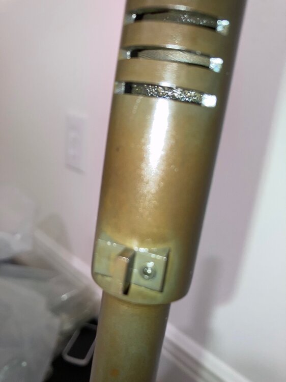

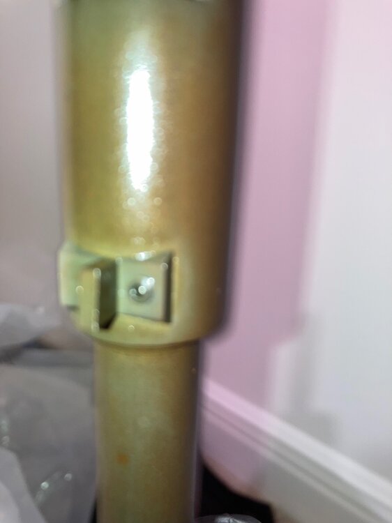

Good evening gents, I had a very nice original finish M50 Reising that about a year ago I put in a silica infused gun sock before leaving Florida for a month.
Unfortunately the gunsock absorbed all the oil I left on the gun during that month, and when I came back, it had some established rust.
(I’ve since switched to VCI backs and knocking on wood have had good luck so far).
Anyways in the meanwhile the damage was done, and as I understand it once rust has appeared with a parkerized finish, it really should be stripped and reapplied.
As such does anyone have any recommendations on who to send a Reising to for it to be stripped, and reparked in a historically correct way?
I called the CMP a few months ago, but they said they can’t accept MG’s for work.
With regards-Mathew
