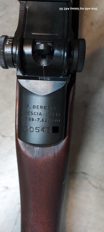

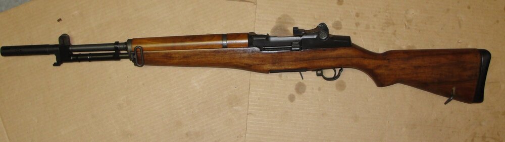

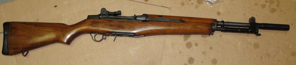

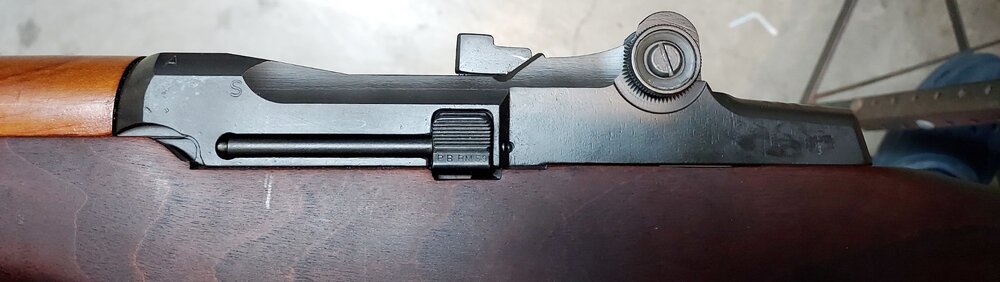

tal35 Posted March 10, 2025 Report Share Posted March 10, 2025 I got this from a friend and I dont see any springfield markings on it. Can anyone tell me more about it? It is a pretty nice BM59 , not sure if there is any particular sub model of it? Here are some pics Link to comment Share on other sites More sharing options...

Eli Posted March 11 Report Share Posted March 11 On 3/9/2025 at 8:47 PM, tal35 said: I got this from a friend and I dont see any springfield markings on it. Can anyone tell me more about it? It is a pretty nice BM59 , not sure if there is any particular sub model of it? Here are some pics That appears to be - but might not be - an extremely rare 1960s import 'Mark 1' BM59. I'd love to have one! That is, by far, the most valuable BM59 variant that isn't select-fire. Some were imported as semi-automatic sales samples in the 1960s, I've heard 6 but there's no proof of any particular number. On 3/10/2025 at 2:40 PM, Frenchkat said: Copied this from a post on Battle Tested forum: Gad to see my old write-up is still making the rounds! Eli Link to comment Share on other sites More sharing options...
