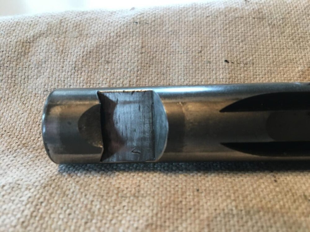

GUNGUY45 Posted March 28, 2025 Report Share Posted March 28, 2025 Ryo, I believe Frank is talking about the type of failure as shown in the following photos; Link to comment Share on other sites More sharing options...
Frank I. Posted March 28, 2025 Author Report Share Posted March 28, 2025 Both of mine sheared completely off like this one. All the springs in my M50 are Wolff, which seem to increase the cyclic rate of fire. The Wolff action bar spring is longer and has a fair amount more tension than an original MAYBE that is a contributing factor? NOTE: Both were original H&R factory Reising bolts, including the one pictured below 1 Link to comment Share on other sites More sharing options...
StrangeRanger Posted March 28, 2025 Report Share Posted March 28, 2025 (edited) The Wolff action bar spring isn't the best part of their kit. I ended up taking mine out. If you think about how the action bar works, it never loads that area of the bolt. That lug is pushed from the front only when you manually charge the gun, hardly enough to do any damage. However it is impacted from the rear every time the hammer strikes the back of the bolt. Because the rear of the bolt is tilted up when it's in battery the impact is borne almost completely by the area that fails. This is basically a fatigue failure that occurs after tens or more likely hundreds of thousands of impacts and the sharp corner has set up a stress concentration. The small radius we added (I was also involved with Jason on the project) reduces that stress concentration. Instead of 80 years, the new bolts should last a couple of centuries. Everything breaks eventually The hammer spring massively increased reliability in my gun; I was getting too many light strikes with the H&R spring. I was reluctant to install the Wolff after I realized what was causing the failures but I really had little choice Edited March 28, 2025 by StrangeRanger grammar 1 Link to comment Share on other sites More sharing options...

Frank I. Posted April 2, 2025 Author Report Share Posted April 2, 2025 I don't think the firing pin would be a contributing factor. The first bolt broke with an OEM pin, the second one with a modified-inertia titanium pin. Link to comment Share on other sites More sharing options...
