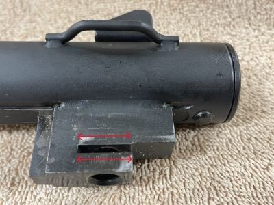

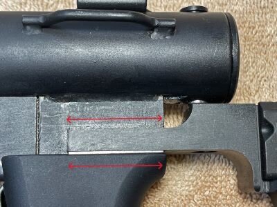

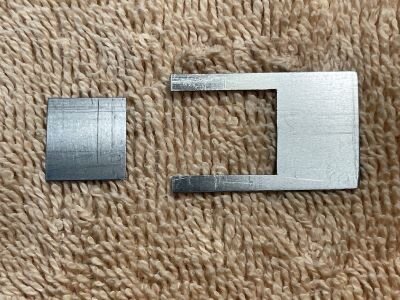

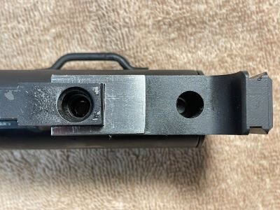

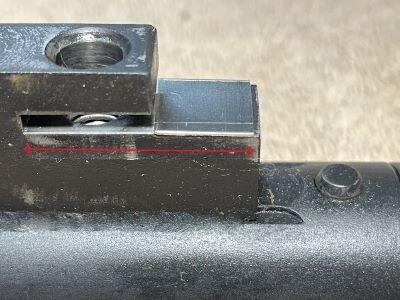

Jim in Texas Posted April 3, 2025 Report Share Posted April 3, 2025 I have been experimenting with one of Brian’s picatinny stock adapters on a MK760 and thought I would start sharing the results of my experiments with the group. Let’s start with some basics. I am not an engineer or a professional gunsmith. Additionally, there are a lot of variations in the world of 76/760s. These ideas may need to be modified, or they may not work at all with your particular firearm. One thing I observed early on is that the stock adapter has only relatively short, cantilevered support in the vertical axis. I decided to try to lengthen the support areas with a couple of shims. One shim goes between the top of the stock adapter and the bottom of the grip block. The second shim goes between the bottom of the stock adapter and the top of the grip. I think this will give some added support to the stock adapter without requiring any modification to the firearm itself. Thoughts? Suggestions? Link to comment Share on other sites More sharing options...

Jim in Texas Posted April 7, 2025 Author Report Share Posted April 7, 2025 Like you, I had to file the two pads to get a good fit between the stock adapter and the grip mount. I made these shims because I was concerned about: (1) the relatively short engagement between the stock adapter and the grip mount; and (2) relying solely on that short, cantilevered fit to keep the stock rigidly attached for years to come. The red double-ended arrows in the first photo show just how short that engagement surface is. By adding additional support behind that cantilevered interface, I hope to keep the stock stable for the long term. The red arrow in the third photo show how much longer the top engagement surface becomes with just the addition of the small square shim. The red arrows in the last photo show how much longer both the top and bottom engagement surfaces become when both shims are used. Does this help to clear up the confusion or have I managed to muddy the waters even more? Jim Link to comment Share on other sites More sharing options...
