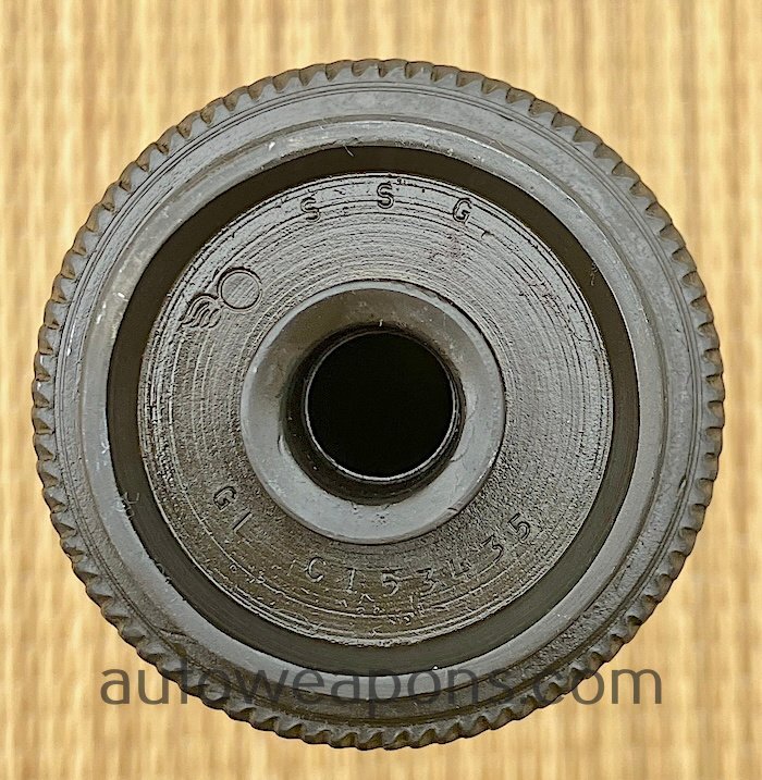

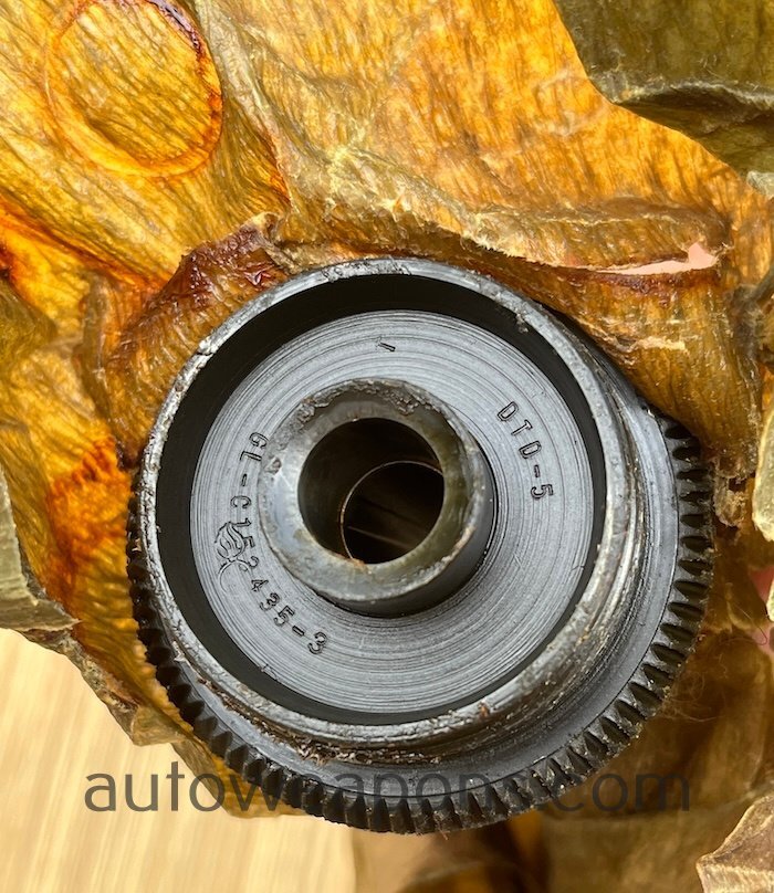

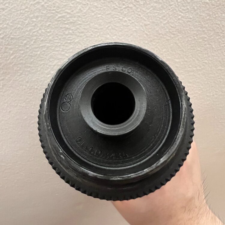

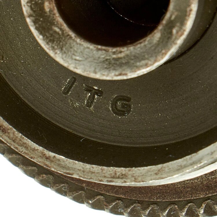

nmsang501 Posted April 10, 2025 Report Share Posted April 10, 2025 Just bought my M3, and I've been searching for an extra barrel (To turn it into a suppressed barrel) when I noticed they seem to have different manufacturer marks. Here are some that I've collected while searching online. I was wondering if there is a source which lists down all the barrel manufacturers that can be identified. Mine says F.S.Co, and I'd like to find out which manufacturer that stands for. I'd also like to know if there are known manufacturers that are rarer than others. Thank you! So far, the only ones I can identify are SSG - Saginaw Steering Gear DTD - Guide Lamp ITG - Ithaca Gun Company Link to comment Share on other sites More sharing options...
Frank I. Posted April 12, 2025 Report Share Posted April 12, 2025 FS was Fostoria Screw Co. Fostoria, Ohio made FS marked barrel collars. DTD was the Detroit Transmission Division, the Hydra-Matic Division made M16A1 rifles during the Vietnam War . Listed in the Guide Lamp's 1944 subcontractors list. There were a diverse number of postwar manufacturers of M3A1 parts. Some have CAGE codes. I'm not sure when CAGE codes became a requirement, but it was fairly recent? In another thread here, I listed an M3A1 bolt with a cage code 16447 which is/was Milo Components Inc. Freeport, NY. They also made 1911A1 pistol parts for the government. I once had a chrome-lined Vietnam-era barrel, the collar was made by Marlin 1 Link to comment Share on other sites More sharing options...
