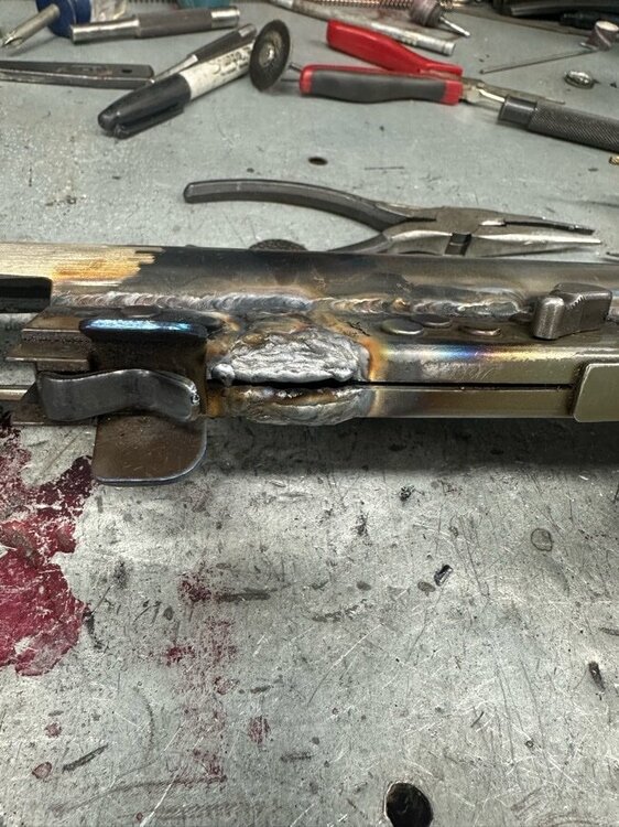

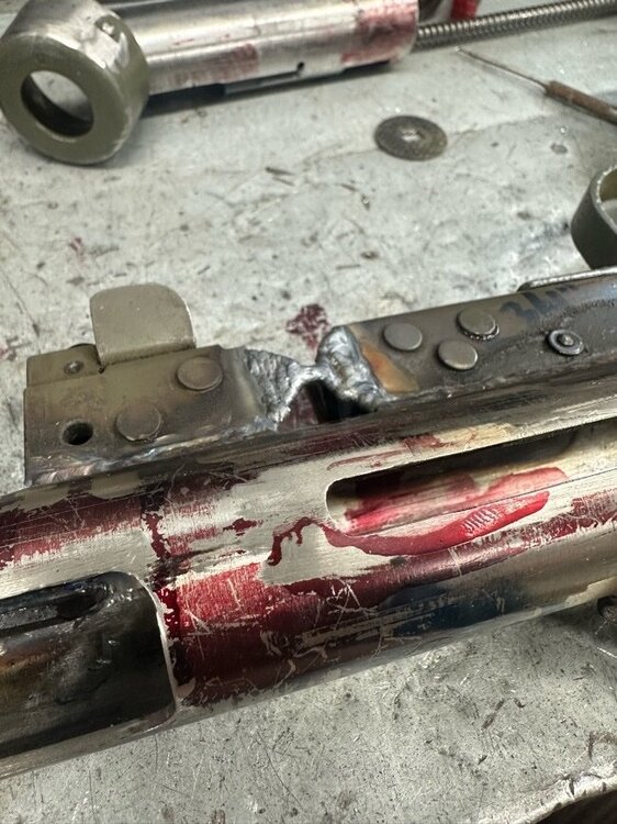

Got Uzi Posted May 1, 2025 Author Report Share Posted May 1, 2025 (edited) Funny you ask about this today….I have been tinkering with the K project this week off an on when I get overwhelmed finding homes for stuff…took it out and test fired it today-shot well but was having trigger reset issues…came back to the shop and found the disconnector notch was dragging on the sear when trying to reset. Took off .030ish the tip of the hook and made the hook deeper by said .030ish. I also reprofiled the side and radius of the disconnect hook as well. It works perfectly on the bench now so I’ll test fire it again in the morning. This process I discovered that the receiver drawings I have are for a Full Auto spec tube and I was making a semi auto tube (more on this later) and with this I discovered that the Indy Ord bolt handle is in a different location (rotation angle wise) from that of the original K handle. I had to machine a plug, press it into the bolt body, then machine an offset hole into the plug (and into the body) followed up by machining a custom bolt handle to put it all together with. Now as long as the test fire goes well tomorrow morning, I plan to come back, mask, blast and paint it “Swedish K Green” This build is NOT for the faint of heart of for those who are not mechanically skilled or understanding of gunsmithing. Not trying to sound superior or talk down to anyone, just giving fair warning. I can honestly say that at this point I have 35-40 hours in this gun over all and selling on the open market for $5,000-$6,000 is where they would be. Edited March 18 by Got Uzi 1 Link to comment Share on other sites More sharing options...
USMCsean Posted May 2, 2025 Report Share Posted May 2, 2025 Glorious update!!! I am definitely curious to hear more. I have seen and heard that the Indianapolis Ordnance kit places the handle at a slightly different angle. They do that as a denial bar to keep a FA bolt in an SA tube. Ergo, their handles match their SA tubes. I am curious why you chose to fill the large gaps with weld instead of filler pieces. Also, do you plan to machine the weld where the tube meets the sides? I’d like to hear more about the trigger setup. Link to comment Share on other sites More sharing options...
Got Uzi Posted May 2, 2025 Author Report Share Posted May 2, 2025 The tube ID is also smaller so a standard K bolt won’t fit inside either. The semi auto bolt body is roughly .100 smaller than the standard K bolt. Thats the major denial block. The angle is somewhat of a “wtf” moment when you can’t get a tune from them and using specs you dug up from different sources. I’m working on a new set of prints for the semi tube and a new process sheet for order for the operations. I welded the gap instead of using a filler piece only because I wanted to play with my welder and test settings since I’m in my new shop. The amperage settings indeed are different now that I’m in town vs being in the country. I ground the weld seam to blend it in where the lower section meets the tube. I’m going to look at it again today to see if I like the results of that. 1 Link to comment Share on other sites More sharing options...
