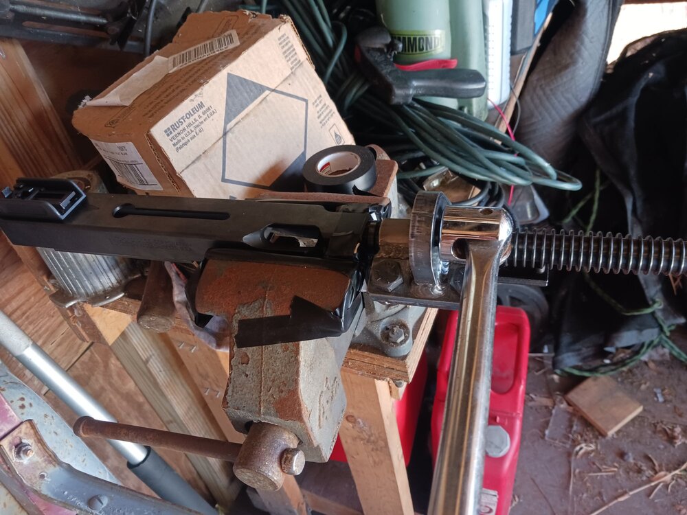

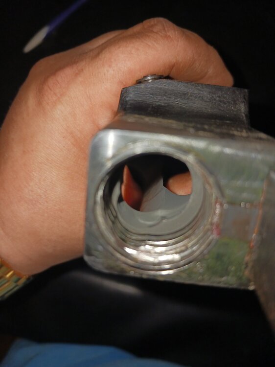

Gold1927a1 Posted April 20, 2025 Report Share Posted April 20, 2025 (edited) I need serious help here... When installing the barrel into my kahr the barrel doesn't want to spin in straight.. the threads are screwed.. I'll admit that when spinning on the first thread or two the barrel didn't have enough grip and with the leverage and heavy tools it just ripped the barrel straight out the receiver... Is there a tap I can use to correct this? I'm already a ton of money in on this, gun is on a form 1 and bought Conner's removal tool (which broke the heavily red loctite barrel loose with ease leaving no marks). Edited April 20, 2025 by Gold1927a1 Link to comment Share on other sites More sharing options...
Gold1927a1 Posted April 20, 2025 Author Report Share Posted April 20, 2025 Link to comment Share on other sites More sharing options...
deerslayer Posted April 20, 2025 Report Share Posted April 20, 2025 Receiver threads can be undersize to some barrels fit. If there is still receiver threads left, I would clean out the bad stuff, make the barrel threads major and minor a little undersize and screw it back in. Link to comment Share on other sites More sharing options...
Gold1927a1 Posted April 20, 2025 Author Report Share Posted April 20, 2025 1 minute ago, deerslayer said: Receiver threads can be undersize to some barrels fit. If there is still receiver threads left, I would clean out the bad stuff, make the barrel threads major and minor a little undersize and screw it back in. clarification please. What tool would this require? Or take to machine shop? Or just send to you? Link to comment Share on other sites More sharing options...
deerslayer Posted April 20, 2025 Report Share Posted April 20, 2025 Remaining threads in barrel look good for what I described above. There isn't the pressure in this barrel like in a bolt action Hi power rifle. You will be fine. Link to comment Share on other sites More sharing options...
Gold1927a1 Posted April 20, 2025 Author Report Share Posted April 20, 2025 Comparing old and new barrel threads they seem to be identical. I'm wondering if since the threads are so thick toward the end and there seem to be plenty left inside the receiver if I can just continue on and the larger threads will correct the barrel as it is tightened? Never to be removed ever again.. Link to comment Share on other sites More sharing options...
deerslayer Posted April 20, 2025 Report Share Posted April 20, 2025 Email me danblockstocks@gmail.com Link to comment Share on other sites More sharing options...
deerslayer Posted April 20, 2025 Report Share Posted April 20, 2025 Or call 641-390-0878 Link to comment Share on other sites More sharing options...
Gold1927a1 Posted June 10, 2025 Author Report Share Posted June 10, 2025 Well I sent the gun off to Dan and he fixed the issue. He also reamed the chamber to smg spec and the stock shortened by an inch. Thanks again, Dan! 2 Link to comment Share on other sites More sharing options...

Bridgeport28A1 Posted June 11, 2025 Report Share Posted June 11, 2025 On 4/20/2025 at 3:59 PM, Gold1927a1 said: What was the grey goop at the end of the receiver threads? Link to comment Share on other sites More sharing options...

Bridgeport28A1 Posted June 18, 2025 Report Share Posted June 18, 2025 On 4/20/2025 at 3:59 PM, Gold1927a1 said: Deerslayer, what was the gray looking goop inside the receiver nose visible in the third photograph? Link to comment Share on other sites More sharing options...
deerslayer Posted June 24, 2025 Report Share Posted June 24, 2025 I don't know what it was. Powder residue? Link to comment Share on other sites More sharing options...
Countryboy77 Posted June 27, 2025 Report Share Posted June 27, 2025 (edited) On 6/11/2025 at 2:18 PM, Bridgeport28A1 said: What was the grey goop at the end of the receiver threads? Hell with the grey residue, Kahr doesn Broach the area where the Extractor rides!? Looks ike they just dremel clearance.Jeez. Edited June 27, 2025 by Countryboy77 Link to comment Share on other sites More sharing options...

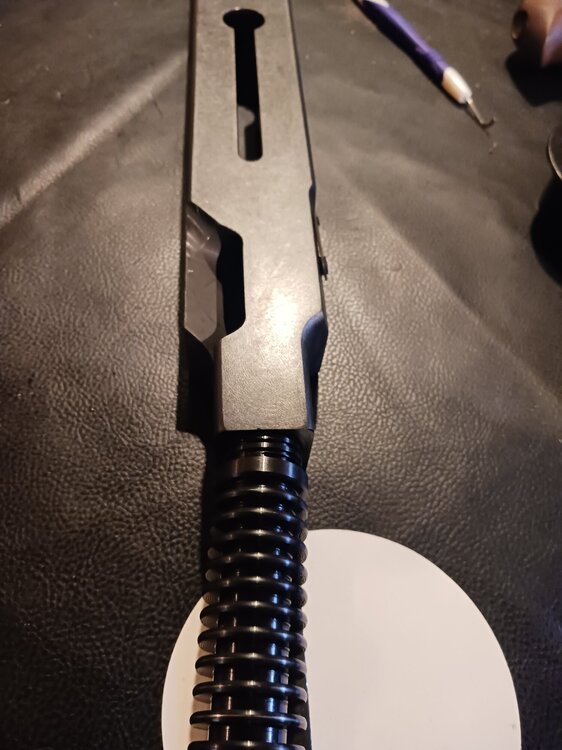

deerslayer Posted June 29, 2025 Report Share Posted June 29, 2025 They use a rotory tool instead of a broach. For a while they made a very undersize cut the required extractors with the corners ground off. The cut is bigger now. But their extractors are now poorly made and fitted. 1 Link to comment Share on other sites More sharing options...
Gold1927a1 Posted July 4, 2025 Author Report Share Posted July 4, 2025 On 6/18/2025 at 3:39 PM, Bridgeport28A1 said: what was the gray looking goop Just powder residue. Didn't clean the gun. Link to comment Share on other sites More sharing options...
